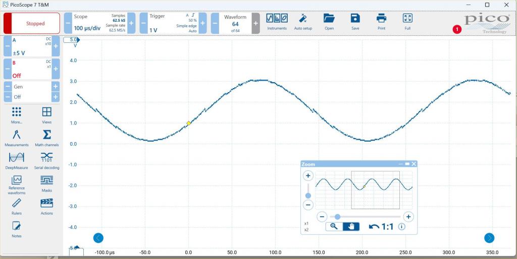

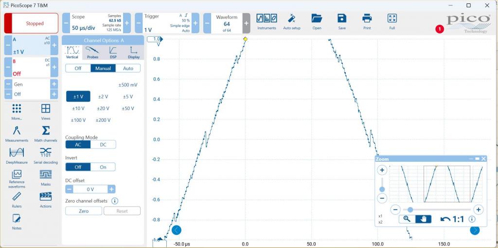

Posts: 12078
Posted: 03:11pm 30 Jun 2023
Something not quite right with the waveform.
Edited 2023-07-01 01:14 by matherp
Posts: 6200
Posted: 04:09pm 30 Jun 2023
Checkt the values of the ladder resistors, looks like the msb is few percent off, or, the pin impedance creates a fault.
I used a 2k/1k ladder and do not see this.
Posts: 9252
Posted: 04:19pm 30 Jun 2023
It looks rather like bit0 and/or bit1 is strange. How does it look at a low frequency?
Posts: 12078
Posted: 04:45pm 30 Jun 2023
I'm using some 120R, 240R 1% resistors left over from CMM2 so I think Volhout is right that it is an pin drive/impedance issue
Posts: 9252
Posted: 05:21pm 30 Jun 2023
Yep. A higher resistance will swamp it. I'm intending to use R=1K8 2R=3K6 followed by an op-amp non-inverting input. Purely because I happen to have some 0805 0.1% in that value. :)  If I can still manage to solder 0805, of course. I've not done any for a while. Or I might just order some 1K / 2K 0.25W from China. They would be a lot easier to handle ...
Posts: 12078
Posted: 05:26pm 30 Jun 2023
RS has 1k 2k leaded in 0.1% at sensible price (GBP 0.42 each).
I have improved the waveform by increasing the pin drive when a pin is set to PIO. Will put the change in the next beta.
Posts: 6200
Posted: 05:37pm 30 Jun 2023
That is why most DACs are current driven, not voltage.
I see barely any roll-off attenuation) with 1k/2k at 1MHz. So that ahould be fine. I am not sure about the LM358 buffer though. It is not really helping I think. It can only drive few mA. You might be able to get 600 ohm output impedance, but the 1k/2k ladder is 1k.
Ironically the ADC problem in the pico, is exactly this, but then with capacitors in the ADC on chip. That is why Analog Devices, TI, Microchip exist. Not easy to make a good adc on microcontroller silicon.
Edited 2023-07-01 03:42 by Volhout
