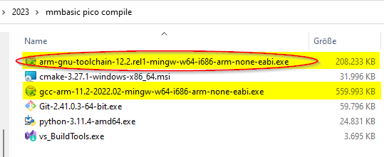

I need help once again!
Is this really the right compiler version? Only 208MB compared to the old version with 560MB?
Posted: 10:02pm 02 Aug 2023
They're probably container files (ZIP etc) and if so it's worth looking into each to see what is missing/extra.

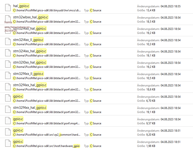

NB: This should be built against pico-sdk version 1.5 with gpio.c replaced with the attached.
help requested, which file of these in the pico-sdk needs to be replaced?
