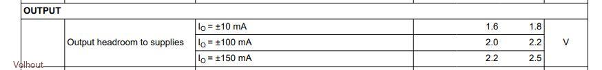

  matherp said  If you can stand the price then a buf634a is a way to go
Naahhhh ? Not really. This is a high power opamp, but needs preferable +/- 15V
Below +/- 2.25V it does not work
So single 5V may work...
But then it cannot drive rail to rail...
The LM4871 is nice ! Huge power for 5V and 8 ohm. Will blow you socks off...

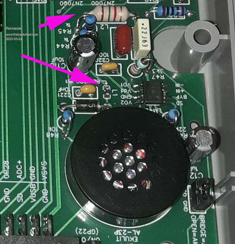

The LM4871 is a great little Amplifier, I am using it with my own picoMiteVGA design a while with some filtering (ferrite bead) and onboard speaker with absolutley no audible noise while being REALLY loud.
I've drawn a schematic today from my own design which I am going to use with an samsung vacuum fluorecence display.
The holes on the frontpanel for the sepaker on the right are suprisingly sufficent. Due to the fact that the speaker is so small the highs are very dominant, therefore my little filter (see schematic L2 & C222) is not only surpressing noise but tames the highs of this speaker at the same time.
My audio jack is switched, so if I plug a cable into it, the internal speaker is disconnected.

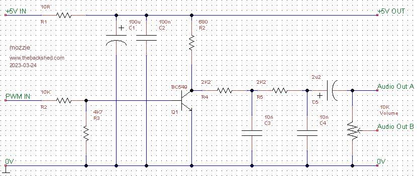

As mentioned on this thread and elsewhere, hiss breaking through from the audio output of the PicoMite to the amplifier appears to be a common problem when using the PFM/PWM power supply built into the Pico.
You can hear the heartbeat LED changing the tone of the hiss, other loads do the same.
PWM mode is better but still very noisy.
This is less of a problem using an external linear reg and this might be one way to solve it.
After some tinkering / investigation, it appears this is wideband noise coming through on top of the PWM audio signal and is very difficult to remove, even with the suggested audio filtering components in place as shown in the manual and versions on the BSF.
The circuit below uses the BC549 transistor to isolate the PWM signal (and noise) from the Pico and references it to the filtered 3v3/5v supply, with the audio filter following to remove the carrier signal. The other styles of filters would work just as well.
I have tested this with a small analog amplifier and at full volume the hiss is just audible with an ear pressed to the speaker. It will drive the 3w amplifier I have to the point of clipping (quite loud). This is with only the decoupling components as shown in the circuit, Class D amps may require more.
Obviously a push pull buffer in transistor or chip form would be better but this was aimed at minimal components to drive a small speaker. I'm sure other members here will be able to optimise the circuit, it was built with bits and pieces I had on hand.

[EDIT] Would I need the BC549 specifically, I have BC547.
Edited 2023-03-24 21:37 by thwill
Posts: 3418
Posted: 11:53am 24 Mar 2023
"Would I need the BC549 specifically, I have BC547."
Yes a BC547 is ok, almost any NPN would work there.
The BC549 is a low noise type but that only applies to linear mode. In that circuit it is being used as a switch to clip the top off the PWM signal, as that is where much of the noise will be coming from and replace it with a cleaner 5V.
You could omit R3 (4k7) and it would work just the same.
Edited 2023-03-24 22:00 by phil99

Posts: 6200
Posted: 12:46pm 24 Mar 2023
  Mixtel90 said  That switching reg is *very* noisy. A linear reg helps a lot.
With suggested circuit by Mozzie that is not important. The 5V should be noise free.
Note that the circuit with a BC549 to convert the 3.3V PWM signal to a 5V PWM signal, and feed that through a low pass filter (2.2k/10n 2x.).
It is not a very good filter (-3dB at 2.7kHz, -30dB @ 44kHz), but it is a filter.
P.S. there is a minor problem with Mozzie's circuit, in that the BC549 is not a very fast switcher when driven from 10k. Especially when the PWM reaches 0% or 100% (the audio sine wave is at minimum or maximum) there will be distortion. A 5V powered logic gate would be better in this application.
