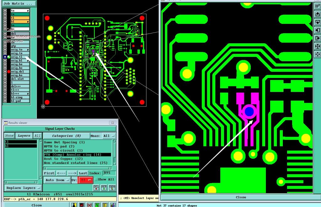

EDIT: I finally managed to open the .eprj file and checked that tey are indeed connected (VCC).
Original:
I tried and got this back:
Did I something wrong or are these meant to be connected?

Posts: 9251
Posted: 12:14pm 30 May 2023
All three are connected on the VCC net. They are on my copy of EasyEDA anyway. :)
Pins 48 & 49 are connected on the schematic.

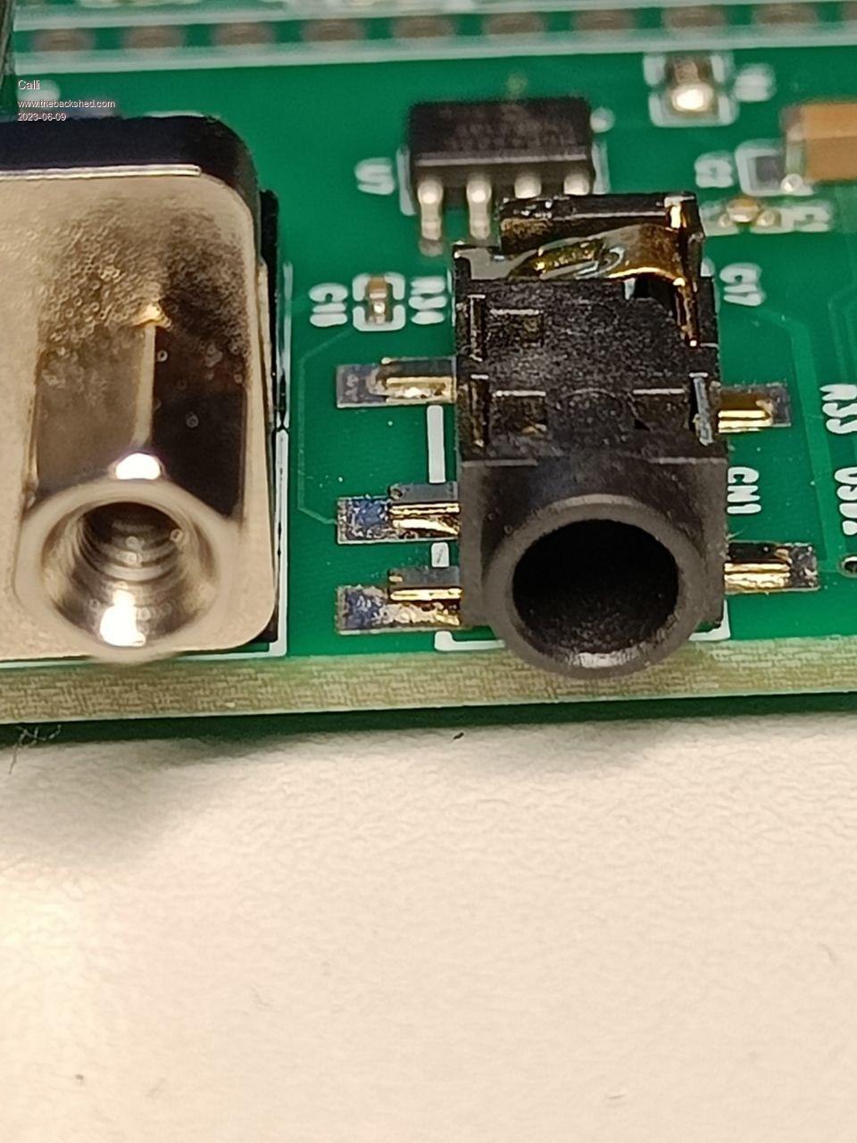

The boards arrived today. I could test 3 out of 5 for now and all work.
The audio jack is however on all boards with raised legs soldered, I mean the small amount of solder paste couldn't connect the leg with the pad. Sometimes two and sometimes three legs, resulting in mono or no sound. Reflowed it with an iron and some flux and it works. Will mention JLBPCB about it.

Posted: 02:31pm 08 Jun 2023
I don't know if that's the usual audio jack, but the one used since the CMM2 has had two little locating pegs on the bottom to fit through holes in the PCB. I wonder if the jack was aligned properly or if the holes were too small? Either would cause the jack to be too high.

Posted: 03:16pm 08 Jun 2023
The jack used on my boards is complete SMT, I see no alignment pegs (EDIT: used a torch, there are pegs (very small ones) and they are all in the holes, not the cause). The placement is fine (maybe on some a bit rotated) and all legs hit the pads in sufficient manner, it is just that they are bent a bit up and there is not enough solder.
I will try to get better images. But I think you can see that the solder does not connect.
EDIT2: Maybe if the pads could be a bit smaller, so the body of the jack could settle better on the PCB, maybe it just floated a bit in the solder(paste)?
Maybe one can get different jacks and this is a worth a note for somebody who can't solder.

Posted: 03:31pm 08 Jun 2023
Interesting...
Easy enough to reflow but you wouldn't expect them to come out like that. I suppose it might be tolerances on the jack or the lugs on it aren't fully clean so the flux & solder isn't flowing properly - especially if they are using lead-free or the flux is some sort of no-clean one and isn't aggressive enough.
