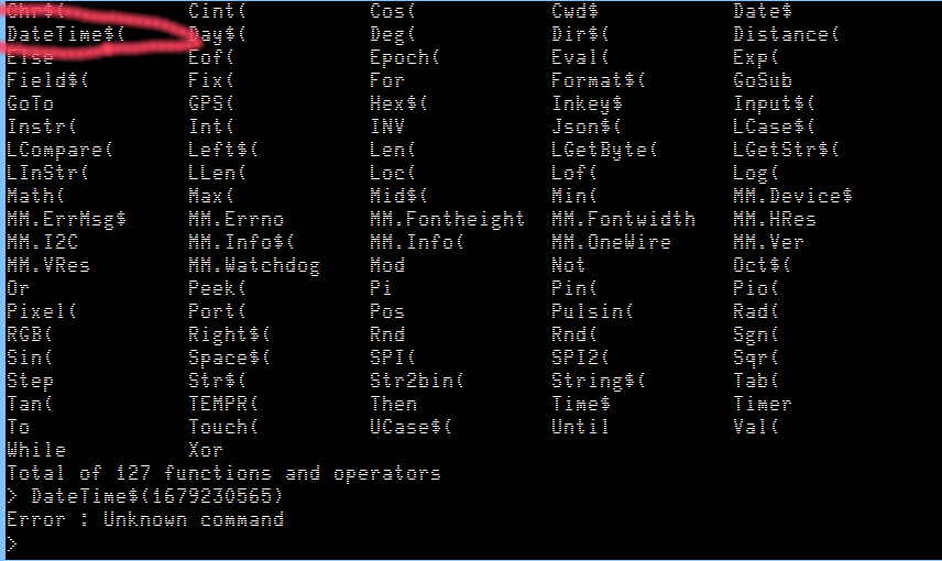

I may have missed some details somewhere,  but on FRESH install of PicoMiteWebV5.07.07a24.uf2, if the only thing I setup so far is the WIFI so I'm connected...
If I type:
> datetime$(1679228317)
Error : Unknown command
Above is what I get.
Did Adding TFTP and NTP support remove working with EPOCH time to set TIME$ and DATE$?

  Quote  If I type:
Which section of the manual is datetime$ in? Functions?

yes,  but oh geez... I was trying to shortcut and do stuff in immediate mode... not a program. Maybe that can be it?

DateTime$() is a function not a command.
Do:
? DateTime$(...)
Posted: 01:07pm 19 Mar 2023
It is a function not a command
I think you are miss-remembering
rtc settime datetime$(now)
Note though that on the WEB version data$ and time$ are automatically set by WEB NTP
Edited 2023-03-19 23:08 by matherp
