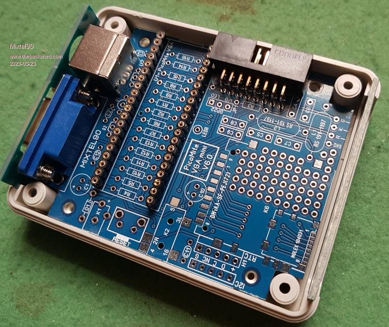

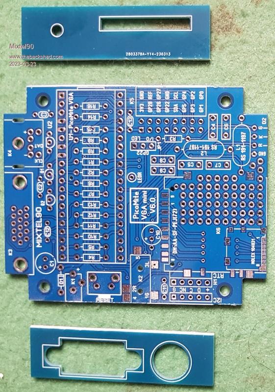

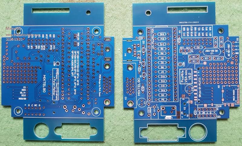

And so, the slow boat from China pulls into dock. I now have some PCBs. :)

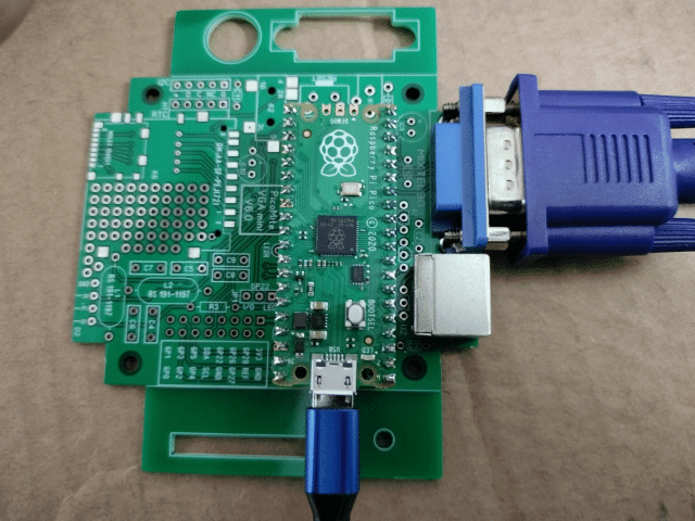

All the holes seem to line up. I've tried a Pico in it and I *think* it's just about low enough now to be able to cut a slot for the USB plug. This is using turned pin connetors instead of the usual headers.
I've not got a standard SD socket to try it with. If the slot is a bit out it will just have to be filed down a bit. :) The board is just a tiny bit tight in the box. I'll probably take 0.5mm or so off just to ease things. The cut line isn't usually absolutely bang on when you use the score & nap in the vise system. It's pretty good though.
Incidentally, I too had JLPCB contact me about "the hole". I tried to explain that they should keep the hole but get rid of the adjacent pad if it was too close. Eventually she decided that it would be ok as long as the hole wasn't PTH. Anyway, it's come with both the hole and the pad, with the hole non-PTH and it seems to be ideal. They are very good indeed!

I've found a couple of errors so far. Neither too serious.
One end of C13 isn't accessible - it's underneath the box header. It can go underneath though, it's only a decoupler and could possibly be omitted. I'd forgotten it was a box header when I put C13 there as an afterthought.
The two-way link for GP22 has holes that are too small for a male pin header. I've made this mistake before and didn't learn from that! Some female header and a simple solid core wire link is fine. It's not as if it's something that will be changed much, I don't think.
The outer edge of the box header *does* project over the edge of the PCB but it won't stop the PCB from going into the case as a slot has to be cut for it anyway or it can't be used. :)
EDIT:
This particular uSD card socket isn't good in this particular position in this box. The inserted card doesn't project far enough for it to be pulled out unless you have long nails to catch into the little ridge on top. It *is* usable with that proviso. Mind you, I only included the uSD card so that I could practice soldering them as you can always use a uSD adaptor with the standard SD card socket. Unfortunately I've not got a standard socket so the prototype will have uSD. Well, one of them will anyway. :)
Edited 2023-03-24 02:07 by Mixtel90

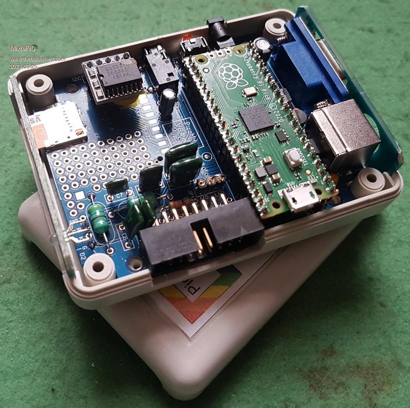

I've found my boxes! A lot more PCB construction has taken place. A few more slight gotchas:
C2 is too tight for a 1uF polybox cap. As I've nothing closer I'm using 100nF as it's relatively close to C1 anyway and I'm not after ideal noise performance from the regulator.
C3 won't fit either - it's too close to the PS2 socket. However, the regulator spec says a minimum of 1uF and the reg is feeding into VSYS - which isn't far away and has 47uF on-board. Once again I've put in 100nF to help with the high frequency mush.
ANOTHER EDIT:
I now have a more-or-less working prototype. SD card and RTC aren't working. The former I can understand as I've probably got bad SMD soldering. The latter I'm not sure about - needs more investigation.
All the case holes have worked out rather well, including one for the USB connector. Reset is a little "insert pointy object" hole.
Maybe more pics later.
YET ANOTHER EDIT:
Bad RTC was a dead module. Some reflow work fixed the uSD card socket. Sound is noisy (as expected) but it's working ok.
 I've done the mod that uses the front panel red LED as heartbeat  and it's ok. The on-board green still lights, but only just. The front panel green LED works properly when controlled by GP22. Audio will drive 32R headphones up to "too loud for me" levels.
I'm going to update the PCB to version 1.2, taking the above points into consideration. Most of this is done now. I'll update the construction pack soon, as I feel i should clear up some things in the manual too. I'm happy with it, and the current PCB can be used perfectly well if you already have some on order.
Edited 2023-03-25 07:07 by Mixtel90

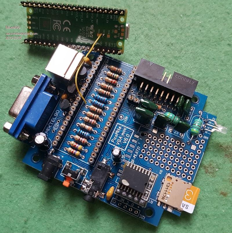

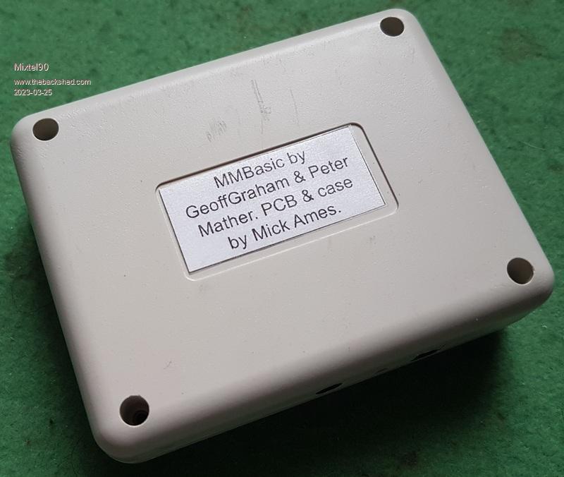

Ta Da!
There are one or two "deliberate" mistakes, of course, but operationally it's good, even if the casework leaves a little to be desired! :)
I'm just going to start updating the manual.

the yellow wire goes from ? to ?
Posts: 9253
Posted: 07:29am 27 Mar 2023
From TP5 on the Pico to LEDR on the PCB. It puts the red LED on the PCB in parallel with the green LED on the Pico. The red LED has a lower Vf than the green one so the green one is starved of voltage and virtually goes out, while the red one lights instead. It brings the "heartbeat" to a red LED on the front. Obviously, you can switch "heartbeat" off and control it via GP25.

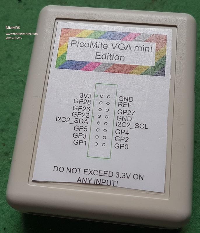

I'm going to include the stickers as a PDF with the manual. :)

Pretty drawing for labels. :)
