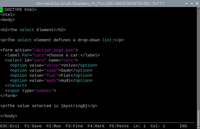

Hi All;
This is probably a trivial thing for most, but when I want to make a quick change to the HTML page I am testing, I bring it into the editor and then save it out to the sdcard.
Example;
The /action_page.bas is WIP (don't ask).
Thought I would just mention this,
Hans ...

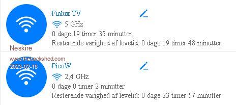

Posted: 10:11pm 17 Feb 2023
Test PicoMiteWebV5.07.07a18.uf2
Clean_flash and start from scratch.
Terminal Teraterm
> OPTION TCP SERVER PORT 80,4500
> OPTION WIFI "yy", "xx"
Connecting to WiFi...
Connected 192.168.8.105
Starting server at 192.168.8.105 on port 80
Connected to router
> load "server.bas"
> files
A:/
  <DIR>  .
  <DIR>  ..
00:00 01-01-2000          4  bootcount
00:00 01-01-2000       1152  favicon.ico
00:00 01-01-2000       1024  server.bas
00:00 01-01-2000       3712  small.jpg
00:01 01-01-2000        896  test4.html
2 directories, 5 files
> option list
PicoMite MMBasic Version 5.07.07a18
OPTION WIFI yy, **************************
OPTION TCP SERVER PORT 80, 4500
> run
ntp address 162.159.200.1
got ntp response: 17/02/2023 20:57:51
_________________________________________________
String is       GET / HTTP
sending page
String is       GET /small.jpg HTTP
sending picture
sending page
sending picture
After a few minutes no response in Firefox/Crome
Disconnected from router
Ctrl C
> run
ntp address 162.159.200.123
got ntp response: 17/02/2023 21:13:49
Not connected to router
No response to Firefox/crome
Ctrl C
> ? mm.info(ip address)
192.168.8.105
> run
ntp address 194.58.207.20
got ntp response: 17/02/2023 21:16:11
No response in Firefox/Crome
Power off, power on
PicoMiteWeb MMBasic Version 5.07.07a18
Copyright 2011-2023 Geoff Graham
Copyright 2016-2023 Peter Mather
> run
got ntp response: 17/02/2023 21:16:49
sending page
sending picture
Working again for a few minuts, then the same history again.
Testet V5.07.07a17 and V5.07.07a16, same behavior.
Erik
Edited 2023-02-18 08:16 by Neskire

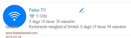

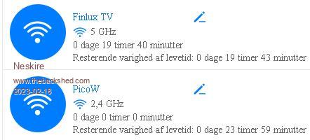

Posted: 11:42pm 17 Feb 2023
@matherp
I am running your 2023-02-07_040659_simpleweb.zip on PicoW using PicoMiteWebV5.07.07a18.uf2 as firmware. It works exellent and fast, but after some minutes idle (no request from browser ca.2 - 20 minuts) it no longer respond to a request from the browser. In the router PicoW has disappeared from the device list. After a powerreset the PicoW is working as server flawless again. In the router PicoW is again in the device list. It seems to me as some kind of timeout when in idle.
Browser problem ? using Firefox/Crome
Best regards
Erik
Edited 2023-02-18 10:11 by Neskire

Posts: 12082
Posted: 08:33am 18 Feb 2023
  Quote  In the router PicoW has disappeared from the device list.
Anyone else see this? I'm not aware of any timeouts in the wifi code but there may be.
