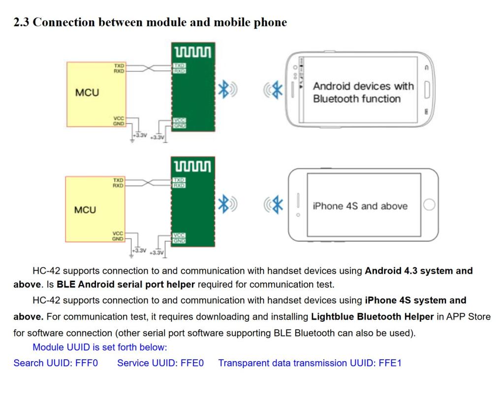

And if someone used the HC-42 BLE5.0 module (very similar to HC-12 but bleutooth
you could have any or all these controllers working
Posts: 9253
Posted: 04:13pm 02 Apr 2023
Interesting module. I've not spotted how you would work with one master and multiple slaves though. If that could be done it might be ideal as it runs in COM mode. You don't need bluetooth support in MMBasic then.

lew247
Joined: 23/12/2015
Posts: 1709
Posted: 07:25pm 02 Apr 2023
  Mixtel90 said  Interesting module. I've not spotted how you would work with one master and multiple slaves though. If that could be done it might be ideal as it runs in COM mode. You don't need bluetooth support in MMBasic then.
I don't know if it will work with multiple slaves
but I have the Datasheet
Extract from it
HC-42 english datasheet.pdf
Edited 2023-04-03 05:27 by lew247
Posts: 9253
Posted: 07:46pm 02 Apr 2023
It may as well be in Chinese for me. I know nothing of Bluetooth, I just have some stuff that uses it. :)
Unless it has multiple slaves there's no point. You *can* include the device address in the protocol, but you are going to have to scan every controller in each time period (could be during frame flyback, but there's a lot of other stuff has to be done then too). Having a protocol that includes device addresses is more data to send, even if there are no ACK signals or error handling.
