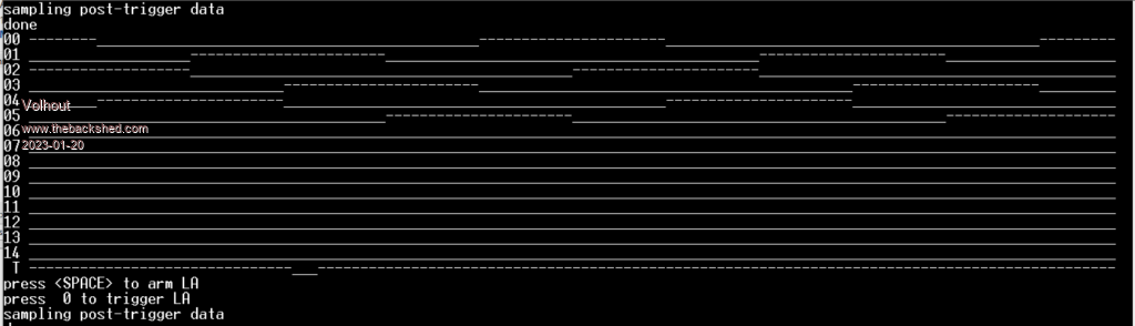

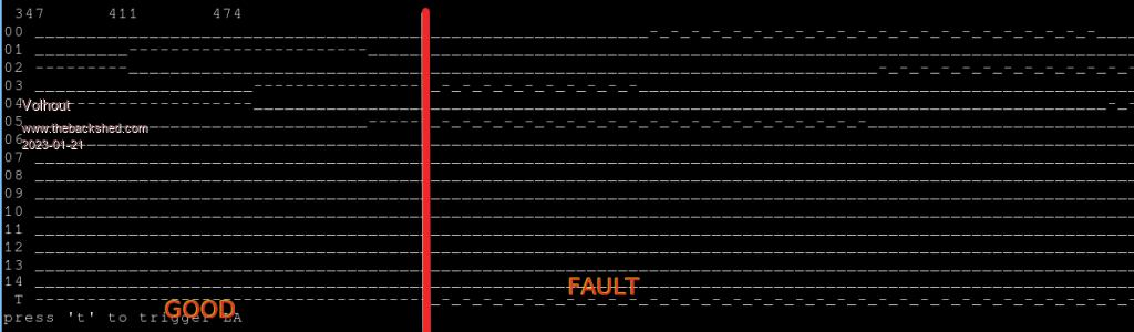

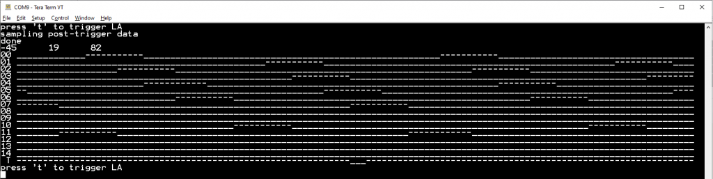

'logic analyzer framework research program
'samples GP0...GP15 with triggering on GP22 on standard picomite
'uses PIO and ring buffer under DMA.
'requires Picomite MMBasic V50707b6 or newer.
'Volhout  20-1-2023
' Test signal: Three phase motor drive - picomite V50706+
' runs autonomously on GP0...GP5 50Hz
SetPin gp0,pwm  'CH 0a
SetPin gp1,pwm  'CH 0b
SetPin gp2,pwm  'CH 1a
SetPin gp3,pwm  'CH 1b
SetPin gp4,pwm  'CH 2a
SetPin gp5,pwm  'CH 2b
PWM 0, 50, 33.33, -66.66, 1, 1
PWM 1, 50, 33.33, -66.66, 1, 1
PWM 2, 50, 33.33, -66.66, 1, 1
PWM sync 0, 100/3, 200/3
Pause 20
'----------------------------------- LA code PIO --------------------------
'PIO code to sample GP0..GP15 for logic analyzer
PIO clear 1
'in this program the PIO reads GP0..GP5 brute force
'and pushes data into FIFO. The clock speed determines the
'sampling rate. There are 3 instructions per cycle
'taking 10000/3 / 50 = 66 samples per cycle.
'the PIO program
'address    code    mnemonics         comment
'.wrap target
'  0        80A0    pull block        'pull data from FIFO into OSR when available
'  1        A027    mov(x,osr)        'load gate time (in clock pulses) from osr
'  2        4010    IN pins 16        'read 16 pins
'  3        8000    PUSH noblock      'and push to FIFO
'  4        00C2    JMP (GP22) 2      'while no trigger (GP22=1) loop to 2
'  5        4010    IN pins 16        'read 16 pins
'  6        8000    PUSH noblock      'and push to FIFO
'  7        0045    JMP (X<>0) 5 X--  'while X<>0 decrement X and jump to 5
'.wrap
'program pio1
PIO program line 1,0,&h80A0
PIO program line 1,1,&hA027
PIO program line 1,2,&h4010
PIO program line 1,3,&h8000
PIO program line 1,4,&h00C2
PIO program line 1,5,&h4010
PIO program line 1,6,&h8000
PIO program line 1,7,&h0045
'configuration
f=1e4                             'PIO run at 10kHz
p=Pio(pinctrl 0,0,0,gp0,,,)       'IN base = GP0
e=Pio(execctrl gp22,0,7)          'wrap 7 to 0, gp22 is conditional JMP pin
s=Pio(shiftctrl 0,0,0,0,0,0)      'shift in through LSB, out is not used
'write the configuration, running 10kHz
PIO init machine 1,0,f,p,e,s,0     'start address = 0
'---------------------------- LA code MMBasic ----------------------------------
'prepare trigger signal set to idle (above PIO code needs falling edge trigger)
SetPin gp22,dout
Pin(gp22)=1
'do not start PIO, the DMA will do that.
'reserve data buffers
'The logic analyzer captures 2*length% (32 bit max) samples.
'These are stored in array "data%()" using 2*length% integers (64 bit variables)
'The DMA buffer has 64bit width, is packed with 32bit FIFO (2 per cell) = length%
'The size of the ring buffer is specified in bytes, so size is 8*length%
length%=256
Dim data%(2*length%-1)            'array to put the 32 bit samples (in option base 0)
'Dim packed%(length%-1)           'DMA array to pack 32 bit samples in 64 bit integers
Dim packed%                       'name of the array to be formed as circular array
PIO MAKE RING BUFFER packed%,8*length%         'this creates array called "packed%()"
'dim display characters
Dim a$(1)=("_","-")
'---------------------------------------- MAIN -----------------------------------------
 Print "press <SPACE> to arm LA"
 Do : Loop Until Inkey$=" "
 'The DMA should take 2*length samples (= loopback value)
 'It should never trigger the ReadyInt interrupt (ringbuffer) hence we make the number of
 'samples near infinite (&hFFFFFFFF). When we force stop the DMA then ReadyInt will trigger.
 'the number of samples.
 PIO DMA_IN 1,0,&h7FFFFFFF,packed%(),ReadyInt,32,2*length%   'start DMA with ring buffer
 'write to PIO the number of post trigger samples, this starts the logging of pre-trigger data
 PIO WRITE 1,0,1,length%
 Pause 200
 Print "press 't' to trigger LA"
 Do : Loop Until Inkey$="t"
 'the trigger pulse, must be wider that 3 / f(pio) in seconds.
 'for 10kHz, that is 0.3ms
 Pulse gp22,1      'pulse 1ms (1->0->1)
 'from here the PIO should autocomplete and wait for another post trigger length% written
 Print "sampling post-trigger data"
 'wait a bit (can calculate from post trigger length and sampling speed), default for now
 Pause 200
 'stop DMA, this will call ReadyInt that stops the PIO and re-init it.
 PIO DMA_IN OFF
 'process the data from the ring buffer
 Memory unpack packed%(),data%(),2*length%,32
 'calculate position of the trigger point in the ring buffer
 endpoint%=Pio(DMA RX POINTER)-Peek(VARADDR packed%())   'value in bytes
 endpoint%=endpoint% / 4                                 'convert to 32 bit values for use in data%()
 trigger%=(endpoint%-length%)                            'recalculate trigger from end capture

Hi Peter,
I hope you can help me. Attached ZIP has 2 programs. LA_4.bas and LA_5.bas.
The program LA_4.bas is the logic analyzer that works as I expect. If you type "t" repeated, it shows the sampled data from the 15 input ports of a picomite.
Using V50707b7
If you connect GP22 to GP15 you also see the trigger.
Then program LA_5.bas
This program shows corrupted data in the last 128 samples of the data%() array (alternating correct value, next sample 0). Only the last 128 samples.
If you change the value of "samples%" from 512 to 256, or 1024, the last 128 samples show this behaviour (the numerics show the start pointer, mid pointer, and stop pointer of the displayed values).
You may have to type "t" a few times. When start%<0 or stop%>samples%-128 it is visible,
commented out is a section that displays the data that is in the packed%() array. And also the packed%() array shows this artefact. The last 64 values seem corrupted.
And I have no idea what is going wrong. The PIO code is the same, the DMA configuration is the same. The levels of the signals on my breadboard are correct.
I have looked for hours, and cannot find what is going wrong. Have stripped LA_5.bas back to almost identical to LA_4.bas. I have no idea.
I hope you can spot what is going wrong.

Peter,
Thonking about the artefact in LA_5
Looks like from a certain location in the circular buffer the dma is writing fifo data(32-to-64), in stead of packing it(32+32-to-64).
Maybe the location where the buffer is in Ram is the cause.
Or the packed array and data array overlap, the memory unpack overwrites part of the packed array.
Edited 2023-01-21 17:52 by Volhout

Volhout,
the location where the problems start is &h81 .
