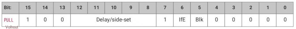

Now data is in the PIO domain, we process it further with PIO instructions. From the FIFO we read the value in the OSR register by the PIO PULL command.
DELAY/SIDE SET: we know this...
IFE: if empty, we will not discuss this here...
BLK: Blocking, this will stall the PIO when nothing in FIFO
Blocking: When there is not data in the FIFO the PIO will wait for data. This is exactly what we want. We tell PIO to generate a gate pulse when we want it to. Not go on an errand mission on it's own.
PULL block = 100 00000 10100000 = 1000 0000 1010 0000 = &h80A0

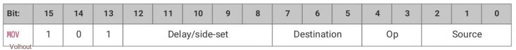

The only thing new is the MOV from OSR to X. Let's look at that in detail.
DELAY/SIDE SET: we will not use that now
DESTINATION: "001" = X ("010" = Y, "000" = pins)
OPERATION: "00" = none, "01" = invert
SOURCE: "111" = OSR ("001" = X, "010" = Y, "000" = pins)
For more details on the versatile MOV instruction, check chapter 3.4.8 of the RP2040 manual.
MOV OSR->X = 101 00000 001 00 111 = 1010 0000 0010 0111 = &hA027

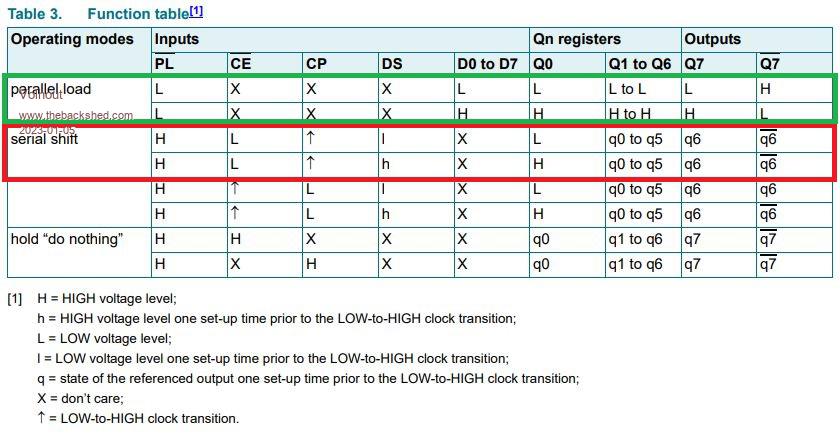

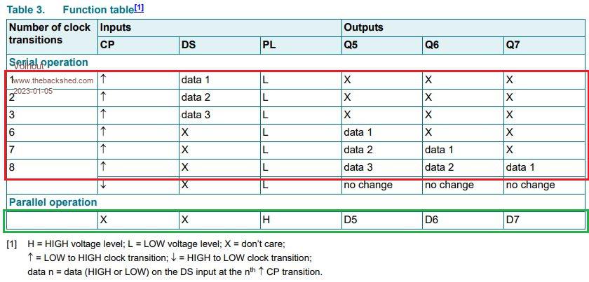

To be able to write the PIO program we need to know more about the chip we want to read, the HEF4021 (or CD4021).
For that we investigate the datasheet for the interface specification. Below is taken from the NXP datasheet.
The red box shows the signals that must be controlled for shifting data
- CP = Clock: the rising edge is shifting the next bit
- PL = Load: a high level loads the input pins levels into the shift register, must be low now
- Q7 = Serial Out: this is where the data is shifted out
- DS = serial input. Will not be used in this example, so we connect to ground
The green box shows how to load the 8 bit parallel data in the shift register.
- PL = Load , must be high to load data.

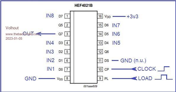

This analysis leads to the following connection diagram
Now there is a lot in the datasheet in timing, and we can go to the detail in this, but that distracts for the moment. Let's skip it.

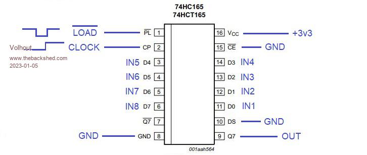

What if we would like to read a different shift register. This is the datasheet of the 74HC165. We go the same path.
this results in below connection diagram
The difference with the 4021 is that the load puls is going low for load. During shift it is high.
The first exercise is to adapt above program to support the 74HC165. If you happen to have a 74LS165, it must be powered from 5V. The clock and load inputs will accept 3.3V signals, but the serial output is 5V. A 1k/2.2k resitor divider will make a 3.3V signal for the picomite.
The second exercise is to adapt the HEF4021 program to use SIDE SET for clock and load signals. This shrinks the program size significantly, and doubles the speed. Hint: all SET commands except the first (set pindirs) will disappear.
