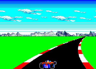

  Volhout said  Wauw !
This is really super smooth....
Good work. Running it on RC8 at 252MHz.
Thank you, with 252MHz I had something like 22.5 FPS
to have a better speed experience, you might play with the Value of the  spt Variable which controlls the speed of the colorchange
bcol%(dst,f%)=col%(7-3*((Sin((((120-f%)/40)^3)+dst*.75))>0)):Next :Next :dst=0:spt=1.5

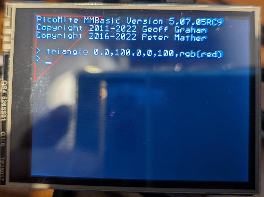

non vga mmb does not have a triangle function.
Posts: 11782
Posted: 06:57pm 07 Nov 2022
There from the very first versions
Posted: 10:36pm 07 Nov 2022
Thanks, I found it
TRIANGLE X1, Y1, X2, Y2,
X3, Y3 [, C [, FILL]]
not under drawing commands.
sorry.

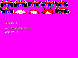

I have adapted the example to the new sprite routines so that the tires are no longer transparent.
Sprites used in the Demo
I also halved the vertical resolution of the road and reduced the frame rate to 25, so there is still about 1/3 CPU time left, which could be used to calculate the controls of the game.

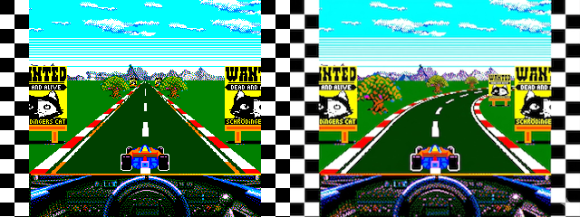

Posted: 08:14am 03 Apr 2026
As I described in another thread , performance was significantly improved by replacing the BOX commands with BLIT RESIZE
This should make it perfectly possible to show up road signs and objects at the side of the road without losing speed. I’ve drawn a little something to illustrate this.
I've already designed a few important RGB121 signs instead of traditional billboards
At the moment, I’m trying to figure out how to make signs that are closer move faster than those that are further away. Well, I’ve got time over the Easter holidays to find that out
Martin
Edited 2026-04-03 19:03 by Martin H.
