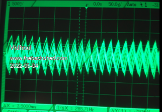

Just some pictures to paint the picture:
I copied a track from a CD onto SD card, Some guitar music from Harrry Sacksioni, a Dutch guitar player, accompanied by an orchestra. This shows dynamic and wider audio spectrum. Listening on a headset (did not dare my audio setup to this experiment).
1/ The PWM signal from the picomite
The PWM is clearly visible. If applied to a headset (470 ohm series), it actually sounds good. But you can clearly see that the 44kHz is dominant,Not good for a stereo amplifier.....

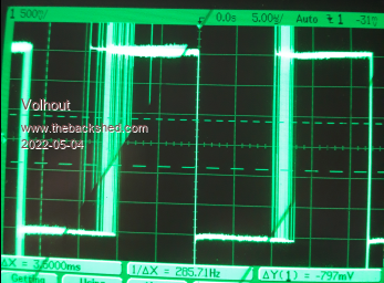

2/ The audio filtered by 470ohm and 47nf (actually 50nf).
Somewhere hidden in the trangular 44kHz waveforms is the hidden audio information. With this filter the 44kHz is still as large as the hidden audio.

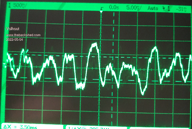

3/ The audio filter (with transistor) I designed gives a much better signal. The 44kHz is still visible (the waveform is thicker than a noisefree waveform) but you can clearly see this is audio (this is on a different timebase scale).
But there are all kinds of noise and rattle audible in the audio.
I have been able to lower the "random" rattle  by using.
OPTION POWER PWM ON
But there was still a repeating rattle that is caused by the pico and sd card.

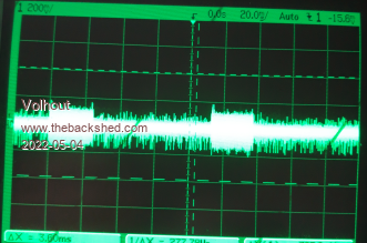

I am not sure if it is the current the SD card uses, or the current the pico uses to read the SD card, but it shows a a lot of noise (in bursts) on the 3V3 and actually also shows on the 5V (due to load variations ?).These bursts are not present when you play tone, or when you stop the wave play.
I have added filters in both 3V3 and 5V to cope with it, but all in all I am not really happy with the size of the circuit. Lots of components.
This is a difficult beast to tame. Maybe the MCP1700 (I will order a few) will improve, probably on 3V3, but the 5V may still be noisy. Maybe it is better to design the audio circuit around a dual opamp (active filter + low impedance out) powered from 5V. Most opamps have good rejection of the noise on the power rails. And soldering 2 transistors and 2 resistors is not much different from an 8 pin DIL socket. And it saves RC filter in the 5V (electrolitic cap.)

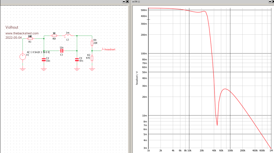

Posts: 6206
Posted: 07:14pm 03 May 2022
Hi Mick,
I have the cap at the SD card, but not the 2.2 ohm. Maybe that makes a difference.
I have looked into the LC filter, and I think I may have found something usable.
It is a low pass filter with a trap frequency at 44kHz.
from the pico pin you go with 180 ohm to the filter. Termination with 220ohm and 470 ohm. The 32 ohm headset goes parallel to the 470 ohm.. With high impedance, and headset the filter shape remains good.
The inductor is 1mH (the 10 ohm is it's internal resistance, it is an estimate, do not add a resistor, just the inductor part).
Tried smaller values but that does not work. Larger would be better, but harder to get I guess.
The 12nF capacitor is tuned to get the 44kHz centered. Both 1mH inductor and 12nF capacitor need to be fairly accurate for best performance (5%). The other capacitors do not matter much.
I do not have the components in my bin, and can only get to components next week.
Posts: 6206
Posted: 07:22pm 03 May 2022
Mick,
I will try the filter with 1.5mH inductor (not 1mH), and 8.2nF (not 12nF) since that gives the best overall performance. The other components stay the same.
Ordering components now....Also MCP1700's (if I can find them).
Actually I am quite excited about this. This may be the best simple solution overall.
Edited 2022-05-04 05:24 by Volhout

That's a rather nice curve. :)
I can get 10% axial ferrite inductors easily enough here. Not a bad size - 3mm dia x 6.5mm long right up to 1mH. Unfortunately they don't stock anything above 1mH, but I can put a couple in series.
Their 1mH axial has a resistance of 30R, if that helps, and 470uH is 13R.
I might get an assorted bag of these as I've not got any little inductors apart from the odd one.

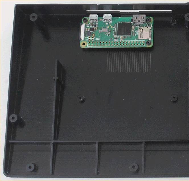

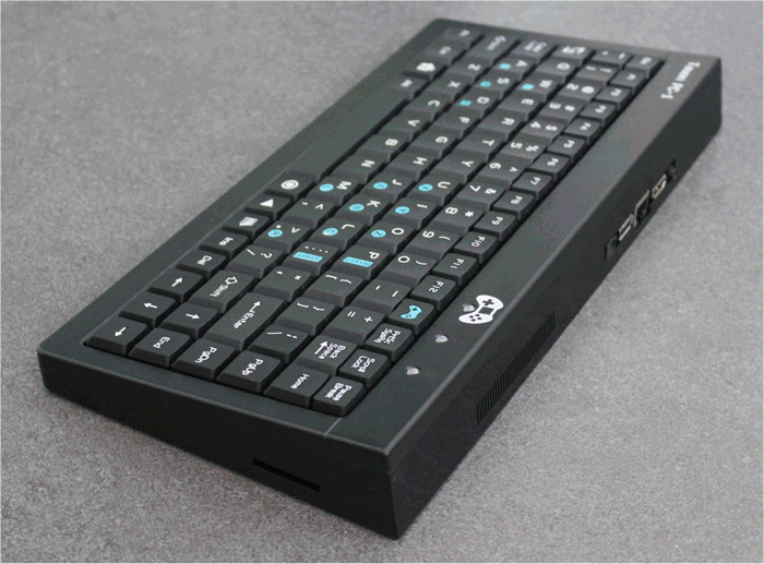

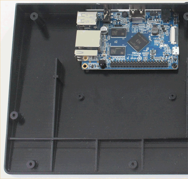

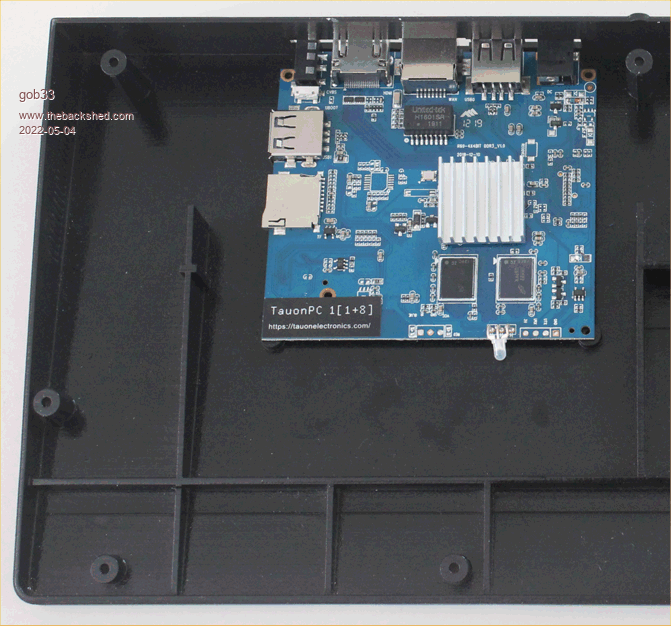

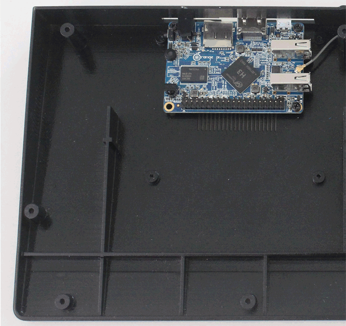

You have the TAUON-PC. Its AllWinner H3 board is removable and you can install Orange Pi Lite, Orange Pi PC, Raspberry PI Zero W, C-Sky board.
Posts: 9265
Posted: 10:05am 04 May 2022
Well, yeah, but it's not a mechanical keyboard, it costs $85 including carriage, it looks like it might be USB (it doesn't say, but that's not supported anyway) and it doesn't run MMBasic. :) They don't advertise the empty keyboard. Is it available?

According to the Tauon Forum, selling the bareboard keyboard only was not a valuable option for them as the price is low. I agree the shipping cost could be more adapted to the buyer country. You get the low quality corresponding to the price, this is not mechanical and I dont know any commercial mechanical keyboard tall enough to incorporate a board.
If you design a custom keyboard for pico integration, then molding it is far too expensive. Which leads you to 3D print it for every buyer. This is not viable and you should do compromises.
