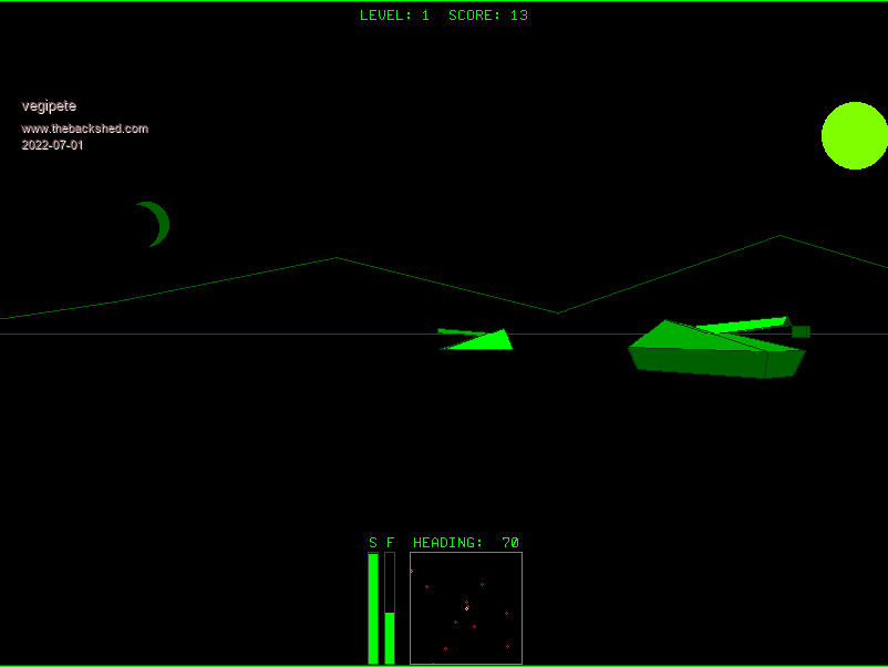

Here is my actual entry version of
Stellar Battle in the 7 Green Hills Zone.
This zip file contains my entry, plus an expanded version for readability, a slightly modified version to use with MMB4W, plus a user manual.
With the same length of 5116 bytes as the previously posted version, I've added a demo mode, with enough space for a single comment at the start! I think I've found just about every single little trick to save characters. Result: clarity = 0.
As before, this program may hang the CMM2 release firmware. It does run on the latest beta firmware. Changing the numerical value '150' on line 145 to something larger such as '220' can reduce the likelihood of triggering the firmware bug that causes the freeze.
Many thanks to Peter Mather for creating the 3D commands that make this game possible.

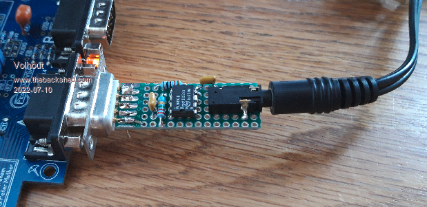

Hi Tom,
I have put together an adapter for the GAME 1.4 board, I will send it to you tomorrow morning. If you playtest the program, please ensure you have OPTION CPUSPEED 252000
Otherwise timing will be off.
I tried your interface this morning with the latest 5.07.05b14, and it works, Only the timing in option 3 is off (the picture is under an angle) but that is to be expected when Peter tunes and changes the basic interpreter.
The audio is plugged into it with a 3.5mm jack (I use a male-male cable from the laptop audio output).
plz. PM me your adress, I have lost it.

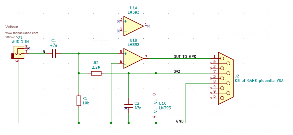

Thanks Volhout, I'd still appreciate your telling me how to connect the IC. I have my own interface board 60% built, it's "a bit 'how ya going" (I apparently need new glasses) but I'd still like to complete it.

Small explanation:
The LM393 has 2 comparators. Only 1 is used. The LM393 output is "open collector" similar to "open drain". It can only pull low. It cannot pull high.
That is why you need the 10k pullup connected to 3.3V on the 1.4 board.
The 2.2Meg resistor is to create a 15mV offset at the input of the comparator. It pulls the input slightly high to ensure the output of the comparator is high.
Wait a moment... the comparator cannot pull high right...
This input offset causes the comparator output to be high impedance when there is no audio.
So essentially the audio circuit is not "loading" GP0 when there is no audio.
Reason:
- easy testing (you can disconnect the audio cable, and program a PWM at GP0 with 50% duty cycle, with frequency 1kHz or 2kHz, and see that the PIO demodulator works).
- I designed this interface for Peters VGA board, where there are 3 pico footprints. On one of the footprints I had this interface. And when you disconnect the audio cable, you could uses GP0 from the other footprints undisturbed. This does not apply to the GAME board, there are no parallel connections to GP0.

  Volhout said  The audio is plugged into it with a 3.5mm jack (I use a male-male cable from the laptop audio output).
I like your DB9 to sea-of-holes module (the bare board itself). Is that a commercial product, or one you designed/made? It appears to have actual pads for the DB9 solder cups, so not just perfboard.
