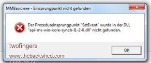

  matherp said  Has anyone got the latest version running on W7? I'm not aware of using anything W10+ specific but all my machines are on W10/W11 so no way of testing the out-of-date non-supported W7
V5.07.03a3 crashes on two PCs. Both on which I've tried it.
Michael
Posted: 03:54pm 19 Feb 2022
  Quote  V5.07.03a3 crashes on two PCs. Both on which I've tried it.
Both W7?
Do you have swap space properly set up? How much RAM?
More info
The big change in the latest release is sound. This uses a windows library winmm.dll. If you goggle this it is a known issue on W7 and there are solutions for getting it and where to put it
Edited 2022-02-20 02:08 by matherp

Posted: 04:35pm 19 Feb 2022
  matherp said  Both W7?
yes!

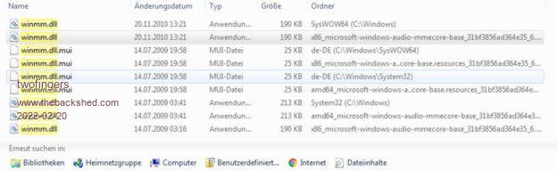

  matherp said  Do you have swap space properly set up?
I would say yes! (8 GB)
  matherp said   How much RAM?
8 GB RAM too. The 2. has 16 GB RAM.
  matherp said
More info
Hmm ...
At least Winmm.dll is present.
Edited 2022-02-20 02:37 by twofingers

Posted: 04:56pm 19 Feb 2022
OK so it is definitely sound and winmm related. I'll leave you to see if you can get it working. The app is W32 so it is the 32 bit version of winmm.dll you need to be in the right place.
twofingers
Joined: 02/06/2014
Posts: 1783
Posted: 05:38pm 19 Feb 2022
  matherp said  OK so it is definitely sound and winmm related. I'll leave you to see if you can get it working. The app is W32 so it is the 32 bit version of winmm.dll you need to be in the right place.
I downloaded winmm.dll (32bit),winmmbase.dll and api-ms-win-core-libraryloader-l1-2-0.dll and I still get an error message. I think it's easier to move on with WIN10.

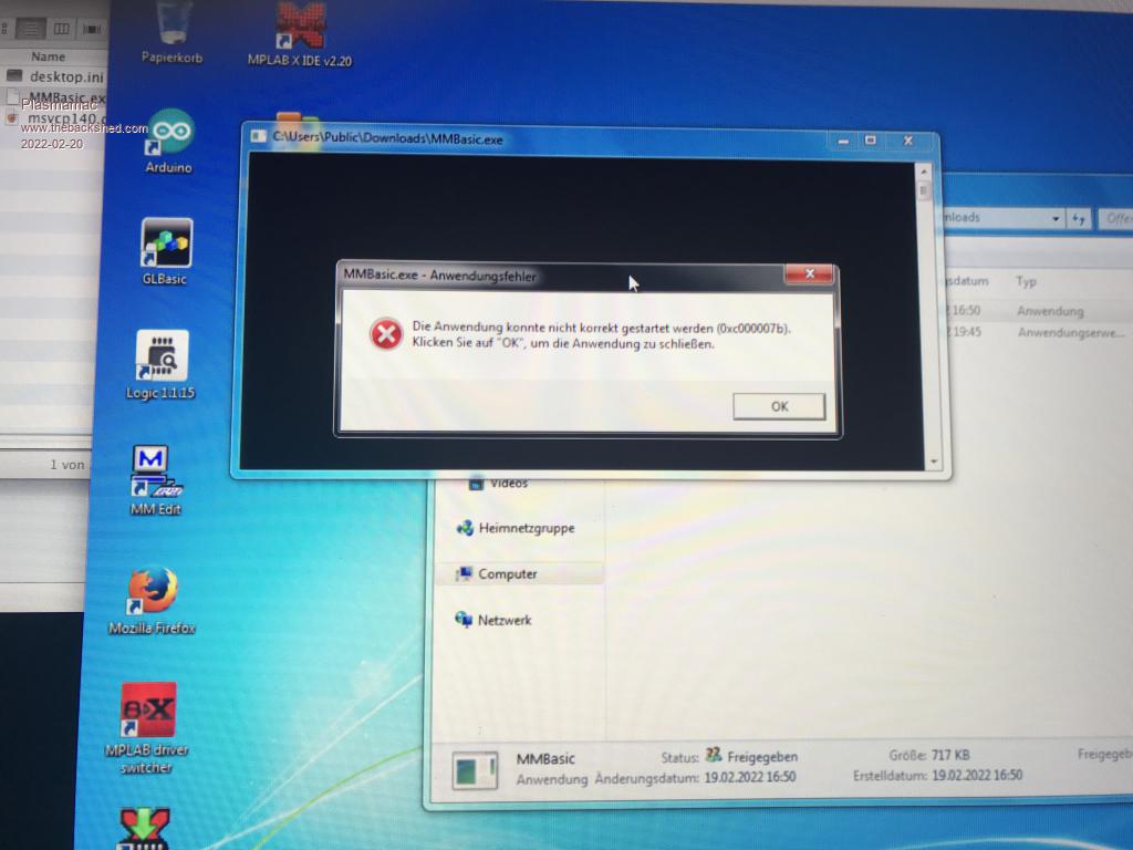

Plasmamac
Joined: 31/01/2019
Posts: 620
Posted: 02:45am 20 Feb 2022
Win 7 vmware
Edited 2022-02-20 12:52 by Plasmamac
Plasma
