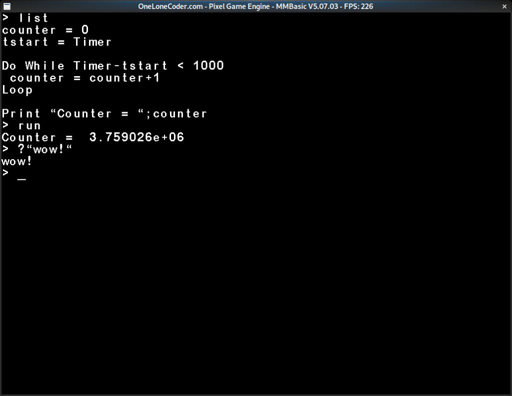

Posted: 10:57am 27 Jan 2022
MMBasic under "wine" on a debian "buster": 3.7 mio loops in a second!
-andreas

Posted: 12:52pm 27 Jan 2022
@Andreas
226 Fps ? What your specs and is this the gui release version?

Posted: 01:12pm 27 Jan 2022
  Plasmamac said  @Andreas
  Quote  $ inxi -F
System:    Host: server Kernel: 4.19.0-18-amd64 x86_64 bits: 64 Desktop: MATE 1.20.4 Distro: Debian GNU/Linux 10 (buster)
Machine:   Type: Desktop System: FUJITSU product: CELSIUS W580power v: N/A serial: <root required>
          Mobo: FUJITSU model: D3617-A1 v: S26361-D3617-A1 serial: <root required> UEFI: FUJITSU // American Megatrends
          v: 5.0.0.13 R1.25.0 for D3617-A1x date: 06/30/2020
CPU:       Topology: 6-Core model: Intel Core i5-8600 bits: 64 type: MCP L2 cache: 9216 KiB
          Speed: 800 MHz min/max: 800/4300 MHz Core speeds (MHz): 1: 800 2: 800 3: 800 4: 800 5: 800 6: 800
Graphics:  Device-1: Intel UHD Graphics 630 driver: i915 v: kernel
          Display: x11 server: X.Org 1.20.4 driver: modesetting unloaded: fbdev,vesa
          resolution: 1920x1080~60Hz, 1920x1080~60Hz
          OpenGL: renderer: Mesa DRI Intel UHD Graphics 630 (Coffeelake 3x8 GT2) v: 4.5 Mesa 18.3.6
Audio:     Device-1: Intel Cannon Lake PCH cAVS driver: snd_hda_intel
          Sound Server: ALSA v: k4.19.0-18-amd64
I have problems to use my german keyboard layout under wine. Is there any OPTION or wine config?

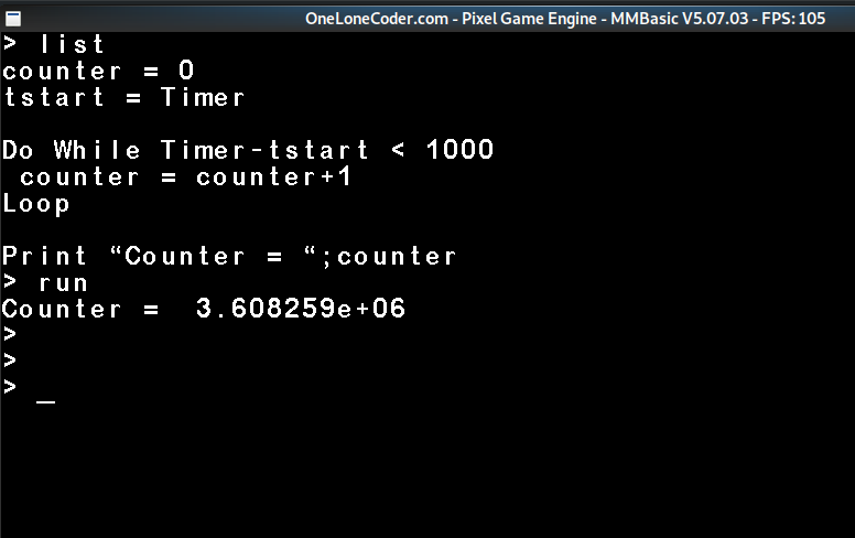

Posted: 01:19pm 27 Jan 2022
this are the results with the gui version: FPS 105 but loop with 3.6 mio/s
-andreas

Posted: 01:56pm 27 Jan 2022
  andreas said  this are the results with the gui version: FPS 105 but loop with 3.6 mio/s
-andreas
Well more than that, actually because you are doing the Timer - tstart for every loop.

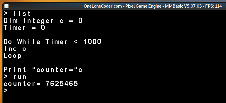

Dim integer counter = 0
Timer = 0
Do While Timer < 1000
Inc counter
Print "counter="counter
BTW: FPS: 17 (4*3 GHz)
even faster:
Dim integer c = 0
Timer = 0
Inc c
Print "counter="c
Edited 2022-01-28 00:34 by twofingers
Tinine
Joined: 30/03/2016
Posts: 1646
Posted: 04:49pm 27 Jan 2022
  twofingers said
  Tinine said  Well more than that, actually because you are doing the Timer - tstart for every loop.
Yes!
Timer = 0
Inc counter
even faster:
Dim integer c = 0
Timer = 0
Inc c
Print "counter="c
I might be thinking of another processor but I found a lot of the time was attributed to the Do/Loop and therefore I pasted hundreds of lines within the loop to get a better idea of in-line code execution time.

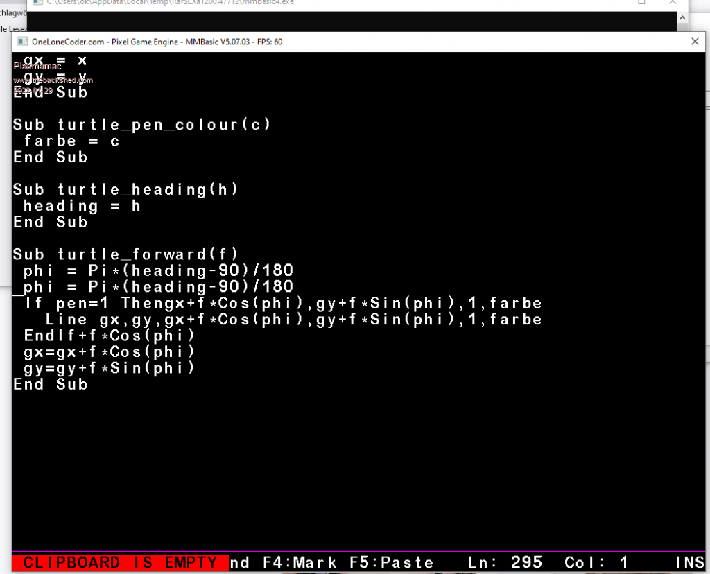

Plasmamac
Joined: 31/01/2019
Posts: 620
Posted: 05:48pm 28 Jan 2022
Hi ,
trying the turtle code from andreas gives me an error in line 296
then type edit
press enter
the line show double  but clipboard is empty
hope it help
Edited 2022-01-29 03:49 by Plasmamac
Plasma
andreas
Joined: 07/12/2020
Posts: 226
Posted: 05:52pm 28 Jan 2022
  Plasmamac said  Hi ,
then type edit
press enter
hope it help
The original code should be:
sub turtle_forward (f)
 phi = pi*(heading-90)/180
 if pen=1 then
   line gx,gy,gx+f*cos(phi),gy+f*sin(phi),1,farbe
 end if
 gx=gx+f*cos(phi)
 gy=gy+f*sin(phi)
end sub
possibly an transfer error...
-andreas
andreas
Joined: 07/12/2020
Posts: 226
Posted: 07:02pm 28 Jan 2022
I get the same error as Plasmamac when using pa2 version. Nikolaus runs using pa1.
-andreas
