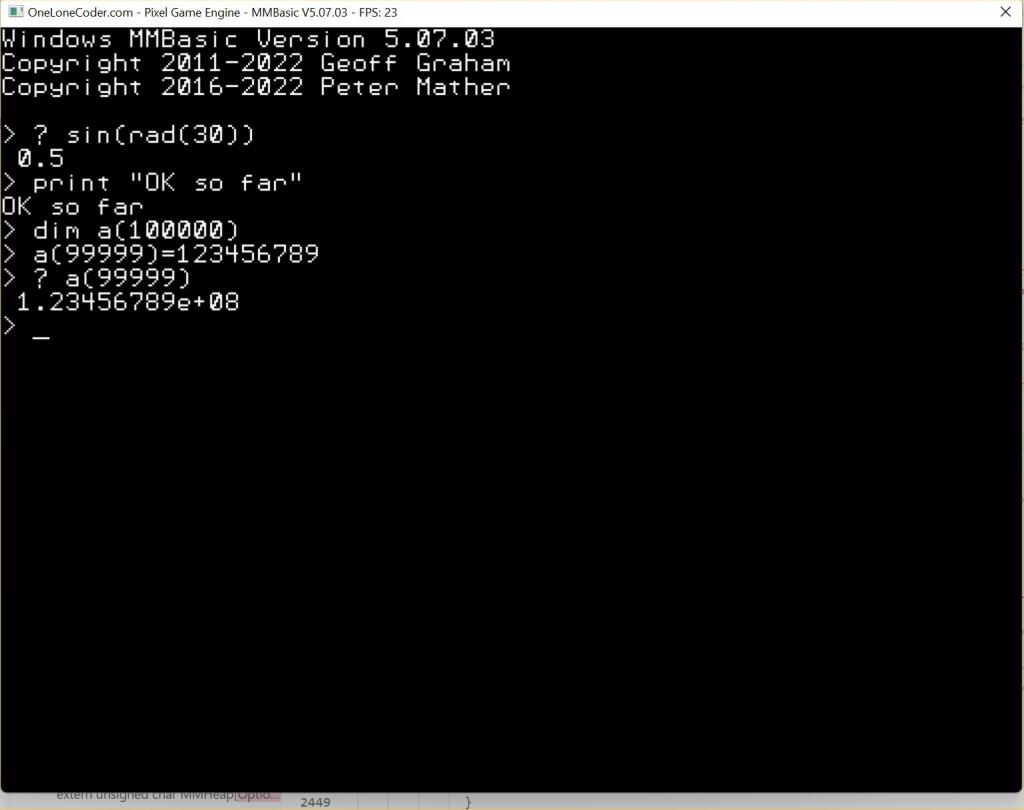

Posted: 03:45pm 23 Jan 2022
It lives
Showing a 1024x768 window with a 24x16 font. Lots of memory
Running in debug mode FPS in release mode is c260FPS
Edited 2022-01-24 01:47 by matherp
