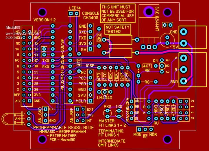

  Mixtel90 said  The circuit of the RS485 version is pretty simple really. COM1 on the Micromite is connected directly to the MAX485 chip. Pin 7 (DE) is connected to both /RE and DE on the MAX485 via an inverting transistor as pin 7 is normally high, going low during transmit.
You might want to have a 3 pin /RE jumper to select between:
1. /RE is active all the time (meaning the MX170 receives all transmissions, including its own) i.e. /RE which is grounded and only DE is under program control.
2. /RE and DE both connected so can only listen to RS485 bus when not transmitting.
The reason is sometimes it is useful to see all transmissions on the RS485 bus (for example using as a bus monitoring device).
Also make sure the PCB can fit a 0.5W (half watt) resistor for the "ground current limiting" resistor (might be Rg on the PCB?) considering the surrounding components.
I would also add a 3 pin male header near the RS485 connector as an alternate RS485 bus connector, or use as test points for the RS485 signals (same A/B/GND).

I'm not happy about changing the R/G LED to separate ones. It won't happen on my design. Every bit of something that leads to the outside world is another problem in locating it in the end plate. A single LED is at least 5 times easier to line up than two. :( As it is I'll have a single end plate that works with both the I2C and the 485 versions.
The current version is designed to give two modes of operating DE. As standard Pin 7 is inverted to provide the signal. To use direct connection Q1 is omitted, together with RB. A link is fitted where shown on the circuit board and the 10k collector resistor RU is transferred to the RG position to force the system into receive by default. The user must then raise pin 7 prior to transmit and lower it once the TX buffer is empty.
There is no "ground current limiting" as it's not required here.
I think TXD and RXD would normally both sit at 3V3 and the LED is a common anode type, so you could probably connect the resistor side of the LED14 link and the GND end of the red LED resistor to TXD and RXD. The resistor values limit the current to approx. 3mA through the LED. That would give you pure hardware LED drive.
This *is* the pcb. There's unlikely to be any further changes (by me anyway). I didn't originally intend to make a RS485 version at all. :)

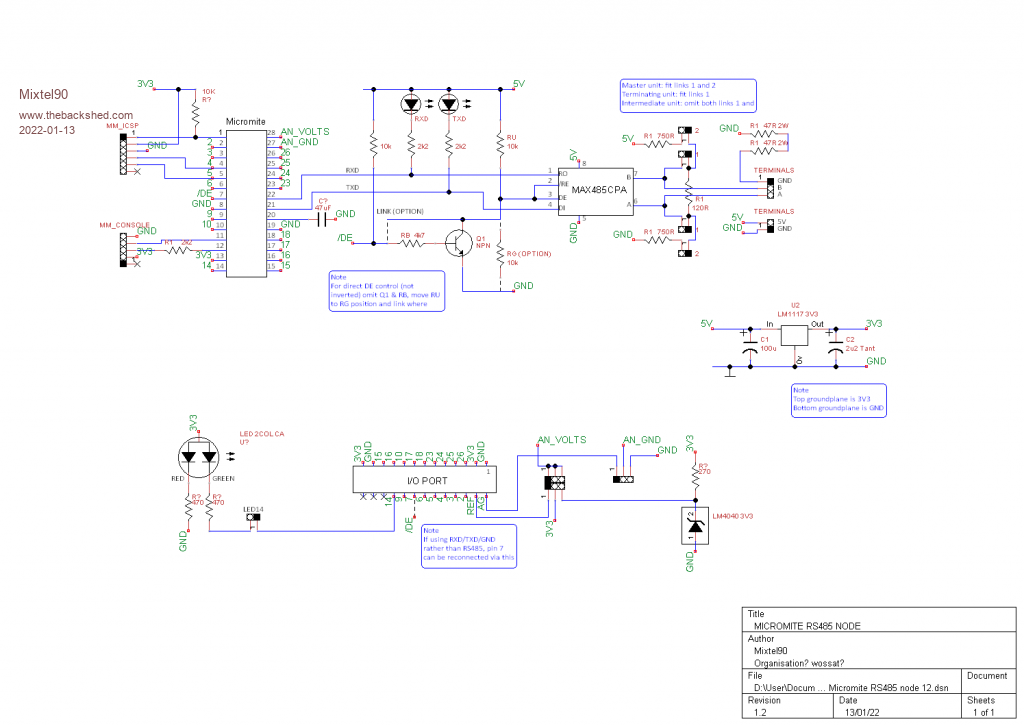

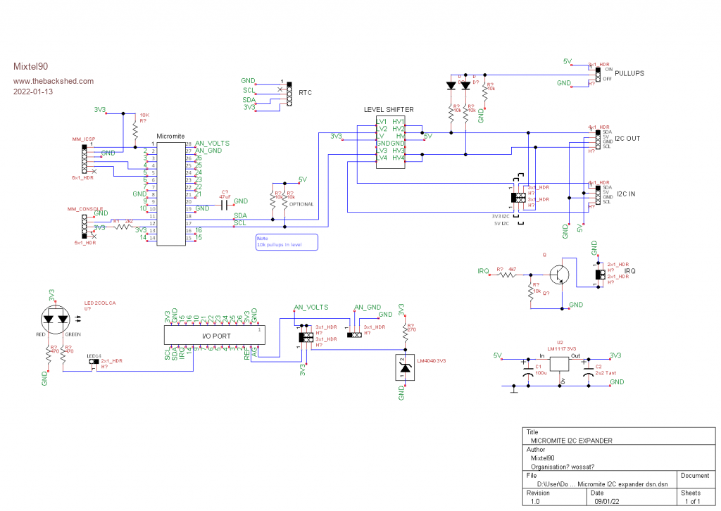

I2C version circuit diagram:

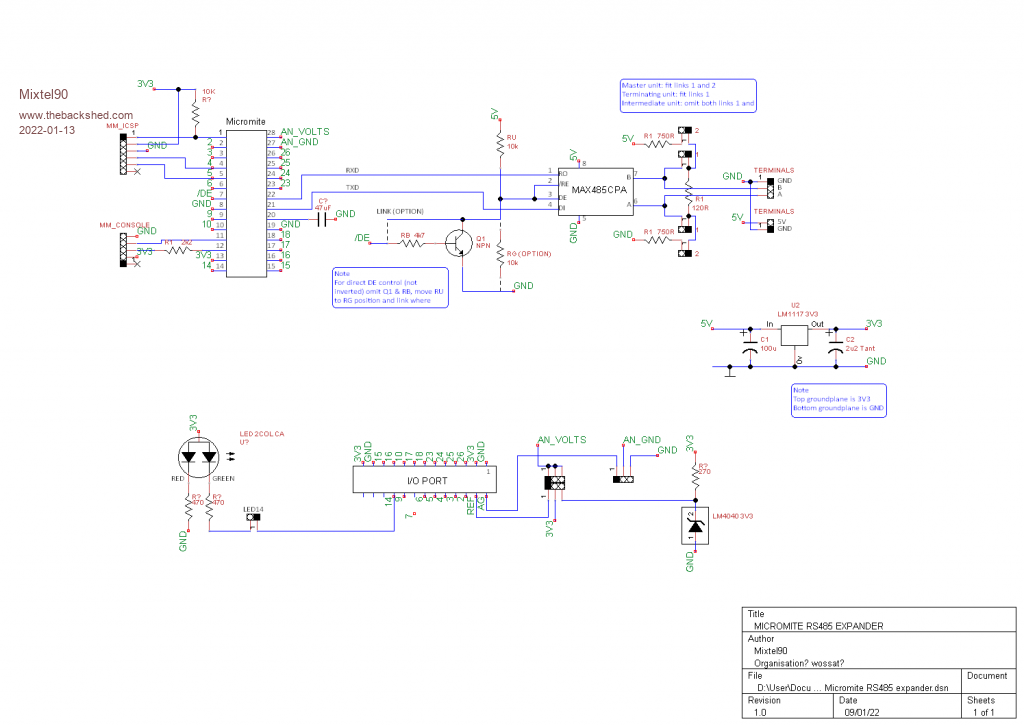

RS485 version circuit diagram:
Please remember that these are not to be used for "serious" things like machine control. They are learning/hobby exercises and there is no protection from external problems or anything like that. I'm not going to produce devices for commercial use under any circumstances - under UK law I would be personally liable if something went wrong due to malfunctioning of one of my devices. Hence, if you find that I've omitted things that you'd expect on commercial gear then I'd respectfully suggest that you purchase proper equipment rather than try to use these as the manufacturer will (hopefully) be covered by suitable insurance.

On the rear of the RS485 version I've just gone for a horizontal male pin header for the link block, simply taking 0, 2 or 4 links. This can be a vertical type if you want to keep the links inside.
The two and 3 way terminals have 1mm square pins on 5.08mm centres. You can use fixed terminals, vertical pluggable terminals or horizontal pluggable terminals (as shown on the drawing).
The I2C version uses horizontal male pin headers all along the back. The IRQ one has two rows and is intended to take two Dupont connectors horizontally one above the other, one as a loopthrough and the other to the host. They are simply in parallel.

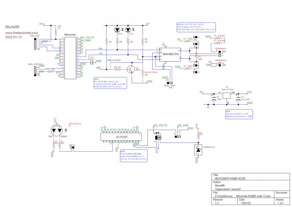

You went and did it, you lot, didn't you? I was determined to leave this board alone and you gave me the challenge to fit more bits onto it - and I couldn't resist. :)

Small question: on the schematic, should the /DE signal go to the pin marked '7' on the I/O connector?
Posts: 9265
Posted: 12:00pm 13 Jan 2022
Not normally. There's a solder blob link on the back of the board that can make that connection if you want to forget RS485 and use TXD/RXD/GND instead (easy enough to link out on the pcb). Normally /DE is connected via the inverter to the MAX485. (I've just noticed that I've missed the 2-position link for the MAX485 RE connection off the circuit there...). The normal alternative connection is via the "direct connection". I think /DE on the IO connector is generally a bad idea and just asking for trouble with a RS485 connection. :)

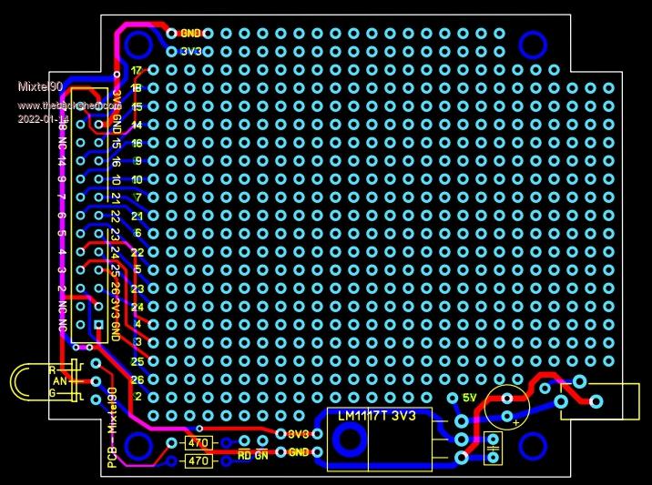

Special Three for Two offer today!
Here's a bit of something for those who like to solder. Same size board. Optional regulator and 3.5mm barrel jack for 5V. Same IO connector and LED, all connected to pads on a big sea of holes. Back end open for whatever you want. Note that this isn't a female connector to plug into the male connectors on the other boards - I'm not even sure if you can get them. This board might be nice if you wanted to use a conventional I2C expander chip for all digital signals or perhaps for interfacing from a 20mA current loop.
No circuit diagram. It's self-explanatory really.

The LM1117 has 100uF at the 5V and 2.2uF tantal at the 3.3V output.
The 2.2uF is however the only decoupling cap at the 3.3V rail.
There is no 100nF at the MX170. That may be a bit risky, since the LM1117 is not close to the MX170.
Maybe the 485 driver could also use a capacitor to decouple the Vdd (5V).
Edited 2022-01-14 01:33 by Volhout

  Quote  Here's a bit of something for those who like to solder. Same size board. Optional regulator and 3.5mm barrel jack for 5V. Same IO connector and LED, all connected to pads on a big sea of holes.
Maybe should have diode on 5V input jack to protect against reverse polarity?
Edited 2022-01-14 01:53 by flasherror

I did think about extra caps near the MX170, however there's virtually no volt drop and a lot of distributed capacitance between the groundplanes. It's something to think about. You could always pop a 100nF disk under the board if there's a problem. :)
The 2.2uF (or a bit more) tantalum is, according to the LM1117 spec (providing I've read it correctly, that is), fine for regulator stability and a bypass isn't needed for that. Note that it can't be an aluminium electrolytic.

You can use one, two or no ground protection resistors. If you are looping a common 5V supply through then you don't want any - fit a link. If you have 2km of cable between them with 30 more nodes then 94R 4W might not be enough - you may need 100R 7W mounted off board. You can use 100R 0.5W if you like, it's no problem. There just happened to be board space available to take them. They are an option. :)
If you are clever enough to solder the bits on the sea of holes I expect you to be clever enough to at least check the polarity of your supply and get it right first time. :)  This isn't a beginner's module as it doesn't do anything. (It's more fun to put a 10A reverse biased diode across the jack so it blows up the PSU if you get it wrong. :) Doesn't have any volt drop either.)

I've been playing again anyway. :)
I've included space for an internal header for Gnd/RXD/TXD monitoring.
In line with a Circuit Cellar article:
I've made it a single 100R 1W resistor for ground protection.
The 750R balancing resistors have been reduced to 560R.
Interesting to note that if you use CATn cable to connect them then you get a better match using 100R terminating resistors than using 120R (although the drivers are expecting 120R).
