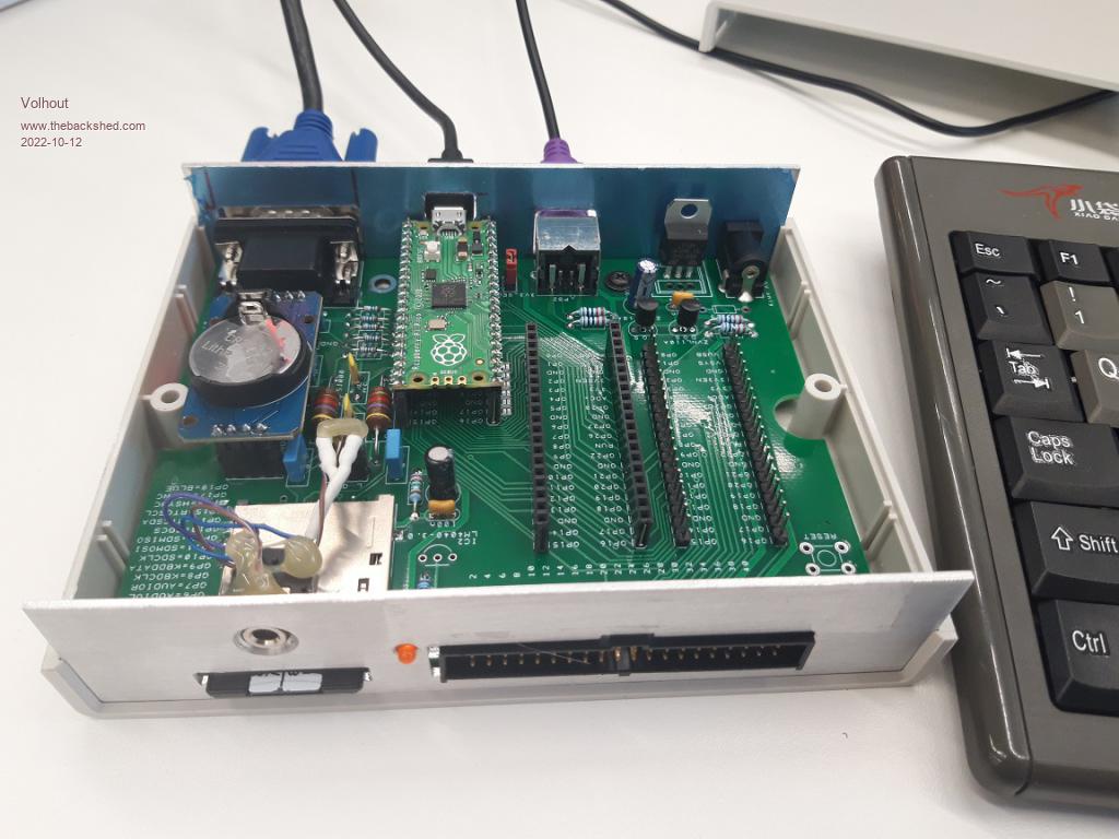

Posted: 07:03am 12 Oct 2022
JLCPCB was fast
Less than 2 weeks and the boards where in Netherlands..
And less that 2 hours later.......
Up and running...
Good thing that between 1.4 and 1.7 the location of the connectors was not changed, so I could mount the 1.7 board 1:1 in the case.
Thanks Peter !!
P.S. I have 2 board spare (1.7 version). PM me if you need one...

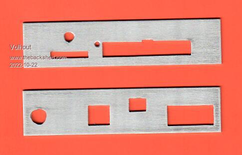

Posted: 07:04am 21 Oct 2022
@Volhout:
Do you have a template for your pretty bezels? They look very professional!
I would have to make some for my housing as well...
Frank
Posts: 6199
Posted: 07:28am 21 Oct 2022
Hi Frank,
The bezels came with the box (the G738A from Farnell). I just drilled some holes in it and filed (is that je right word ?..grinded ?) them to size.
I can "photocopy" them if you like, but I have no CAD files.

Posts: 6199
Posted: 08:58am 22 Oct 2022
For contrast I added orange paper...
The manual drilling and grinding causes damage to the visible surface, so I took some sanding paper to give the Aluminum a cleaner look.
Edited 2022-10-22 18:59 by Volhout
