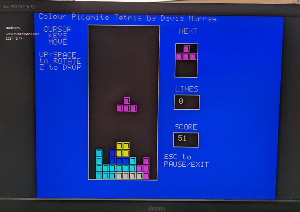

Just for fun I added some small level of original Colour Maximite graphics compatibility like the CMM2
Available in the PRINT statement is the @ function for locating the cursor (see CMM2 manual)
OPTION LEGACY ON/OFF is a temporary option to be used in a program. It affects the following commands
COLOUR - uses colours 0-7, see original colour Maximite manual
PIXEL - see original colour Maximite manual
LINE - see original colour Maximite manual
CIRCLE - see original colour Maximite manual
To prove compatibility here is David Murray's Tetris implementation running with no changes on the PicoMite VGA edition
