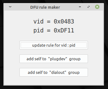

Posted: 04:03pm 03 Jan 2022
as promised, a small linux utility (32- and 64-bit) to create the rule for any DFU device, which also has buttons to adds the current user to plugdev or dialout groups:
DFUfix (2022-01-04).zip
just three buttons:
1. run the program, then plug in your STM32 device. the VID and PID displayed update whenever a device is plugged in, so you can plug in a 'black pill', then press the Boot0 and nRST buttons as required to reboot it into DFU mode. basically do whatever is needed until the right VID and PID are displayed.
2. press the top button and enter your password when asked. a new rule is created to allow members of the 'plugdev' group to access to the device.
3. press the middle button to add yourself to the 'plugdev' group - you will be prompted to enter your password again.
4. press the bottom button to... add yourself to the 'dialout' group. needed to access serial ports, as we have all discovered!
the flashing asterix at the top left of the screen indicates that the dmesg utility is running in the background, which is how the utility knows when USB devices have been plugged in.
full source code (lazarus 2.0.12) included in the archive. the 'interesting' code is in the files unit1.pas (the GUI program) and unit2.pas (console code to manipulate the rule file). the utility pkexec is used to gain root access when required, and should already be installed on most desktop distros.
rob   :-)

I have a Mint laptop I have not tried to use the Cube programmer on yet, so I will try this out and let the thread know what happens, but I expect your little app to fix the issue very painlessly.
