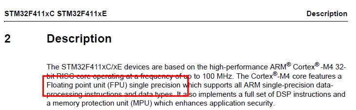

alas not backed up by the CPU datasheet. One hopes a mis-print.
Micromite floats are single (4 byte) in software. Double precision can be done in software but then the FPU is redundant - at least on the face of things. Unless double and single are supported but that would be a massive change to the firmware, affecting every point where numbers are evaluated (a lot).

Only the M7 CPU have double precision floating point. FP on the 411 (M4) is actually disabled in my build as it slows performance when using DP

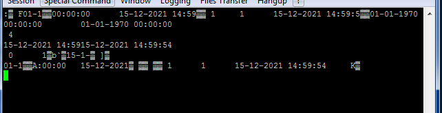

I loaded up my torture code but I am getting weird lockups (have to reset to recover). I can't seem to pin it down as they change each time. Nothing fancy in the torture code just stock MMBasic - I have attached it on this post. Can others download it and test on the BP? (it runs fine on all other platforms I have tried). Test 3.zip

and lockups after random output:
(needs a reset at this point)

Bug: your code is too complex and you are trashing the stack. The current version doesn't have stack checking. If it did you would see
  Quote  Error: Expression is too complex
Only solution is to reduce variable space and therefore program space from 72Kbyte downwards
