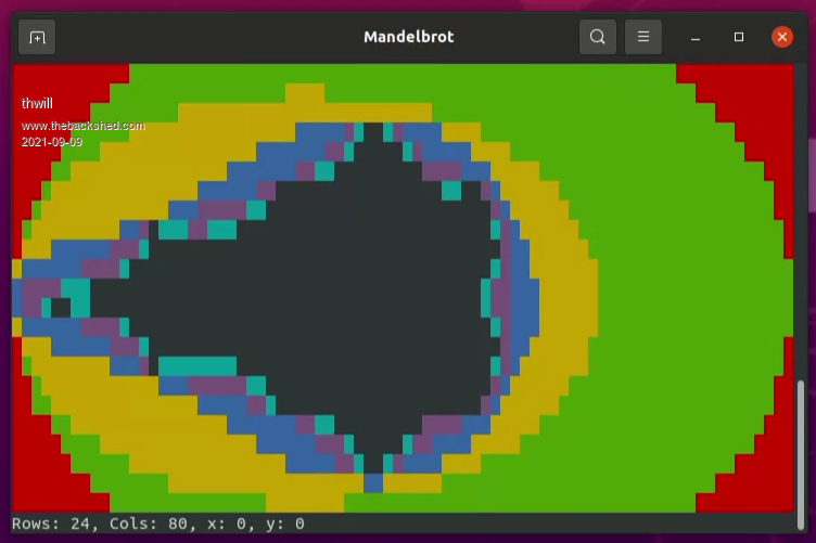

Posted: 01:24pm 09 Sep 2021
It is not my intention to bloat MMB4L with lots of extensions to MMBasic but I got distracted from my main TODO list and had a bit of a play yesterday evening.
Video shows integration with the 'nano' editor and the new CONSOLE command that I've added specifically for the Linux version.
   https://youtu.be/oZCO5qpnAAA
Screenshot:
Program (MMB4L only):

Edited 2021-09-09 23:35 by thwill
Posts: 9273
Posted: 02:29pm 09 Sep 2021
Very nice! :)
