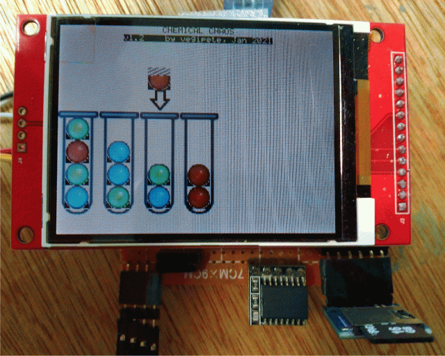

VegiPete's ChemiChaos on the PicoMite
(Bad camera artifacts.)
Youtube video: ChemiChaos
Code and 2 bmp files:
cc_pico.zip
I put a jumper on the snipped MISO line and tried a different ILI9341, and the SD card worked. I put the prior failing ILI9341 back in, and it still failed, so apparently there are some ILI9341s which will kill access to the SD card in the same way that the ILI9488 does (or in a similar way with the same result).
This same program works on the F4. The ILI9341 which fails on the PicoMite works perfectly on the F4.
I think this program also still works on the CMM2 (with VegiPete's original ChemiChaosSprites.png sprite image file)--I haven't tested it with the PicoMite changes in it.
Edited 2021-06-24 04:04 by lizby

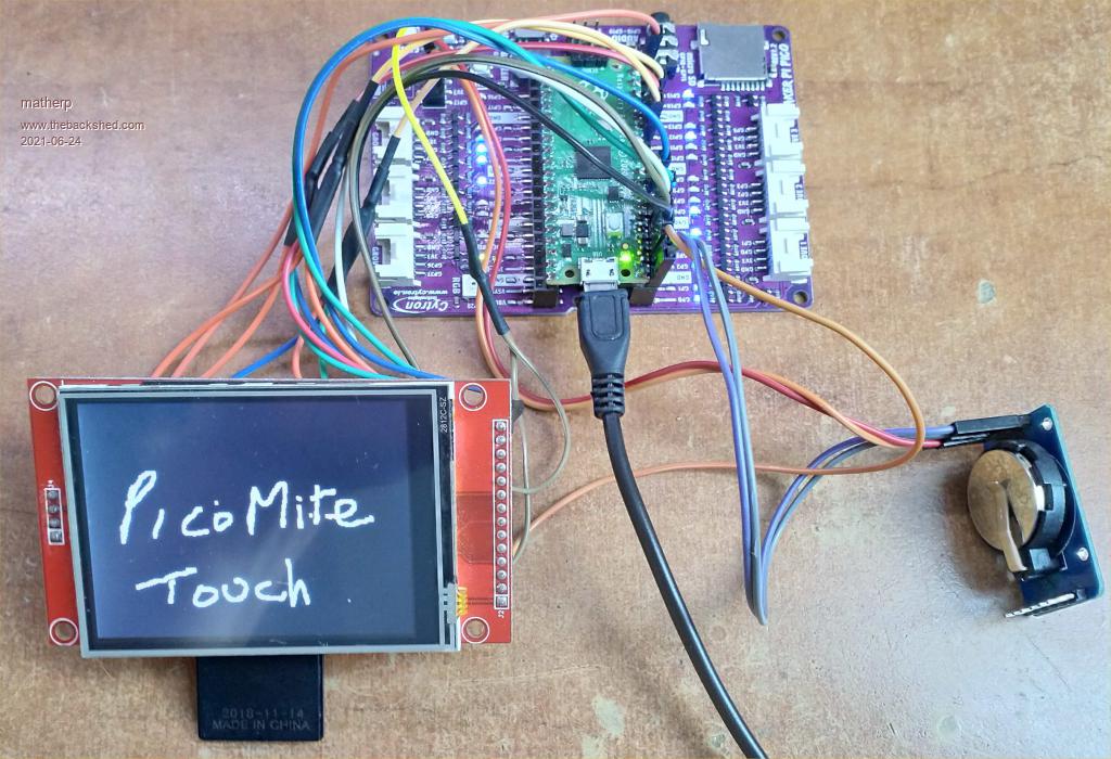

NB: the buzzer on my Maker card completely kills the processor if I try and use it - another power issue?
OPTION POWER PWM/PFM is now a permanent option and is executed on boot
Note to Volhout: IR is working and tested and available on any pin e.g.
SetPin 1,ir
IR a,b,irint
Sub irint
Print a,b
Note in the picture I'm using the SD socket on the LCD. I made up 3 wires each with 3 Dupont sockets and 1 Dupont plug. This allows me to connect all three SPI pins to the three devices (touch, SD, and LCD), of course each needs its own CS pin
