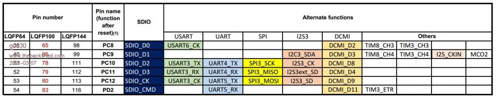

Posted: 10:41am 06 Mar 2021
  matherp said
What cards are you using? the SD works perfectly on both the cards pictured in this thread
I have exactly same 2 cards as on your pictures.
On your old src files, you use also GPIO, not spi and in "Files" function, you call "initSDCard" to know if card is present
Edited 2021-03-06 20:46 by goc30

Posted: 10:53am 06 Mar 2021
  Quote  On your old src files, you use also GPIO, not spi (your I/O named "Cd" -Card detect)
Not sure what you are referring to. The old code had lots of conditional compilation and irrelevant code as it supported H7, F7, and F4. The new code only supports F4 and I've stripped out all irrelevant code. SDIO doesn't use CD and that code is no longer there
Out of interest please try the attached

Posted: 11:19am 06 Mar 2021
ArmmiteF407.zip
Same problem.
info: (maybe not important) after downloading bin, if I want to reload new bin, when I connect usb. It say "usb not reconnize"
other point:
is it possible that one of the outputs can also be used by another function
Edited 2021-03-07 02:16 by goc30
