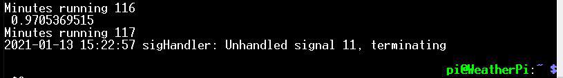

Posted: 03:29pm 13 Jan 2021
Sorry to report failed again
It ran for 117 minutes before crashing with the time
Posted: 04:52pm 13 Jan 2021
11 is SIGSEGV i.e. a bad pointer

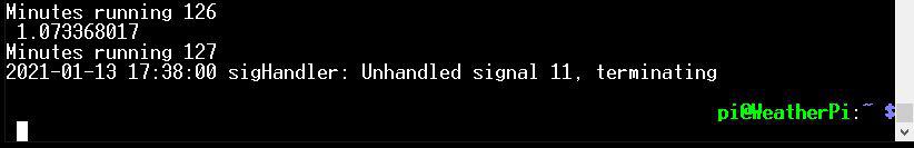

Posted: 05:56pm 13 Jan 2021
Lasted longer this time  127 minutes
However Peter if you're watching this, I remembered to run Screen this time and once I reopened the console and did the -D -r it came back up with this with the same flashing cursor
No mention of parsing error or crashing because of it
I wonder if the processor is getting too hot and bugs out?

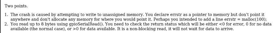

Posted: 05:29am 14 Jan 2021
it's Definitely not the JSON parsing that's making it crash
It stopped after 164 minutes and 56 seconds into the minute
I Set it to print the time every second as well as letting me know it received the data and parsed it ok.
It collects the weather data at 57 seconds into the minute and crashed at 56 so it can't be the data collection/parsing
Definitely seems to be Pigpio issue withy memory
I found this if you happen to see this Peter and didn't actually know it, but you probably did know
link to article
Edited 2021-01-14 16:27 by lew247
