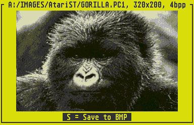

I'm having trouble with the Graphics Viewer. I down-loaded the images you used above (from ffmpeg/atariST.org) and then tried the Viewer on them. Both seemed to load OK but when the progress bar came to the end it threw an Error:
"Error in line 3748: Argument list."
Greg

it looks like older version of GRF.INC. What version you have (it's all either in new NC under F10 or in files on begin as VERSION.NC for NC.BAS, VERSION.GRF for GRF.INC and VERSION.TUI for TUI.INC)?
If the error line is with
GRF.loadST(filePath, 0, 0, 1, 1)
in older GRF.INC was not used the 4th parameter (progress bar ON)...

The versions are correct - I checked the code for each. The #INCLUDES are correct for the TUI and GRF in the current directory.
The error occurs on the long line starting:
LOCAL STRING dialog = TUI.......
The line above that has the 4 parameters:
IF GRF.loadST(filePath, 0, 0, 1, 1) THEN
Greg
P.S. gotta head off to bed now, getting late.

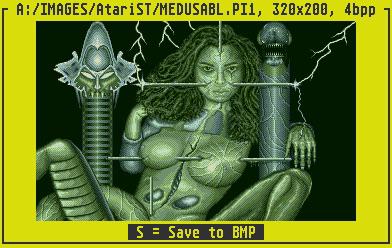

Hi Greg,
I was not able to reproduce the error, can you attach here the file (picture) you used? Anyway I found other bug in palette calculation, so I re-uploaded all the files to the GitHub again, please try to use newest version...
And after fix, the ST pictures should look so:

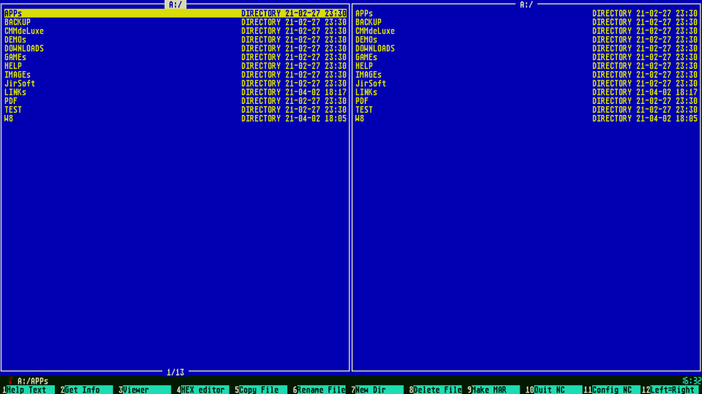

so finally again some progress in Napoleon Commander  (v1.24):
+ some operations are faster
+ improved network speed and reliability with new server (50-60kB/s transfer speed in both directions)
NCwifiServer.py 0.26 and ESP8266 OTA firmware (0.65) - both needed to be updated as well
+ on many operations cursor is not jumping to first file/dir anymore (Ruben   )
+ preparation for FTP server and ELF to CSUB convertor
- serial transfer not tested (so maybe not working), I need to retest it and possibly update NCserialServer.py
Enjoy (and give positive or negative response, please)...

new version of Napoleon Commander (v1.26) is here:
+ improved transfer speeds over both serial and WiFi, tested on CMM2 Deluxe by Piotr
new ESP8266 firmware v0.66 needed, can be installed over-the-air (OTA)
and also NCserver.py v0.28
+ new python server combine serial and WiFi server:
python3 NCserver.py -h
Napoleon server v0.28
NCserver.py -s <serverdir> -i <CMM2 IP> -v <verbose level>
NCserver.py -s <serverdir> -p <port> -v <verbose level>
 <serverdir>
   base directory for NCserver, Napoleon Commander on CMM2 see just inside of this
   (Napoleon Commander on CMM2 see just inside of this)
 <IP>
   IP address of ESP on CMM2 (WiFi server)
 <port>
   serial port for connection with CMM2 (serial server)
 <verbose>
   verbose level (0=min, 3 = max), default 1
+ bugfixes
Enjoy!
