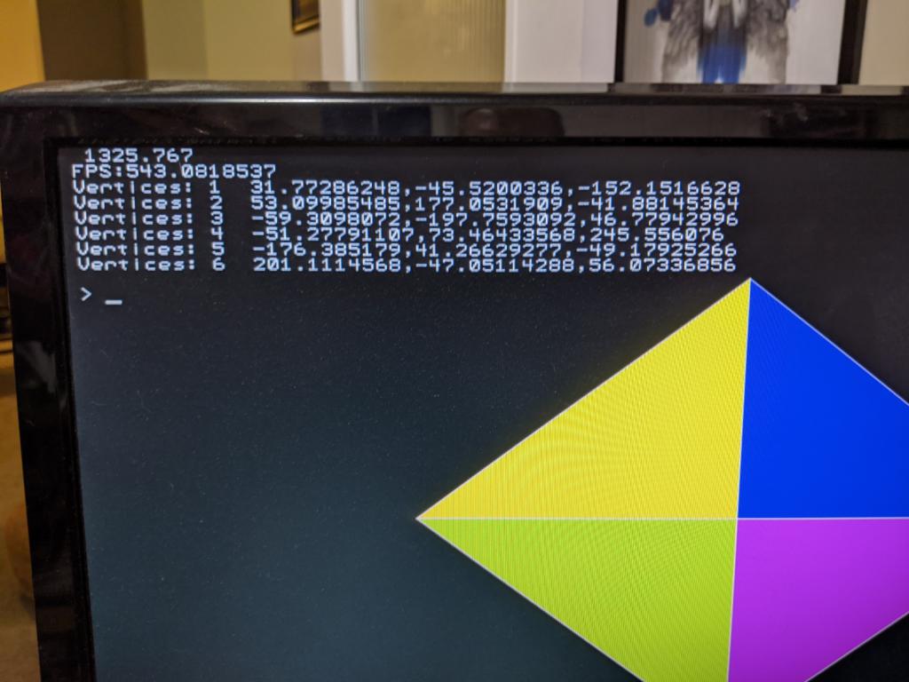

  vegipete said  Oh yeah! Some serious unrolling and matrix shrinking gives me under 1585 milliseconds. And that's at 400MHz.
That's absolutely fantastic! Brilliant job.
  vegipete said  I gather you are finding too that the end position is not the same as the start position?
Mine ends up matching?

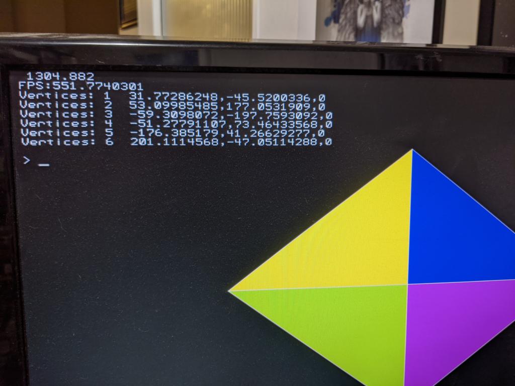

Here are my iteration 650 numbers... but of course I have no idea if they are right or wrong as none of us have matched
PeteCotton
Joined: 13/08/2020
Posts: 669
Posted: 02:25am 10 Nov 2020
P.S. Ignore the time at the top of the last picture -that's with RC15

z = 0? Those are projected coordinates?
I get one rotation of the octahedron every roughly 157 iterations. Which, curiously, is about pi divided by 2, multiplied by 100... ???

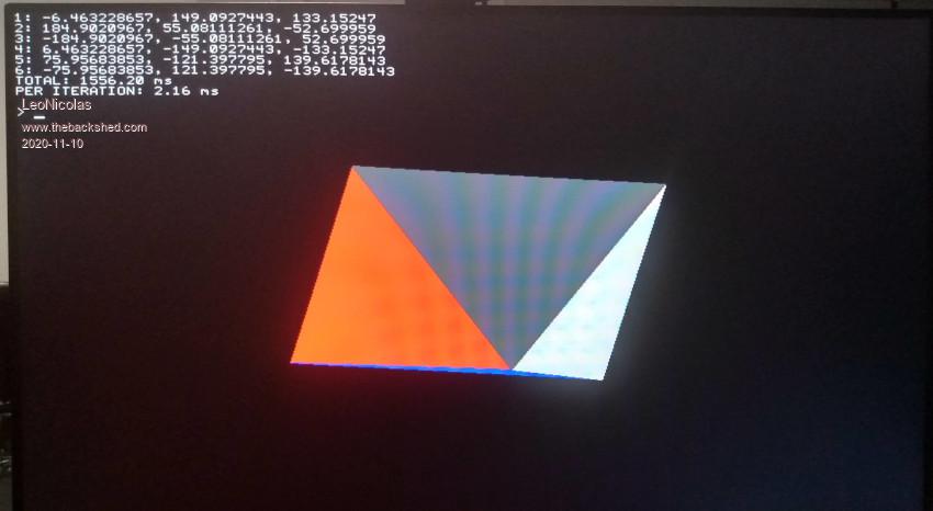

I don't know if after 720 iterations the object should be in the start position. You can see in the photos I posted before the position that the octahedron ended, and it never stopped at the start position. If I rotate using only one axis the end position is the same as the start position.
For clearing the previous frame I'm using a box slightly greater than the octahedron.

  vegipete said  z = 0? Those are projected coordinates?
Well spotted! I just realized I calculate and discard the z value with each rotation once I have calculated the perspective positions. So I added a bit of code to store them. It added 20ms to my time, so I'll remove it once it's done it's job, but full set of co-ordinates below. Thanks for spotting that!
  vegipete said  I get one rotation of the octahedron every roughly 157 iterations. Which, curiously, is about pi divided by 2, multiplied by 100... ???
I used "option angle degrees" to make my life easier. I'm guessing you're seeing a rounding error?

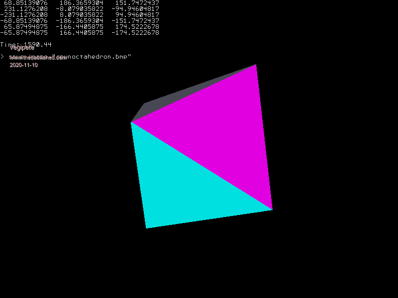

There is something strange with your vertex coordinates. I just checked the first one and the vertex is not 250 from the origin. I would expect the square root of the sum of the squares of x, y and z to be 250.
I can't tell for sure but I think LeoNicolas is getting a similar result to me, just with a reflection difference, perhaps from dealing with y axis up or down, etc.

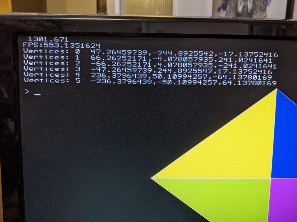

  vegipete said  There is something strange with your vertex coordinates. I just checked the first one and the vertex is not 250 from the origin. I would expect the square root of the sum of the squares of x, y and z to be 250.
By Jove you're right! I worked out that I was displaying the values after they had been adjusted for the viewplane at 800 pixels (therefore the massively distorted perspective values). Here's the pre-perspective values.
  vegipete said  In one of the posts, matherp described which direction the image should rotate for each of the x, y and z rotations. I made sure my orientations matched that.
Thanks, another good catch. I had my Y going the wrong way. Fixed in the below picture.

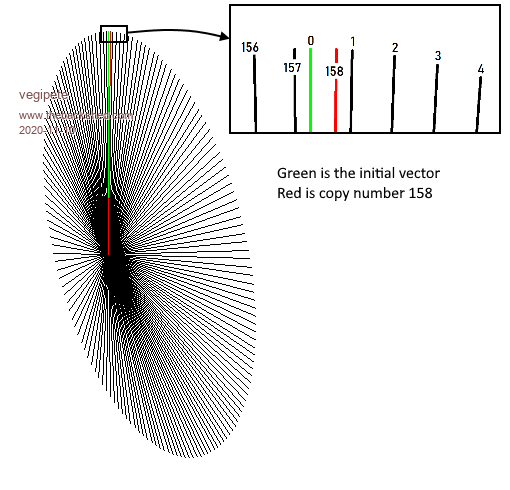

I just ran a check in a CAD program that allows scripting.
I created a vector from 0,0,0 to 0,0,1
I wrote a short script that:
1) duplicates a selected object,
2) rotates the new object 2 degrees around the x-axis,
3) rotates the new object 1 degree around the y-axis,
4) rotates the new object 0.5 degrees around the z-axis.
This shows the same, slightly over 157 iterations for a single orbit. Slightly over means that at 157 iterations, the vector hasn't quite made it back to the starting vector, 158 iterations has moved past the starting vector. (157.39 iterations for 1 orbit, as a first approximation.)

I'm doing exactly the same process and my end octahedron position (after fixing the rotation directions) is the same as yours image.
My concern is the polygon size. Before any rotation my octahedron has 200x200 due the viewplane and z distances.
Another challenge change is now we can use the RC15 as mentioned by Peter in the new firmware thread.

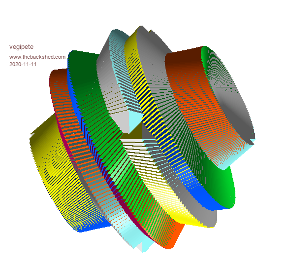

If I superimpose 150 iterations of an octahedron in the CAD program, I get the image below. The rotation direction is opposite of my CMM2 version, but the resulting shape matches, except for perspective issues - the image below is orthogonal.
(Comment out your image clearing BOX command to see the CMM2 equivalent.)
