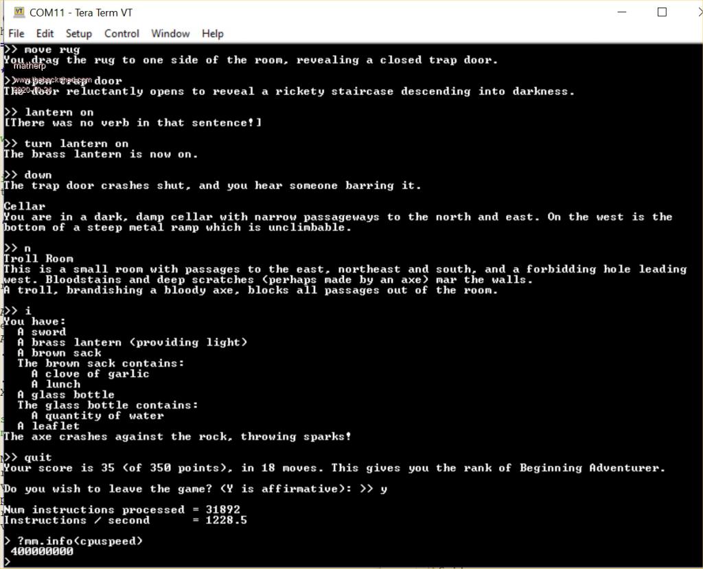

Posted: 03:58pm 23 Oct 2020
Very nice, but did you optimise the firmware? ... or have you just spent the last 24 hours hand optimising my code? ... please don't tell me it's the latter.
Edited 2020-10-24 02:00 by thwill
Posts: 12087
Posted: 04:02pm 23 Oct 2020
Haven't touched your code - just improved the hashing
Posted: 04:05pm 23 Oct 2020
  matherp said  Haven't touched your code - just improved the hashing
In that case we are truly not worthy to be blessed by your greatness

Is there a way of telling which I have from a query (rather than opening the case  )
Posts: 12087
Posted: 06:46pm 23 Oct 2020
  Quote  s there a way of telling which I have from a query (rather than opening the case
Look at the last line on the screenshot I posted

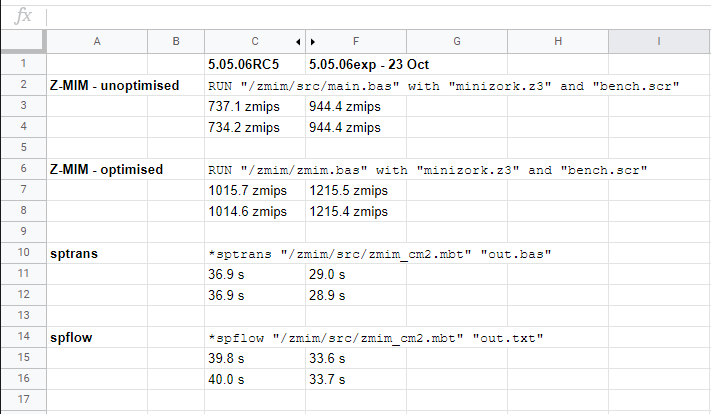

Posted: 07:49pm 23 Oct 2020
So far so good, and the spurious "Local variable already declared" error with "spflow" is gone too.
Will try to test the contents of the latest version of the "Welcome Tape" over the weekend.
Doh!
