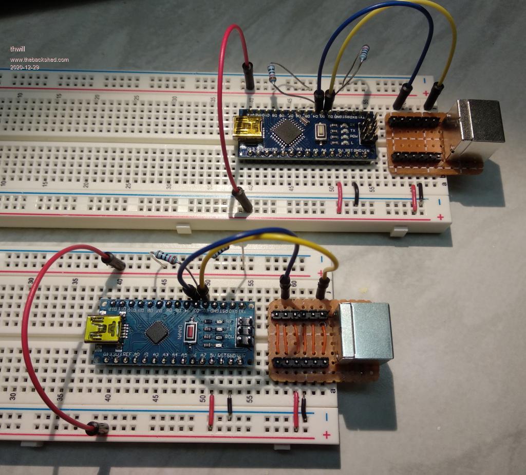

Posted: 11:24pm 28 Dec 2020
Hi Jim,
Just a few lines to say I'm still playing with this.
I think I now have the Nano <-> PS/2 working with a nasty old mini/laptop USB mouse that I dug out of a crate and a green Microsoft PS/2 <-> USB adapter, looks like I am getting the expected output on the Serial monitor but haven't had opportunity to connect it to my CMM2 yet.
My new PS/2 mouse still isn't co-operating and the Nano appears to "hang" after printing the initial Mouse OK. I'll get back to you with some more information the next time I find time.
One thing I notice even in the working case is that I sometimes have to Reset the Nano two or three times before things get moving.

On the nano, comment out the lines at the start that do the checkMouse()
leave the mouse.initialize(); as the only active line in that area.
if (in_mode == 0) {
   // Serial.println("Start here ");
  //  mouseOK = checkMouse();
  //  Serial.print("mouseOK ");
  //  Serial.println(mouseOK);
  // readStart = millis();
   mouse.initialize();
  // readTime = (millis() - readStart);
   // Serial.println(readTime);
 } else {
   joy_initialize();
connect CMM2 pin 8 to PS/2 clock line (nano pin D 3) via 100k resistor
connect CMM2 pin 10 to PS/2 data line (nano pin D 2) via 100k resistor
connect CMM2 pin 12 to clk_pin (CMM2 pin 8)
Once the program is running on the CMM2, do a reset on the nano to force the initialize routine.
