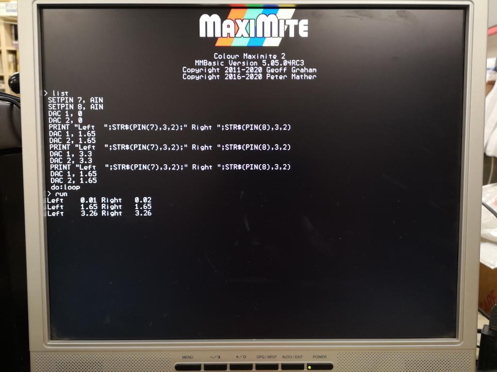

  TassyJim said  I know you have checked the wiring but can we do a test.
 Connect the audio left and right audio to pins 7 and 8
 It doesn't matter which go where at this stage.
 Run this program:
TJ_Pin78_Audio_Test1.zip
 The output should be similar to this:
Left    0.02 Right   0.03
Left    1.66 Right   1.65
Left    3.29 Right   3.29
Here is what I get, the numbers look to be OK:

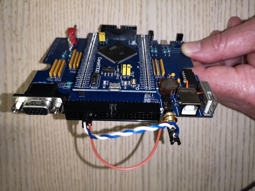

Next, using Peters FFT demo, slightly modified.
Run this program with the audio pins still connected to pin 7 and 8
TJ_PetersFFTdemo_pin78.zip
The hookup I used.  Tip to pin#7, Ring to pin#8, Sleeve (GND) pin#9

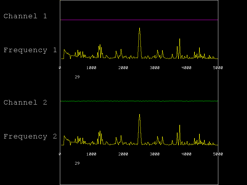

  TassyJim said  Post a coy of your results.
My results file:
I can see the noise on Channel2.  Definitely something is not right.
I did try running the FFT_Demo with the audio cable plugged in in place of the harness connecting to pin7 & pin8 (and ground) and Channel1 and Channel2 both showed the same noise output.
As you can see I have removed the motherboard from the case when carrying out this test (using the original Waveshare, as I am scared of damaging my new one).

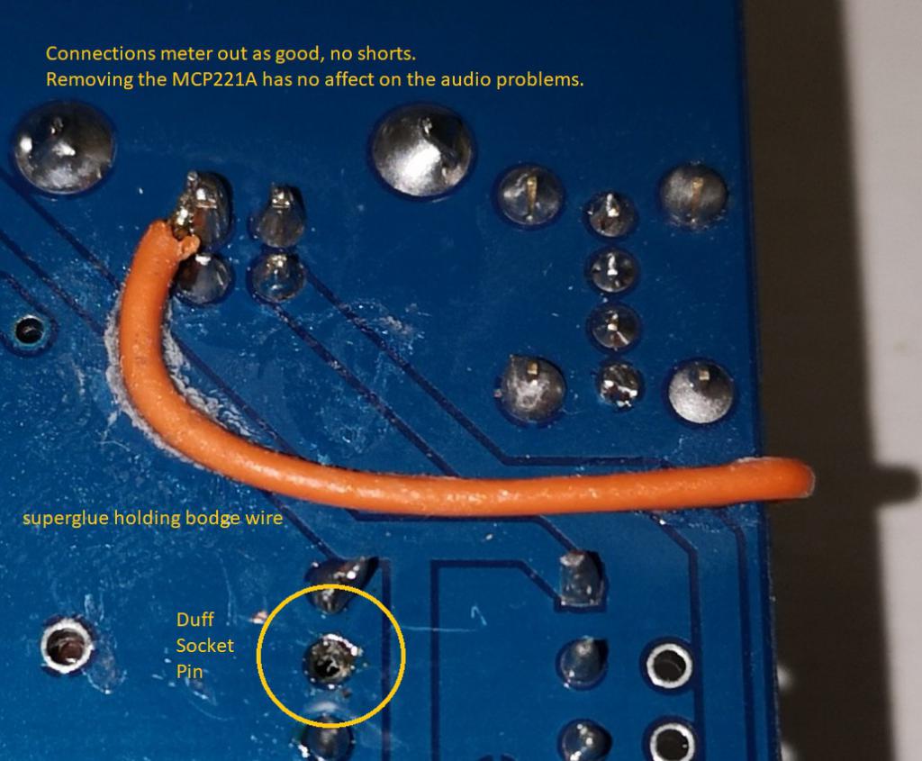

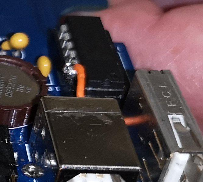

In case the eagle eyed amongst you have spotted this:
I had a problem with the MCP221A socket.  Duff pin.  So soldered a bodge wire direct from there to the appropriate pin on the USB-B connector.  Next time I will use a turned pin socket as these seem to be better quality.  Mea Culpa

I wouldn't be too concerned with the slight ripply in the second channel audio.
The re is a similar, but not as much, ripple in my upper channel and I put that down to quantizing error.
You did say you have noise on both channels and the upper trace is dead flat.
The strength of the frequency buckets is the same as mine so I can't see any reason for your noise.
