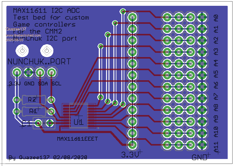

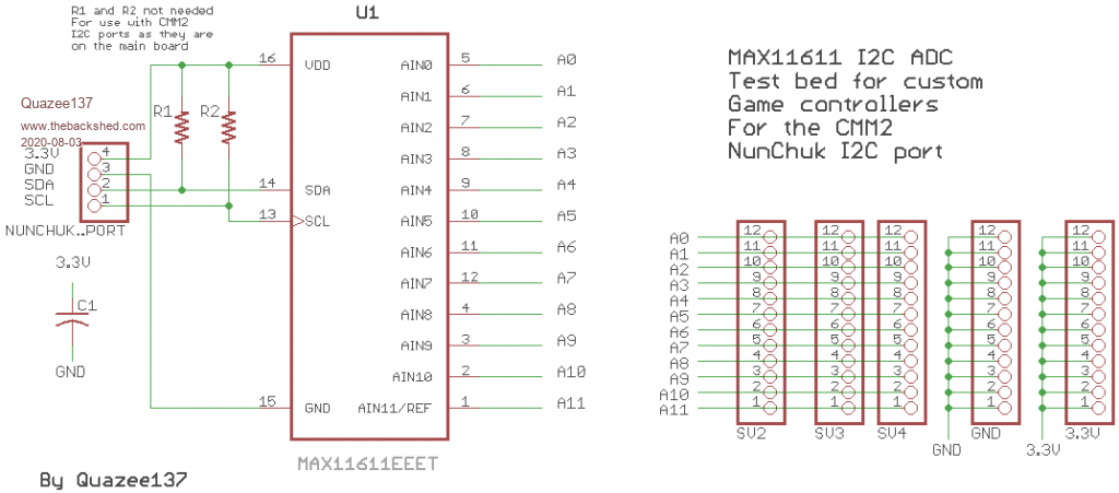

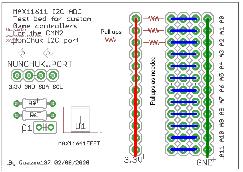

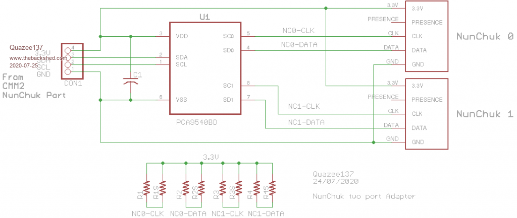

Here is a two port adapter. Both ports will use the same code just need
to tell the PCA9540 which one your talking with.
When I get bit more time again will do one using MAX11611 12 channel ADC.
That is 12 inputs that can be three xyz pots and nine buttons. I think the 1st
run at this one I'll just get the chip and pads so it will be a test base for
any who want to play with it.

Just in case any one wants to play with this. I think the front NunChuk port
 could work doing this with a csub.
 Gamecube Controller Interface

Here is a way to interface most of what every one wants using the front pannel
 Nunchuk I2C.
One though is it could be a csub that is timer driven and maps functions
to AX pin using a controller.ini file using a standard labeling for the
functions i.e Up Down Left Right Joy1 ButtonA  ect ..... I am not much of
game player other than Minecraft using my xbox one controller on Linux Mint.
So this would need to be worked out by TheBackShed's here.
If there is interest I will post gerbers.

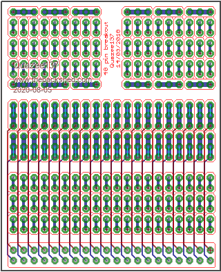

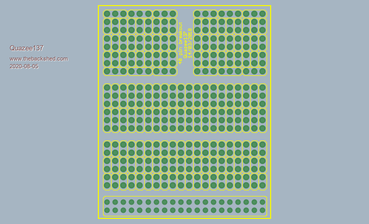

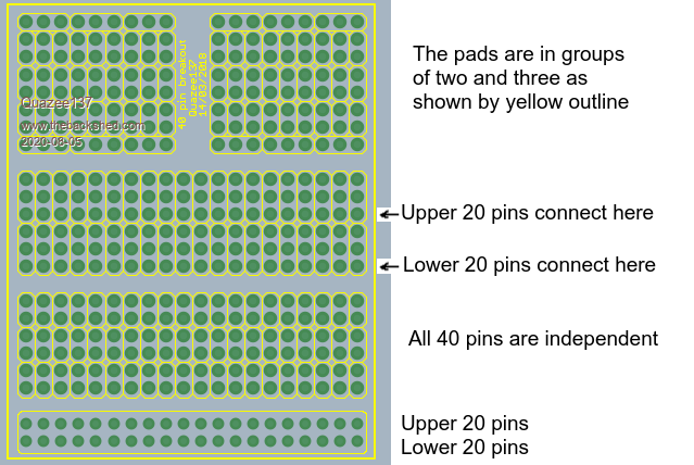

This is from my MM170 HatStand prototypes. Should make it easier for those
 that want to play with the 40 pin port. I had moved in March and just unpacked
 the MM170's and usb with the cad files.
a work sheet
I used theses to interconnect the boards.
40 Pin Breakout.zip
have FUN be SAFE
Quazee137
