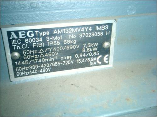

Ok, let's look at it from another point of view using figures taken from the real world. Here is the nameplate data of the 10hp motor, when it was still a motor:
Let's assume a 50Hz system. We get the following figures for that:
in star : U=690V; I=8.9A ; P=7.5kW
in delta: U=400V; I=15.4A; P=7.5kW
From the above, we can deduce that (for one single, disconnected phase, i.e. neither star nor delta) phase voltage = 400V and phase current = 8.9A; then phase 'resistance' (yes, I know, should really be impedance...) becomes 400/8.9= 45 ohm; we will use that phase resistance (45ohm) to verify the next calculations:
We can now calculate the 'source impedance' (rather: sink impedance, in the case of a motor):
in star : R=U/I= 690/8.9 = 77.5 ohm (verification: 45*1.73=77.9ohm)
in delta: R=U/I= 400/15.4 = 26 ohm (verification: 45/1.73=25.9ohm)
The ratio between these two impedances is nearly perfectly 3: 77.5/26=2.97
(note that in the above I assumed that impedance is purely resistive, which of course it isn't; the resistance of one single phase was 1.85ohm for this motor... the rest ( sqrt(77^2-(1.85*1.73)^2) ) is inductive reactance.) But still, I hope you see the main point, how it varies with delta vs. star:

I believe the thing to be conclusively proven by just looking at the nameplate data of any old 3-phase motor... ?
At least, that's how I understand it. But I don't claim to be an expert in 3-phase power calculations. On the contrary. If I'm wrong, please correct me.
