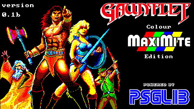

Cover your ears! This time I tried to speak with my (bad) english...
Here is the new Youtube Video about this Gauntlet port.

This is the fixed line:
If tt Mod 2=1 And cef<=sprmax Then Sprite paste cef,xt,yt
The bug was caused because in some circunstances the player can shoot in enemies near other one died one frame before and this can catches a false number upper than the maximum loaded sprites limit.

Why is sprmax=106+32? There are only 106 sprites. Seems excessive... :)
Never mind, I know now. LOL!
It looks like:
If tt Mod 2=1 And cef+32<=sprmax Then Sprite paste cef,xt,yt
might have fixed it.
