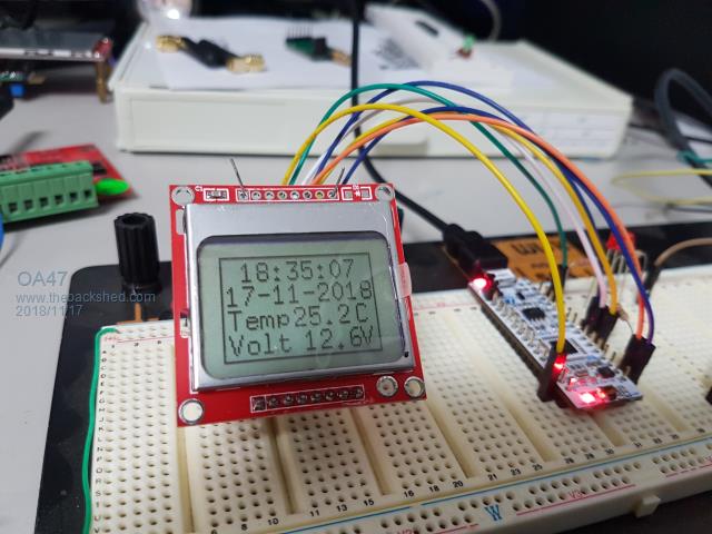

Peter, just to report in, the 5110 display running on the L4. Works a lot better when you re-read your post and realise it is supported on the 2nd port.
I didn't disconnect the LED on the CLK pin 26 and was wondering if you thought it would hinder the operation?

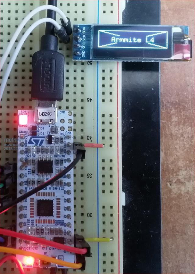

The option list for LCDPANEL SSD1306I2C32 shows a couple of extra characters. Could these be causing the code not to match the if(Option.DISPLAY_TYPE==SSD1306I2C32)
condition.(They are not ## but something shows up. Did not show in the post so I added ## to show where they appear)
option list
OPTION LCDPANEL SSD1306I2C32##, LANDSCAPE
Gerry
F4 H7FotSF4xGT
Posts: 12085
Posted: 01:19pm 17 Nov 2018
  Quote  Could these be causing the code not to match the if(Option.DISPLAY_TYPE==SSD1306I2C32)
Well spotted Corrected here:
2018-11-17_231911_ArmmiteL4.zip
My display just arrived and works with this release
Edited by matherp 2018-11-18

Frank,
I have used OPTION LCDPANEL N5110, L,11,10,9
So my interconnections are
Connection L4 5110 MMBASIC
SPI_CLK (D13) 7 PIN 26
SPI_OUT (D11) 6 PIN 28
DC (A4) 5 PIN 11
RST (A3) 4 PIN 10
CE (A2) 3 PIN 9
GND GND 2
+3V3 3V3 1
Here is the CODE
' Program to test Nokia 5110 LCD on ARMmite L4
' Option LCDPanel N5110,L,11,10,9 set on command line
SetPin 6,AIN
Dim T$, D$, I, Tmp,V
CLS
Box 0,0,83,48
T$=Time$
If T$ <> Time$ Then
D$=Date$
V= 12.6 'Pin(6)/11.1 'resistor divider between Vin and GND
Tmp=25.4 'TEMPR(22)
Text 10,1,T$
Text 2,12,D$
Text 3,23,"Temp"
Text 36,23,Str$(Tmp)
Text 70,23,"C"
Text 3,34,"Volt"
Text 41,34,Str$(V)
Text 72,34,"V"
End If
And if any of the Aussie shedders need a 5110 display quickly, Jaycar stocks them as:
XC4616 64X48 DOT MATRIX @ $19.95
Edited by OA47 2018-11-19

  matherp said   My display just arrived and works with this release
I still have a little mystery with mine.
OPTION LIST displays OK and the fix for attempted printing for x<0 is good.
I could not get it to work without fixme. It turned out I only needed the
I2C OPEN 400,1000
line so the rest of setup is good.
It seems like the SSD3306 driver will use I2C as is, if already open.
I was not using any pullups, so added 10K to 3.3v. This seemed to not make any difference,the driver does not work unless I open the I2C first.
What speed is the driver opening the I2C bus, what value pullups, if any, do you have?
Gerry
F4 H7FotSF4xGT
Posts: 12085
Posted: 08:45am 18 Nov 2018
One more try.
2018-11-18_184313_ArmmiteL4.zip
  Quote  What speed is the driver opening the I2C bus, what value pullups, if any, do you have?
400K, none - the chip applies internal pullups
disco4now
Joined: 18/12/2014
Posts: 1159
Posted: 10:20am 18 Nov 2018
  matherp said   One more try.
Yes that has got it now!
Thank you.

No problem Frank. Here is the code with the DS18B20 and the real Vin.
' File L4TEST.V10
SetPin 13,AIN 'Voltage reading of Vin
SetPin 29,DOUT 'Supply 3V3 to DS18B20
Pin(29)=1
Dim T$, D$, I, Tmp, V
CLS
Box 0,0,83,48
If T$ <> Time$ Then
T$=Time$
D$=Date$
V= Pin(13)*11.0 'resistor divider 100K/10K between Vin and GND
Tmp=TEMPR(22)
Text 10,1,T$
Text 2,12,D$
Text 3,23,"Temp"
Text 37,23,Str$(Tmp)
Text 70,23,"C"
Text 3,34,"Volt"
If V > 10.0 Then
Text 41,34,Str$(V,2,1)
Else
Text 41,34,Str$(V,1,2)
End If
Text 72,34,"V"
End If

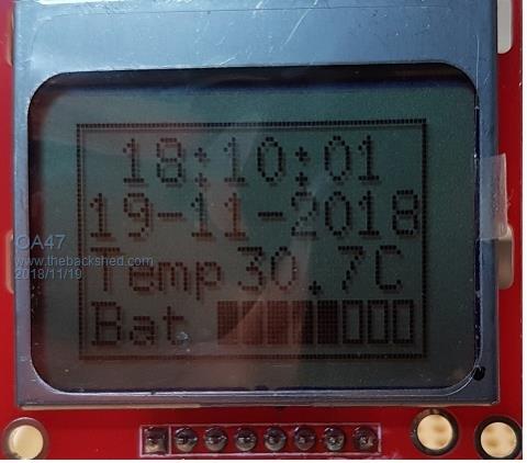

As I intend to battery power this project, I thought the display needed a battery bar-graph. I can post the code snippet if anyone is interested.
