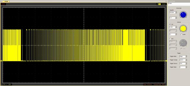

Running "Range20To1000", here's the waveform ... (Remember, this is using Beta 7)
If you comment in and out the various calls to the subs, you'll see there's a variation on the same theme - The worst offender is the "Range20To100".

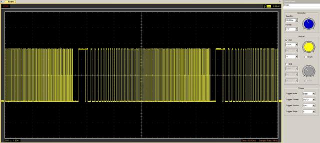

...So, I loaded the code I had running a few days ago, and it certainly wasn't happy either. A very jumpy motor tone and seemed to be running a higher temperature on the motor. I went for a bite to eat and a think and when I came back the motor was sitting on the pad 45 degrees angle to what I left it at, which tells me that there's some serious stepping glitches happening (the momentum of the pulling up a motor makes a tiny jump)
So...... back in with Beta 6 and here's the "Range20To1000" code again.
It's hard to see, but the first picture is a 50m/s timebase and the second is 100m/s timebase yet running the same code.

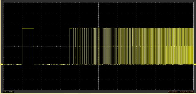

Here's the B6 waveform
The first wide pulse is 2.9mS wide and MAY be a remnant of the 20Hz PWM, but I can't be sure. Each change in errr... 'texture' (where the frequency changes and so the colour changes) corresponds to the 50mS pause value and the frequencies increase by the step value. All good there...

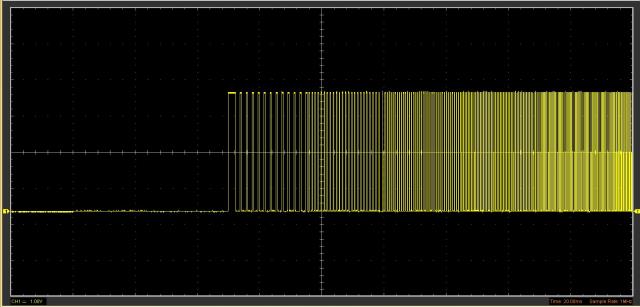

Here's B7 waveform running the same code
Again, the first 2 pulses are probably the 20Hz remnants and the same 'pattern' in both waveform recordings. Also shown is the gap in the 1250Hz

I've been following this thread with interest thinking how it might relate to my ports of MMBasic to the MMX, Picromite and Armmite but thinking about it more today my view FWIW is that using PWM is simply the wrong way to drive a stepper motor.
The essence of driving a stepper motor not just rotation speed but also positioning and it is not realistic to position with PWM. A very simple CFunction could be written that would send out N pulses at frequency F and this could include a command stack that would allow subsequent N/F pairs to be pre-loaded (N could be set to zero to indicate continuous until the next command). This would guarantee both perfect pulses and transitions. Pulse accuracy of < 1uS should be easily achievable.
I've already created a CFunction that does something similar - see this thread and could write something based on this if it would be generally useful. Can you specify the range of pulse frequencies that you would require.
Posts: 3370
Posted: 09:20am 14 Aug 2018
  matherp said  my view FWIW is that using PWM is simply the wrong way to drive a stepper motor.
I believe that you are spot on Peter.
When this started there were a number of flaws in the PWM output that needed fixing (and they are fixed now). But, as I have dived deeper into this it has become obvious that the PIC32 PWM function was never designed to drive steppers. For that you need features like delivering an accurate number of pulses, ramp up/down in speed, etc.
PWM is best left to simulating an analogue output, making simple sounds, etc.
The only problem is that the PIC32 peripherals are not a lot of help in doing the things that a servo would need. So you would need to write some nimble code in the CFunction.
John,
I have gone through some of the traces that I have collected and I can see that break that you are talking about. It is random (which is why I did not spot it before) and quite long (well, a millisecond or two). What causes that I am not sure but unfortunately I have run out of time so I will have to leave it for now.
GeoffEdited by Geoffg 2018-08-15

At the risk of driving everyone crazy with this long running thread a bright idea came into my head as to what might be causing this new gap.
The details are complicated but it could be caused by a PIC32 interrupt occurring at a critical point when the register controlling the frequency is updated. I have built a new beta (Beta 9) which disables all interrupts at this critical time.
As usual this can be downloaded from: http://geoffg.net/micromite.html
Look for "Micromite Firmware V5.04.10 Beta Test Version" at the bottom of the page.
I have checked with the logic analyser and I cannot see any gaps. This does not guarantee anything but hopefully John you can try it on your long suffering servo.
