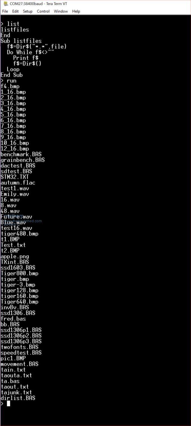

I am also having trouble with SD card reading in a program.
"files" work fine, but if I try to read the SD card from a program using:-
sub Listfiles
f$ = dir$("*.*",file)
do while f$<>""
print f$
f$ = dir$()
loop
end sub
I get nothing.
I have tried replacing "*.*" with "*" still nothing, using 2018-07-05_235923_Armmite which you gave me earlier to fix "strrev".
Trevor
Posts: 12084
Posted: 02:35pm 10 Jul 2018
I have turned the wick up on the SDcard I/F but it is within spec for any card. Suggest you check the electrical connections and add a bulk capacitor as per my note to Jim. Also try a different card. If this becomes an issue I'll include an option to optionally slow the interface.
Edited by matherp 2018-07-12
TrevorH
Joined: 06/04/2018
Posts: 145
Posted: 03:13pm 10 Jul 2018
Thanks for that now works fine.
