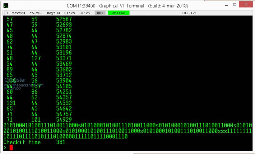

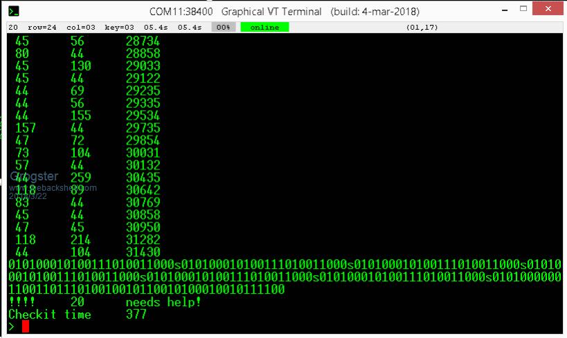

  Quote   ' exp64 decoder
DIM INTEGER tick, tock, period, pulsetime = 50, synctime = pulsetime * 10
DIM code$
DIM pulses(500) ' store all timing intervals for later processing
DIM inSync ' used to signal when sync pulse has been received
DIM pulsecount
DIM firstRun, syncs
DIM validAlarms$(20)
CONST ticker = 49 ' connect PWM output (pin 48) to here
CONST rxPin = 46 ' pin that the receiver output connects to
validAlarms$(1) = "011101010001110000000010"
validAlarms$(
2) = "011101010001110000100010"
validAlarms$(
3) = "011101010001110001100010"
validAlarms$(
4) = "011101010001110000000001"
validAlarms$(
5) = "011101010101110000000010"
validAlarms$(
6) = "011101011101110110100010"
validAlarms$(
7) = "011101011001110001100010"
validAlarms$(
8) = "011101011001110000000010"
validAlarms$(
9) = "011101011111110000000010"
validAlarms$(
10) = "011101000001110000100010"
validAlarms$(
11) = "011101100001110001100010"
validAlarms$(
12) = "011101010001110001000001"
validAlarms$(
13) = "010101010001110000000010"
validAlarms$(
14) = "011001010001110000100010"
validAlarms$(
15) = "011011010001110001100010"
validAlarms$(
16) = "011101010001110100000001"
validAlarms$(
17) = "011101010001111100000010"
validAlarms$(
18) = "011101010001101000100010"
validAlarms$(
19) = "011101010001000001100010"
validAlarms$(
20) = "011101010000110000000001"
PWM 1, 100000, 50 ' this is out high resolution timer whch gets connected to ticker pin
SETPIN ticker, CIN
SETPIN rxPin, INTB, blip ' triggers on a high or low transition
tock = PIN(ticker)
SETTICK 3000, checkit
DO
' IF INKEY$<>"" THEN
' decode
' ENDIF
LOOP
END
SUB blip
tick =
PIN(ticker)
IF inSync = 0 THEN
IF (tick - tock) > synctime AND PIN(rxPin) = 1 THEN' long enough to have been sync pulse
inSync = 1
pulsecount =
0
pulses(pulsecount) = tick - tock
ENDIF
ELSE
pulsecount = pulsecount +
1
IF pulsecount > 400 THEN
inSync =
0
pulsecount =
0
'print "overflow"
ENDIF
ENDIF
tock = tick
END SUB
SUB checkit
LOCAL n, t
t =
TIMER
decode
FOR n = 1 TO 20
IF validAlarms$(n)<>"" THEN
IF INSTR(code$,"s"+validAlarms$(n))>0 THEN ' we have lift off!!
PRINT "!!!! ",n, " needs help!"
ENDIF
ENDIF
NEXT n
PRINT "Checkit time ",TIMER - t
END SUB
SUB decode
LOCAL n, pulsetimes
code$ =
' check every second timing
PRINT pulses(0) 'DEBUG
pulsetimes = 0 'DEBUG
FOR n = 1 TO 400 STEP 2
pulsetimes = pulsetimes + pulses(n)+pulses(n+
1) 'DEBUG
PRINT pulses(n), pulses(n+1), pulsetimes 'DEBUG
IF pulses(n) > synctime OR pulses(n+1) > synctime THEN ' a sync pulse
code$ = code$ + "s"
ELSEIF (pulses(n) + pulses(n+1)) = 0 THEN ' all done
EXIT FOR
ELSEIF pulses(n+1) = 0 AND pulses(n) < pulsetime THEN ' final transition
code$ = code$ + "0"
ELSEIF pulses(n) > pulses(n+1) THEN
code$ = code$ +
"1"
ELSE
code$ = code$ +
"0"
ENDIF
NEXT n
PRINT code$ 'DEBUG
inSync = 0
syncs =
0
pulsecount =
0
FOR n = 1 TO 400
pulses(n) =
0
NEXT n
END SUB
How it works.

Finally had a chance to play with this. Sorry for the delay. It appears to be working with my test transmitter unit: (E64 1C, MMBASIC 5.04.08, default speed(100MHz))
First image is just me running the code, 2nd image is with me putting the transmitter code into slot #20, which then does respond.
So, this is the first actual test with the actual transmitter and not just with a simulator, but they seem to agree.
Anything else you would like me to try?

Posted: 01:51am 22 Mar 2018
That is very promising.
It shows that my timing was close to the real thing.
The next big thing is to get access to the WAKEB pin on the IC and use it as an interrupt to configure the main data interrupt. I would set the data interrupt ON when you have RF and OFF when it stops. That should prevent any overwriting.
