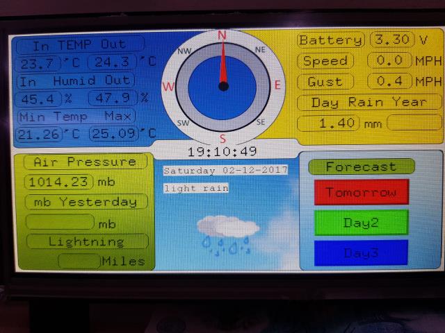

lew247
Joined: 23/12/2015
Posts: 1709
Posted: 07:13pm 02 Dec 2017
The result of all the above - now showing the correct weather icon and description for today (and the rest of the days once programmed)
