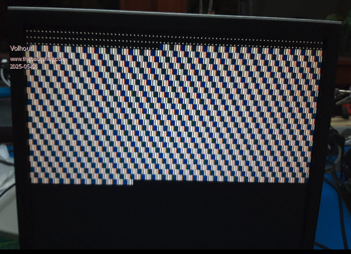

RC22 on genuine RP2040 VGA design 2 with WII Classic connected to GP14/GP15.
Just opening the WII classic, and then printing 1 dot on the screen every 100ms.
In this picture the pico is dead and needs power cycling to revive.
It is not fixed. Sorry.

  Quote  It is not fixed. Sorry.
I've just run for 3 hours without issue so I'm happy it is now OK and then anything else is probably electrical. I don't intend to look at if further.

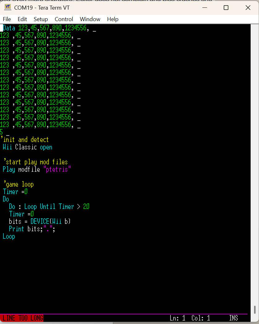

Posts: 12059
Posted: 07:39am 06 May 2025
'#!A:\test.bas
This is a bug I need to fix. Let me explain. When you load a file from disk the load program prepends the file with a comment line starting '#
This allows the system to know the origin of the file so the MM.INFO(PATH) function can be used to create source relative filenames for resources needed (e.g. music files)
  Quote  Returns the path of the current program or NONE if called after a NEW or
EDIT Command.
This should be stripped out when editing and not shown when listing but I seem to have broken something in this functionality when working on paging with line breaks. I'll try and get this sorted in the next release.
  Quote  I took the broken code added some lines and went back to the line and added even more charaters. Editor does not complain and pico crashes and cuts lines I added
Did you update to RC22? This was an issue in the first version of the continuation code but was supposed to be fixed in RC22.
See image of the editor when I press F1 or F2
Note though, without continuation lines it is perfectly possible to break the editor by using the manual trick for creating long lines to make on > 255 characters and in this case the extra length is picked up by the code that saves the file to flash and truncates the save at that point losing data - this has always been the case.
What is the consensus on having a mandatory space before the continuation character?
Edited 2025-05-06 18:12 by matherp

Posted: 08:01am 06 May 2025
I updated to RC22. If the line is longer than 255 by extending the line while end is > hres , editor does not complain and it happens as before

Posts: 12059
Posted: 08:14am 06 May 2025
  Quote  I updated to RC22. If the line is longer than 255 by extending the line while end is > hres , editor does not complain and it happens as before
without continuation lines it is perfectly possible to break the editor by using the manual trick for creating long lines to make one > 255 characters and in this case the extra length is picked up by the code that saves the file to flash and truncates the save at that point losing data - this has always been the case.
I can probably use the new continuation line code to check this now.
Edited 2025-05-06 18:18 by matherp

I like having a space before the "_".
The next question is, will MMBasic add the space every time (and remove it afterwards), even if there is a space character present already.
That would make reversing the line continuation easier.
But then what happens to the space which is added when manually using line continuation?
The user would have to be sure that loosing the space does not cause grief.
