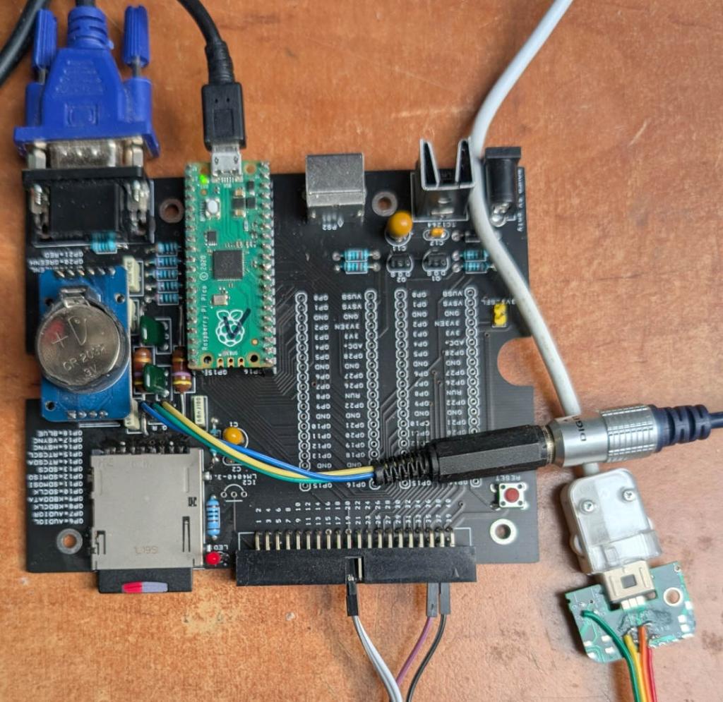

@Peter,
I can also duplicate it on the VGA design 2. Connecting the WII classic to GP14/GP15, with the RTC placed and using V6.00.02RC21.
It only takes more time. In all cases, the screen is filled with dots (the code prints these), and the final character before the crash is always en "E", not a dot.

Posts: 12068
Posted: 03:56pm 05 May 2025
I've been testing this to destruction and I'm beginning to believe it is a bug in the Pico SDK I2C routines.
When you finally get a readable error message it says that a function isn't found which is clearly part of the source.
Neither the system stack not the user heap are showing any issues.
The next step is to try recoding the I2C routines using the bitbang versions and see what happens.......
