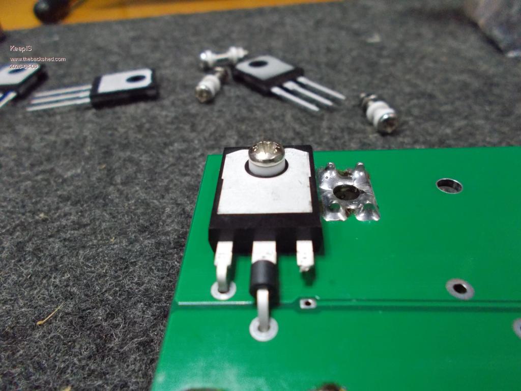

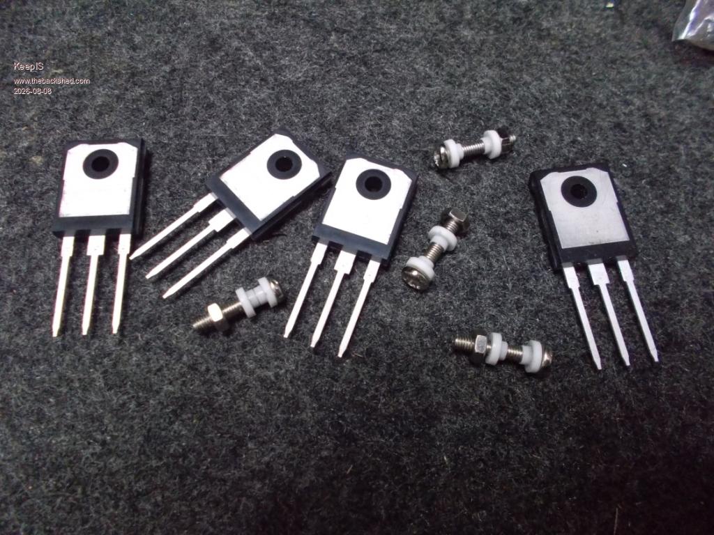

Remember this part of the New WG inverter build thread is for those builders new to electronics and inverter building.

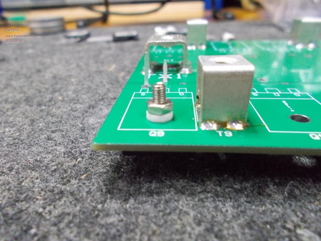

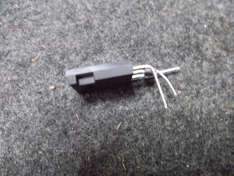

Below: Some of the the FET hardware, like the bolt and white "top / shaft" insulator washers that we use here to centre the FET body correctly over the PCB while soldering.
Below: Try to have a gentle bend in the FET Legs, instead of a right angle, there are proven reasons to do this. I will not be discussing those here, look it up!!
Below: A view of the White insulating (locating as well) washer on one side of the FET.
Below: The washer on the other side of the PCB.
Below: Ready to solder, gate lead will be trimmed neatly later, flip the board over and start soldering the TOP side of the board first.

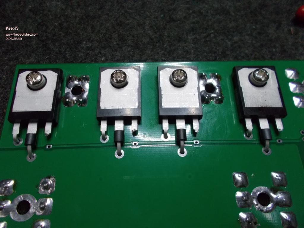

I mount 4 FETS at a time as they share a common copper track, and soldering four FETS in close proximity helps heats the wide track, when the TOP is done, flip the board over and finish the Bottom.
Someone asked how long it took to heat the solder pad for the first leg, I was incorrect, it only takes 4 seconds to have the solder flow over the pad and migrate down the FET leg through the board, each one is progressively faster as the whole track heats. If you are doing this in a freezing room, use a heat gun to GENTLY heat the board first, I did not and it's 19°c in the room.
As stated earlier, solder the FET leads on the TOP of the PCB first, flat tip on the pad first, when solder flows on the pad, move the tip against the FET lead for a second or two as you feed a little solder, this normally flows through to the pad on the other side, once you get used to it's very quick to solder each leg.

  KeepIS said  70 watt temp controlled 480°, around 10 seconds to flow, you always solder the underside first, minimising heat transfer through the FET leads by heating the PCB first, before sliding the tip against the FET lead and allowing the solder to flow through, flip the board and heat the PCB next to the lead, solder melts quickly, minimising heat flow through the FET lead, have done this for every inverter board I have built.
"you always solder the underside first" is WRONG
SHOULD read always solder the TOP side (component and Terminal side) of the PCB first. when soldering the FETS.
Thanks for the tips.
Interesting ... I always soldered the underside first
Also, I must admit I never tried 480C because that's the limit of my 70W iron and it became uncomfortably warm to hold even at 380C after more than a few minutes.

I use a HACO, slim iron and handle, absolutely zero heat in the handle.
Heat transfer into the FET body through the Via and FET leads is minimal when soldered from the TOP first, especially if you focus on the Via PAD, when the solder flows, it obviously heats the FET lead, however the heat on the FET Body connection on the bottom of the board is still relatively cool, the real heat transfer happens when you solder the bottom side of the board.
I now solder one lead on each of the four FETs I fit, then go back and do the other lead, minimising heat transfer into each FET, then flip the board, by this time the bottom side of the board is quite warm, repeat the one lead at a time solder finish off on the 4 FETS, again trying to focus on only heating the PAD without the TIP pressing against the Lead.
I'm sure you and other forum members are aware of the following, but I'll post this for newer builders. I'm also sure other forum Tec members have their own method, but again, I'm just trying to keep this simple and low cost for new builders.
Two very important points. 1: the correct "clean" tip, 2: using Tip Tinner or similar product.
I give the Tip a gently quick wipe on a damp solder sponge, then touch the TIP on the Tip Tinner, the Tip remains bright and clean, the heat transfer is a "WORLD of Difference" compared to not doing something like this, and especially so with high Tip temperatures.

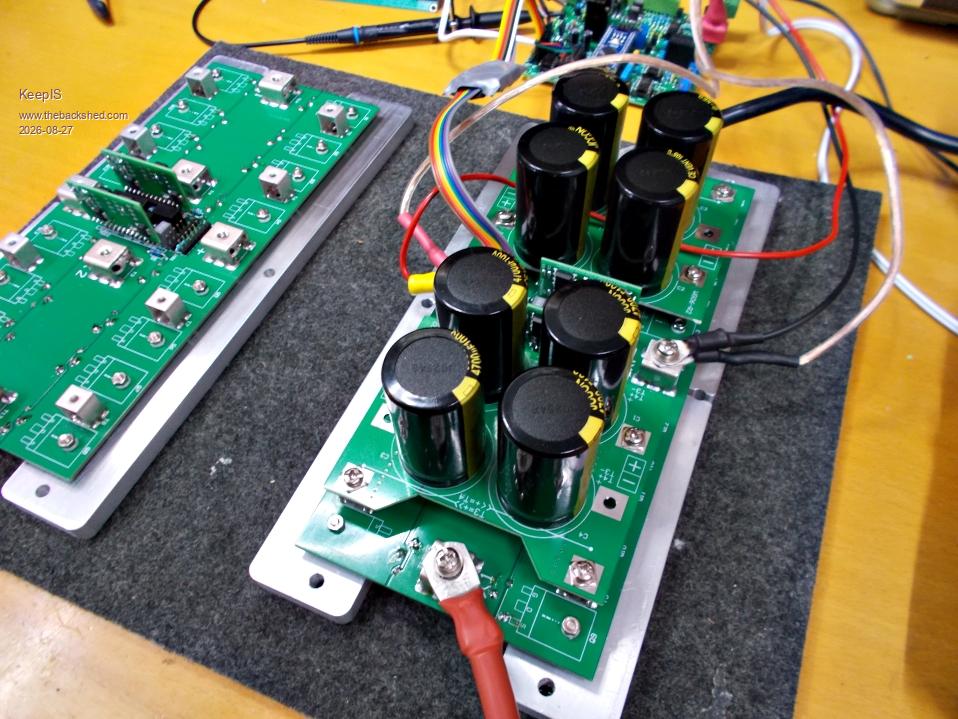

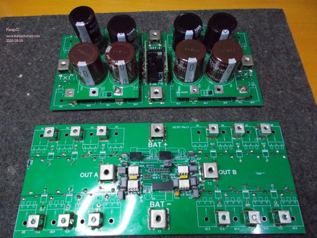

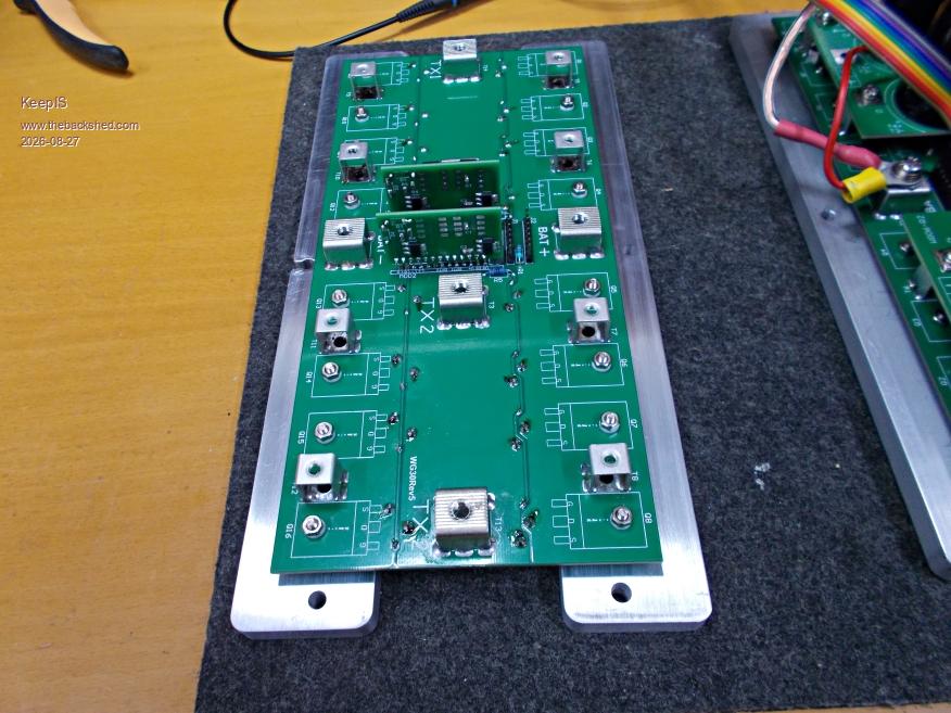

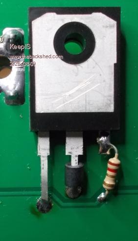

A Gate resistor, there is one on each FET, this is straight after fitting the FET, no board cleanup, and later a drop of silicone rubber will keep the ferrite Bead close to the body and stop it moving around.

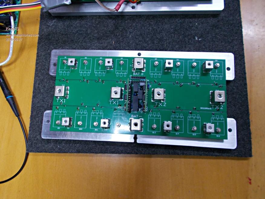

Below: The difference between the old and new Power board, it looks quite small with the Test Cap boards fitted, I tested both new power boards this morning, and both worked perfectly.

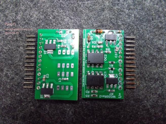

Here is slightly better picture of the two gate drive boards, showing the top and bottom, layout, once again, notice that the right-angle pin sets are are mounted on different sides of each board. As both boards are identical, simply make sure that one board has the pin-set pushed through from the top, and the other from the bottom.
Excuse my poor attempt of soldering SMD, the problem is, as you get older your hands decide to have a mind of their own, right at the last moment of placement, or when trying to hold a part the size of a flea, and jumps like one if you look sideways.
Although I do have a special hot air solder gun for occasional SMD stuff, I am not set up for SMD work, and I have no intention of spending any money on it for the little I do, but with these tiny boards it was easier for me to just use solder paste and a tiny solder tip.
BTW despite C3 being skewed, I decided to leave it, it was physically fine the way it was, and like the other 2 sets of boards, these also worked perfectly the first time.

A couple of notes on the Power board components, very minor really:
And I might be using an older BOM? Mine is WG30Rev5 issue 010626.
1: C4 in the BOM is shown correctly on the Assembly overlay.
However on the Power board - WG30Rev5, it's marked as C9, which was the old location reference from the previous board.
2: Gate Drive WG50 Rev 1 - same BOM above.
The BOM lists the two Zener Diodes as D5 and D6, howeve, the WG30 PCB and Assembly overlay list these correctly as D1 and D2.
On another note, my HY5608W parts bin has taken a hit to the tune of 48 FETs

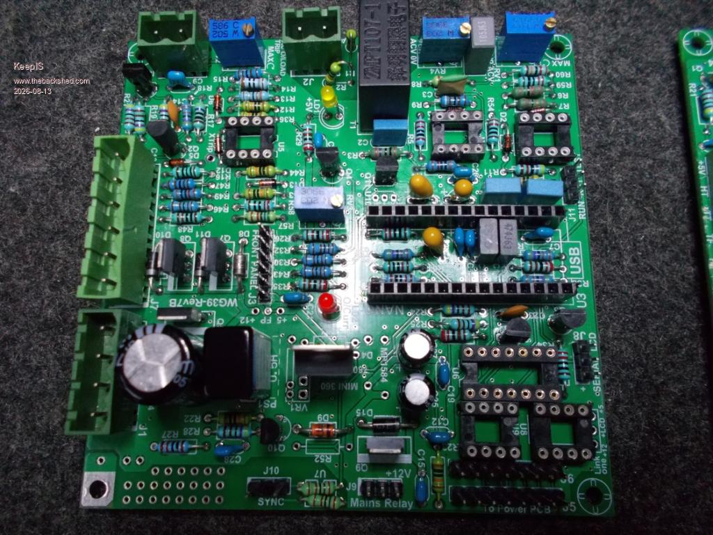

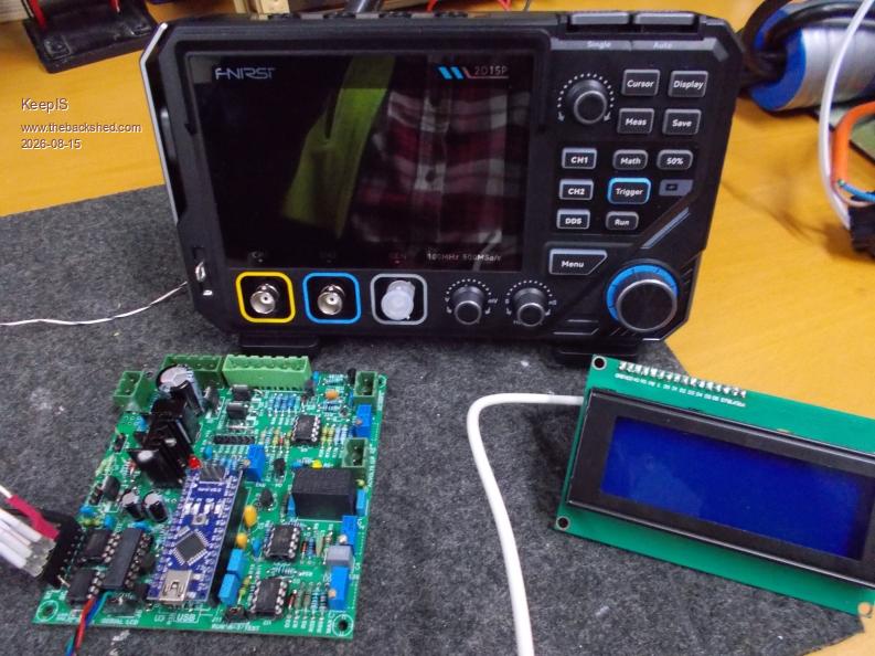

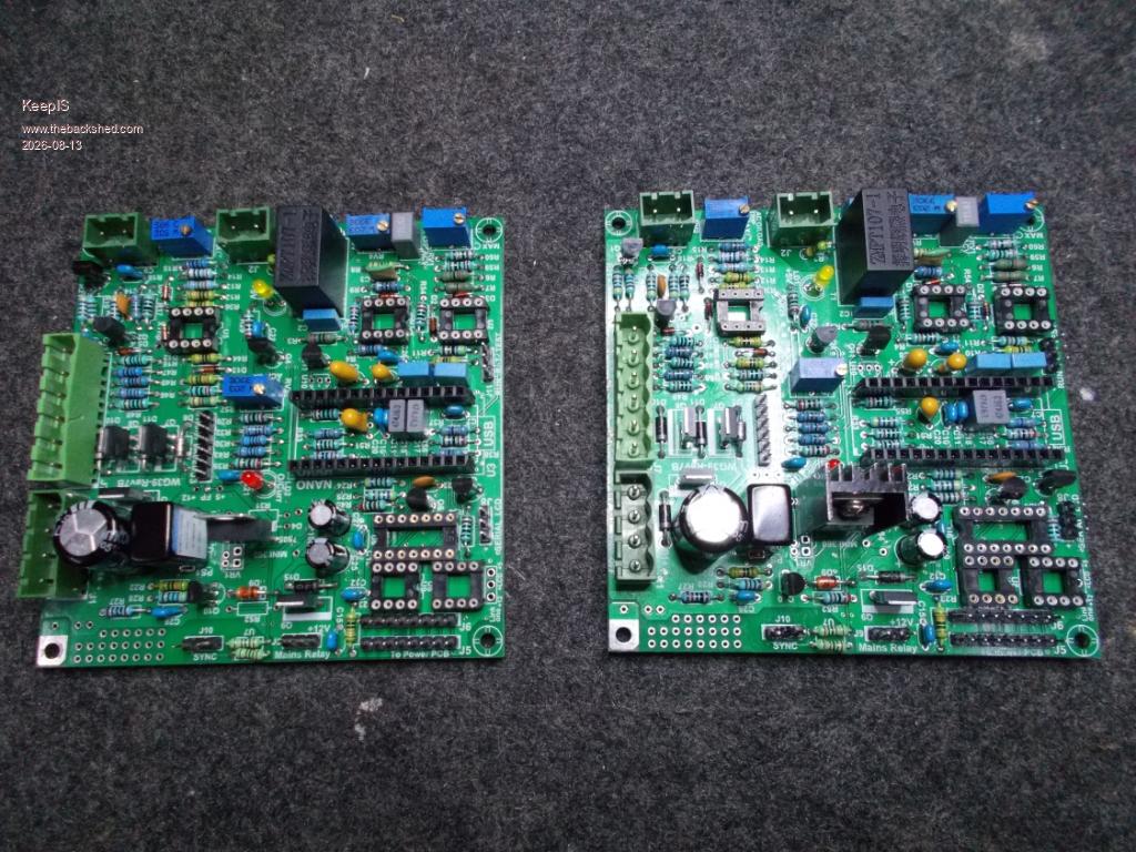

Just finished testing the Controller board, actually two of them, I decided to builds two at once, it actually saves a huge amount of time, both worked perfectly with the test Inverter setup driving one of the new power boards and the new LCD.
Obviously, I threw together the revised LCD module with its 5V Regulator and set the controller LCD supply link to 12V, a very nice addition. So that's all the new revision boards working together in a test Inverter.
I took a pix of the controllers in almost finished state, a resistor and a link to go.

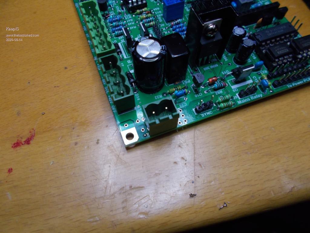

For anyone who is suffering with early onset stupid, and you mount one of the big green sockets back to front, you don't have to un-solder it, just get head gun with a small nozzle and heat the inside of the socket for a bit, you can pry / lift the housing off the pins, turn it around and push it back on, the socket is still perfect in every way and no board damage.
Footnote added 2026-08-14 11:34 by KeepIS
For anyone who is suffering with early onset stupid -- I was referring to myself, as this is exactly what I did, put the sockets around the wrong way, both of them.

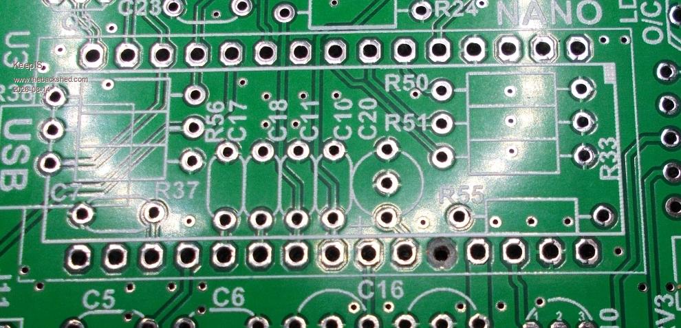

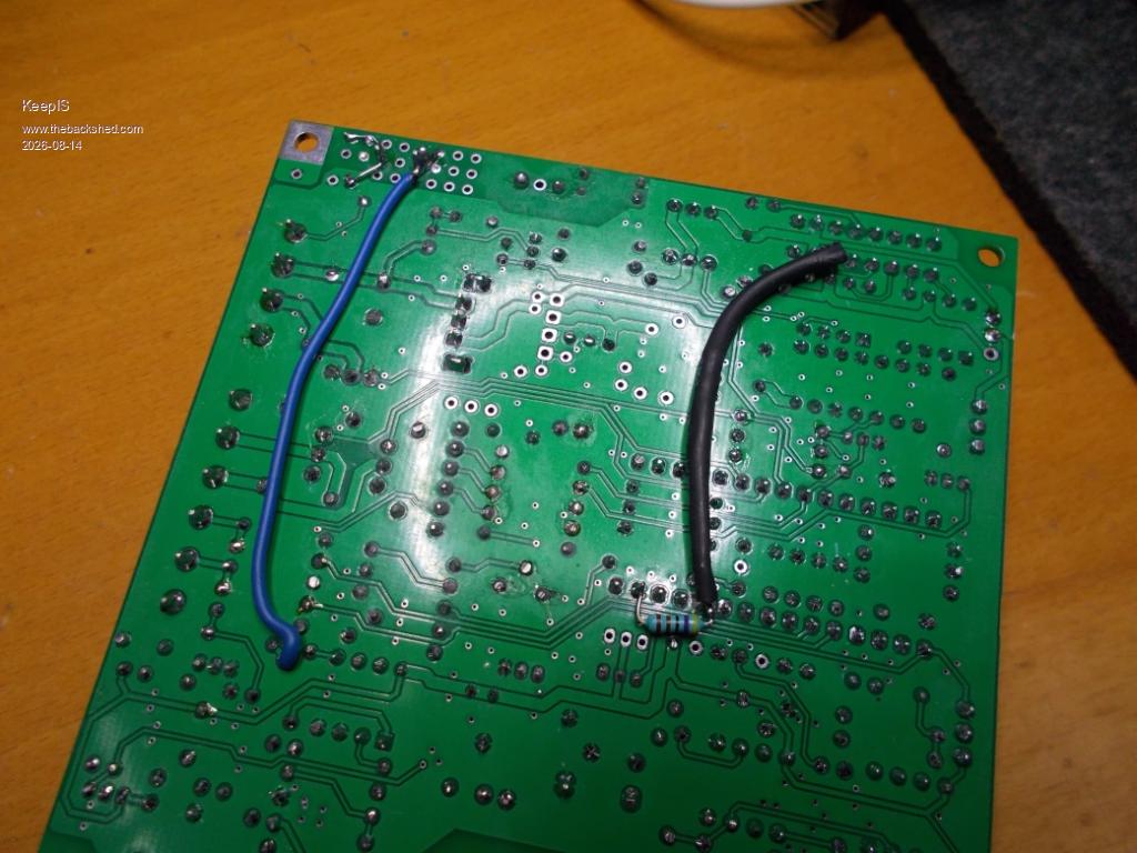

The following is a modification to the controller board for those who want to utilise the unused ADC channel on the Nano, which is pin 26 (A7) of the Nano socket, this pin is currently tied to ground.
This is mainly for anyone building a Dual Inverter and wishing to use my Dual Inverter code, it will also work for the single Inv code, but will simply display the voltage on the input.
NOTE: This is optional, a Dual Inverter can use the single inverter code without this modification. I simple use this input to independently monitor the CAP voltages on each power board for any wiring fault condition.
This modification also allows you to use A7 on the Single Inverter code, where the code auto senses a voltage above 10 volts on Pin-6 of J5/J6 (A7) and displays the voltage on the LCD.
As Pin-26 (A7) is tied to ground on the controller, I use a 3mm drill, hold it in your fingers and place it the PCB hole for Pin-26 (A7), twist it few times, the drill bit will remove the PCB bridges around the hole as shown below (near R55). Do the same for the other side of the PCB.
When installed, the protruding Nano socket Pin will allow you to solder a 4k7 resistor from Pin-26 (A7) to Pin-29 (GND), and a 100k resistor from Pin-26 to Pin-6 on J5/J6, these two resistors form a voltage divider for ADC Input A7.
Pin 6 of J5 and J6 are already bridged on the PCB and now become the input for the unused Nano ADC channel A7. This input can measure voltages between 10 and 60V.

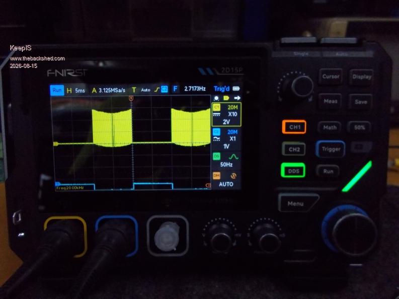

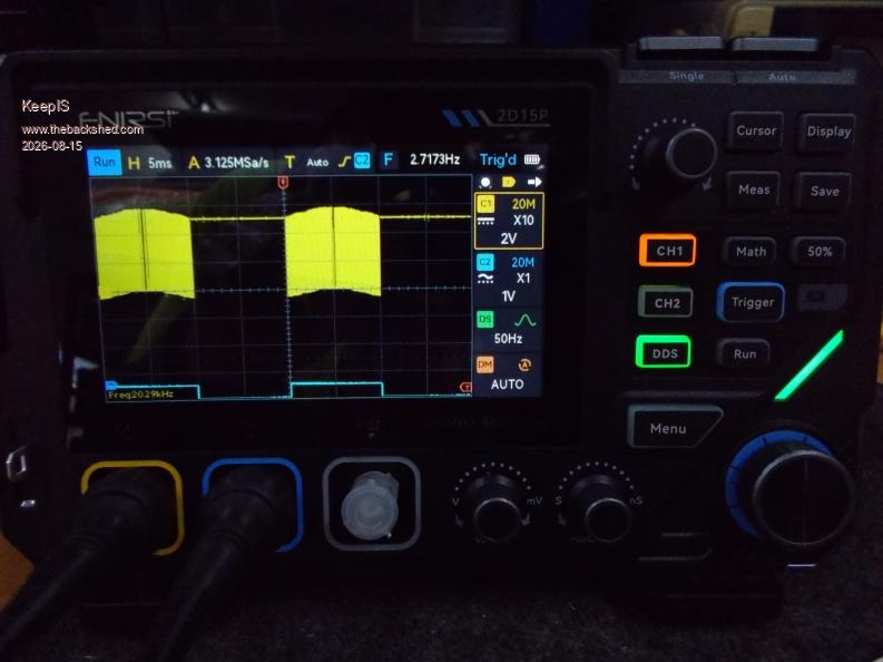

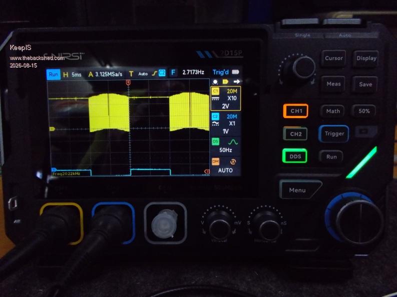

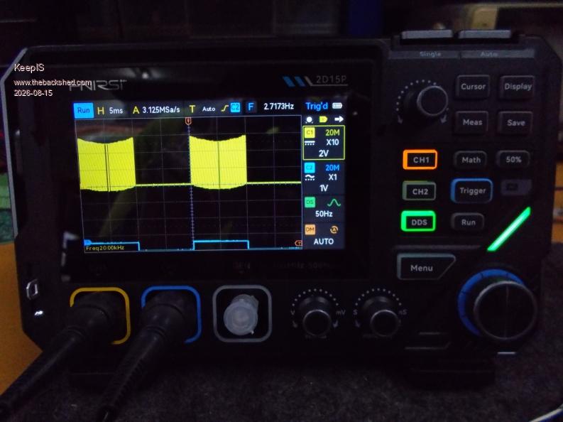

A few pictures of the output from the Nano Controller using in a small lower cost portable DSO/Digital multi meter.
Wiseguy has a test procedure for the controller for setup and voltage measurements etc, however the following will give you an idea of the output from a two channel DSO with no external Sync input.
For those new to this, the Nano Inverter was originally built with the possibility of being able to Synchronise (Sync) the Nano Inverter to the Mains AC frequency. Short answer is that for a straight Inverter, this is not needed. If you want to argue that, please start a separate thread!!
Set the Nano controller to Test mode with link J11.
The Sync is now an output signal to Synchronise the DSO Time-Base, and make the Waveform display stable and locked around zero crossing. For those new to this, we can expand the setup of the DSO for measuring this output in the future.
With the Nano controller powered from a current limited bench supply, set to around 150mA and 13Vdc, these are the wave forms you should see on J6 or J5, which are paralleled 8 pin headers on the Nano controller.
For those of you not sure how to quickly set the Current limit on an adjustable supply, simply set the output voltage to around 300mV, turn the current limit Fine and Course controls to zero, short the output leads together, adjust the Fine control to 150mA, that's it. The Nano Controller should not draw more than 110mA at 13V, with only power and the LCD connected.
The first photo is a basic test jig breakout. This allows you to safely and quickly look at the Opto (Opto Coupler) output signals:  1LO (pin1), 1HO (pin2), 2LO (pin 3), 2HO (pin 4).
The Jig ensures that you do not accidentally short the +12V Bias output (Pin 7) to one of the Opto outputs, this could damage the Optos, and the protection Diode D9 will usually (hopefully) short.
The code I wrote will also need to see the Inv CapV on pin 5, and 6 if modified for ADC use.
The Jig is simple, wire up a 8 pin plug to something like a small terminal block so that the 4 Opto outputs cannot short together or to 12V. wire pins 1, 2, 3, 4, plus pin 8 for ground to the terminal block.. Now solder pins 5 an 6 together and to a short lead with a 1kΩ resistor in series, this lead connects to +13V input from the Bench Supply, and makes CapV happy in both Dual and Single Inv code.
The following are dark photos to enable the capture of the screen with the Camera.
Yellow Wave forms are the outputs on Channel 1.
Blue Sync output, moved to the bottom of the screen on Channel 2.
Sync input is set to Channel 2.
The Outputs: Notice the Horizontal position between the 1HO-1LO and 2HO-2LO wave forms, you should see the same screens displays.
Pin-1 1LO:
Pin-2 1HO:
Pin-3 2LO:
Pin-4 2HO:

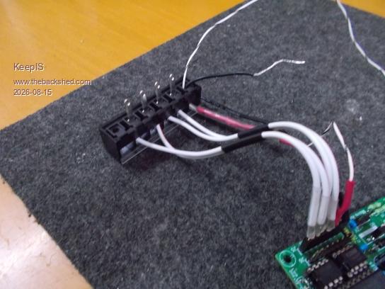

My own thoughts on using the sync output supplied by the Nano controller, used to trigger a DSO for accurate waveform capture and timing, touched on in the previous post.
As U7 is not used in the Controller and is usually left blank. I place a 470Ω across the pins closest to the edge of the PCB, the ground pins to J10 (Sync Out), which would be pins 2 and 3 of the U7 outline on the PCB, and a 1kΩ across pins 1 and 4. The 1kΩ is to offer a little protection to the Sync output pin of the Nano, the 470 ohm is an attempt to save the DSO probe leads, grounds and internal earth circuity, and also the Power board and Controller circuity when syncing a DSO and forgetting that the Probe Earth connections on a DSO are common, and that one is already connected to the trigger input, and you forget and place the earth connection of a second probe onto a point with a high DC voltage potential, like the Power board rail or choke terminal, it's easy to do.
The 470Ω resistor will, at the very least, eliminate a full short circuit via the DSO probe earth circuity, hopefully one realises they have screwed up before the resistor sends you a smoke signal, although the joyous sounds of a FET popping a champagne cork in celebration, might just grab your attention first.
I also remove the unused centre pin on J10, making it easier to connect a DSO lead without shorting it.
EDIT: And before someone chimes in, yes, I know, that's also another reason to use differential probes, which I do but this is for new builders and those new to using a DSO, just pointing out a few of the little gotchas that can catch you out, and most decent Diff probes cost more that the little DSO.

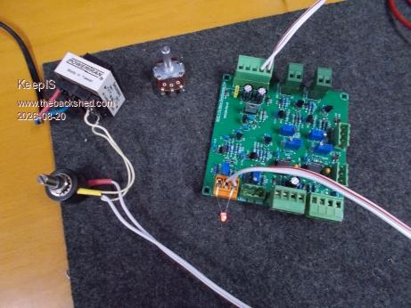

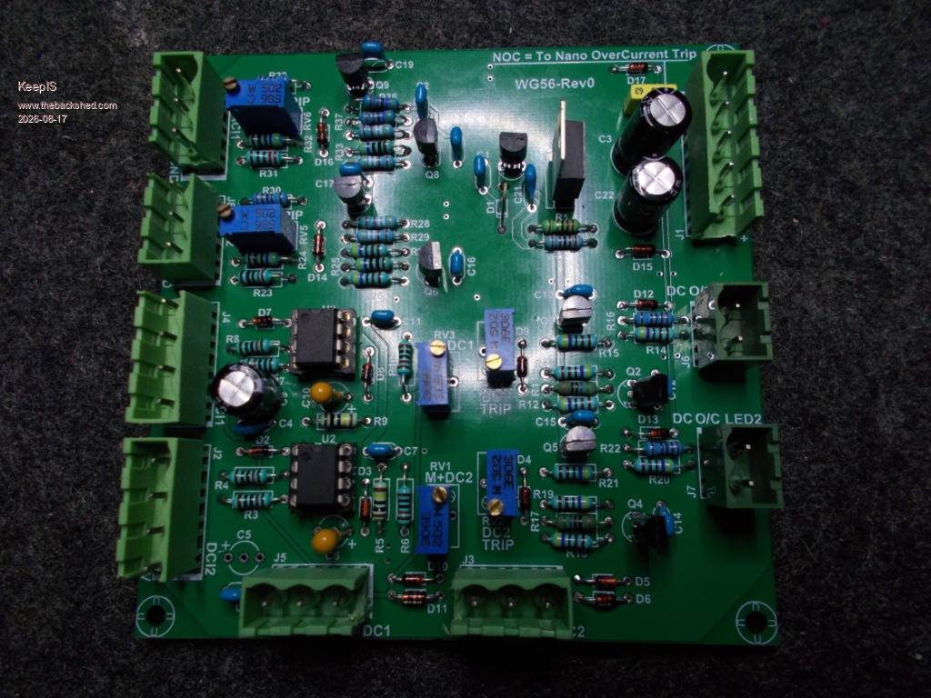

The OCS "Over current Supervisor":
Wiseguy will be pleased now that I have finally got around to building the OCS and checking it, both resets work, all LEDs, Peak Meter function if you choose to use it, and the DSO output for monitoring and checking of DC current wave forms, this is a really nice board, FYI it's the same size as the Controller PCB.
It works perfectly, all I have to do now is to calibrate the AC trip points.
Setting DC trip point is simple, as the DC Current sensor outputs a voltage proportional to the sensor current, place a voltage on the Sensor input terminal that equals the Sensor out voltage for the Current the Inverter DC Input should trip at, adjust preset pot until the OC LED lights (trips), reset the OSB and recheck for correct trip point, done.
So that's 2 OCS boards, 3 Power boards, 6 Gate Drive PCBs, 2 Nano Controllers and 1 LCD board built and tested.
Edited 2026-08-17 13:13 by KeepIS
KeepIS
Joined: 13/10/2014
Posts: 2284
Posted: 06:41am 18 Aug 2026

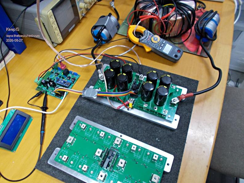

Mucking around AC OC calibration and the TLS76L1 current transformer and verifying the output:
The data for the TLS76L1 is with a 200Ω load R shown in the graph, where as the value I have on the OCS PCB is 220Ω, there appears to be almost no difference in output voltage up there, and as we are tripping way below 100A, this not only appears to work fine, but it works perfectly in the Inverters I have built.
It appears to me that the TLS76 outputs 8v@100A at 200Ω.
To start with, I had an old smaller Toroid with 240Vac and 38Vac windings. I fed a Variac into the 240Vac winding and used the 38Vac winding across a 2Ω 50w resistor.
With the TLS76 on the output cable, I had around 80mVrms @ 1Arms  and 400mV @ 5Arms, there is around 25mV of noise with no AC input, so I deducted that to arrive at the above figures.
Obviously the TLS76 is connected to the OCS board and the board is powered in these tests.
I'm using a RIGOL 5.5 digit meter to measure the AC voltage across the TLS76 and another bench DVM to measure the AC voltage across the 2Ω current shunt.
80mV @ 1A across the TLS76 with a single turn, 800mV with 10 turns through the TLS76 which is 10A.
As an example, I want to set the AC current limit at around 37A.
So with 7.5Vrms across the 2Ω shunt, there is 3.75Arms * 10 (10 turns) = 37.5rms
A quick calc shows 37.5A should give roughly 3Vac across the TLS76, the voltage measured was 3.001Vac.
After calibrating both AC OC channels on each of the OCS boards I made, I then used a signal generator with an output capacity of nearly 10Vac, set it 2.98V @ 50Hz and connected it to the OCS input in place of the TLS76.
A DVM is connected across the output of the Generator as it will be loaded by the 220Ω on the OCS board, when the output hit 3Vac it tripped the OC on both boards.
Basically I can set the Current value pretty close by scaling that 100A @ 8v @ 200Ω output spec.
You could possibly use a small 240vac to 12vac or 6vac transformer with a resistive divider to supply the correct 50Hz AC voltage.

On the subject of the Over current PCB and how it relates various Inverter builds, I thought I would add a bit more context.
The OCS PCB has 2 AC current trip circuits, 2 DC current Trip circuits and a 12V to 5V regulator, it has LEDs that latch on when an over current event occurs, the LEDs indicate which OC event tripped the Inverter.
If you are building a basic standard single toroid Inverter, one that will not see heavy induction loads etc, then you likely don't need to use the DC input current monitor, as the NANO controller has an AC over current trip built in, you won't need the OCS PCB.
If you are planning to build a single toroid off-grid Inverter, one that is critical to supplying your AC power needs, then you should consider using one of the DC over current trip circuits on the OCS PCB, again, you don't need the AC trips on the OCS as there is one on the NANO controller, however the OCS can also:
1: Indicate separately, an AC output or DC input OC trip event, useful when trying to pin down a bad load or possible fault condition.
2: The OCS gives you a DC current output voltage to connect to a DSO, this can tell you a lot about how the Inverter is handling the AC Loads, especially if something is giving you a problem and tripping the Inverter, and finally you can plug in and calibrate a simple low cost analogue panel meter to continuously monitor the peak input currents of all appliances and loads on the Inverter.
If you are planning to start with a single toroid inverter, and want the option to add another toroid and Power board, thereby doubling the Inverters power output, then with a completely populated OCS PCB, everything is ready for that.
In a Dual Inverter the OCS also does the following:
1: Indicate which toroid and power board tripped the Inverter, and if it was an AC or DC trip.
2: Compare the DC input current precisely between the two Toroids, especially on very high current surges and loads.
3: Makes it very simple to fault find and to replace the NANO Controller PCB, as nothing needs to be adjusted on the replacement NANO controller.
4: Add 2 analogue panel meters, and you have full time monitoring of the currents in each Power stage and Toroid, one glance tells you if anything is off. These will show instantaneous peak DC currents in the Inverter, like a big induction motor powering up, no need to hook up a DSO just to see them.
Hopefully I have not confused anyone

There is a very simple way to make an adjustable AC source to set the AC Trip points.
Using a small 240vac to 6V AC or 12V AC (output) plug pack, or a small transformer, either only need to be rated at around 50mA to 100mA.
Solder a 1kΩ Linear (B curve) POT (variable resistor) across the AC output of the plug pack, solder a lead to the centre tag of the POT, and one to one end of the POT, put the other ends of those leads into a plug to suit the AC over current trip Input on the PCB, where the TLS76 normally connects, now adjust the pot to the desired voltage measured with a DVM on AC setting across the PCB Trip Input plug, adjust the over current preset resistor on the OCS or NANO Controller board, whichever is being used.
This will, at the very least, get you very close to the correct current trip point.
The AC plug pack is recommended of safety reasons.
Below: Black Variable resistor I'm using here is a 1kΩ 10 turn wire wound POT, these are available in AU for around $20, the POT next to the PCB is a standard 1kΩ variable available from Jaycar CAT.NO: RP3504 $4.00 and others.
Both work fine, obviously the 10 turn allows easier fine adjustment, it's not really needed here. The 10 turn pot was in my parts bin, so I used it. Put the pot etc, into a small plastic box for a simple OC trip source.
Below: Using a very small Mains transformer. Rating: 240Vac In -> Out 12Vac @ 420mA and a 10 turn 1kΩ pot, as simple as it gets. It just needs a case and possibly two test points on the case for DVM leads when setting the OC trip voltage, that would make it even simpler to use.
EDIT: FYI - Jaycar has a 9VAC 1A Unregulated Power Pack CAT.NO: MP3027 for $39.95, a bit costly but then everything is these days
Edited 2026-08-21 11:44 by KeepIS

The prototype HTB (Heat Transfer Bars) are in from the CNC guy. I'm getting HTB designed for both versions of the WG Power boards, these are heavy 40X10 6060 T5 alluminum bars.
What I love about the HTB is the perfect alignment of FET mounting holes and perfect right angle drilling from a CNC. The heads of the FET mounting screws are recesses 3mm on the underside of the HTB, after assembly to the Power board, a small dob of sealer over the recessed heads and there done.
The other option I'm also looking at is a nut recessed into the HTB under each FET, that means no sealer and a solid connection to the bars, as the recessed hole & nut are smaller than the plastic hole cutout on the underside of the FET heat tabs, the recessed nut will have zero effect on FET heat transfer.
Also, standard size screws fit perfectly, nothing to modify. Finally, each HTB is screwed to the Main Heat Sink by 3 insulated screws, including the HTB that is cut in half for the LO Side FETS in the H-Bridge.
Over sized mounting holes in the HTB to make it easy to fit them to the Main Heat Sink with with fine metal tapping screws or by tapping 3 holes for each. The screws may need to be insulated from the HTB depending on the FET silicon insulating option you go with.
Obviously you have the option of fitting individual Silicon insulators under each FET, as that will isolate the FETS from the HTB, no HTB insulating needed when mounting to a
Big Heat Sink, but it negates one of the main reasons I love using the HTB.
The FETs can, instead, be screwed directly to the HTB with possibly a slight smear of heat transfer grease under each FET, then you have extremely efficient heat transfer between the small FET heat tab on each FET and the HTB.
The Insulating material (Silicon Mat) is then placed between the HTB and the large Heat Sink, the HTB with its very large surface area, now efficiently couples Heat through the Insulating Medium into the Main Heat Sink, however the 3 mounting screws on each HTB need to be insulated, which is very simple to do.
In temperature testing between the HTB and the Main Heat Sink, it was almost impossible to see a difference in temperature using Sensors at high power.
Pix of test Setup for the new boards.

NOTE: "The FETs can, instead, be screwed directly to the HTB of the FETs:
The above is no longer recommended as it bypasses the Ferrite Beads. As this thread continues, further testing revealed that the Beads should now be kept in circuit, this simply means using insulating heat transfer sheet under each FET when mounting the FETs to the Heat Bar.
