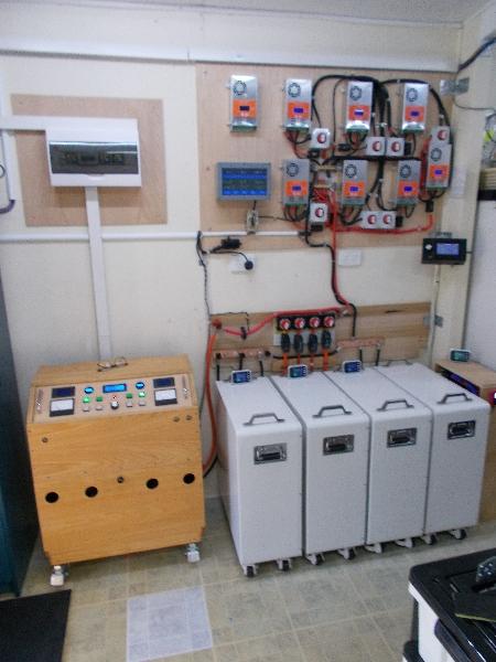

After battery Box upgrades, and making new copper plate BUS bars for the new layout, I finally rewired and refitted some existing 0 gauge and new 00 gauge wiring, it was easy to redo everything while still staying 100% off grid.
The black-box mid screen and to the right, is a Touch screen BMS setting Controller and Monitor, it selects any of the battery BMS units, and also selects any of the Battery balance modules in the battery units, and allows setup and adjustment to them as well.
As the shed is lined and insulated, it does not get below 14°C overnight in winter and is air conditioned in summer, remaining below 29°C, air-Con sometimes runs all night, as does one or two of the units in the house.
FULL electric home and big machinery in the workshop, SOC is never below 50% except with extended periods of black overcast weather. Mains has been off for over two years now, the only thing connected to mains is 16 year old solar in-feed unit, that is until the rebates finish or it claps out, I think rebates will finish first, then a new solar array of panels will replace the old in-feed array and connect into the existing off-grid setup via another solar regulator or two. You can guess what will happen when that is finished shh!
For now, no E-bills, always in credit, even after transferring most of the ever increasing credit out every 3 quarters or so. I know I sound like a broken record, and here is a another broken track, the WG Inverter is a Beast.

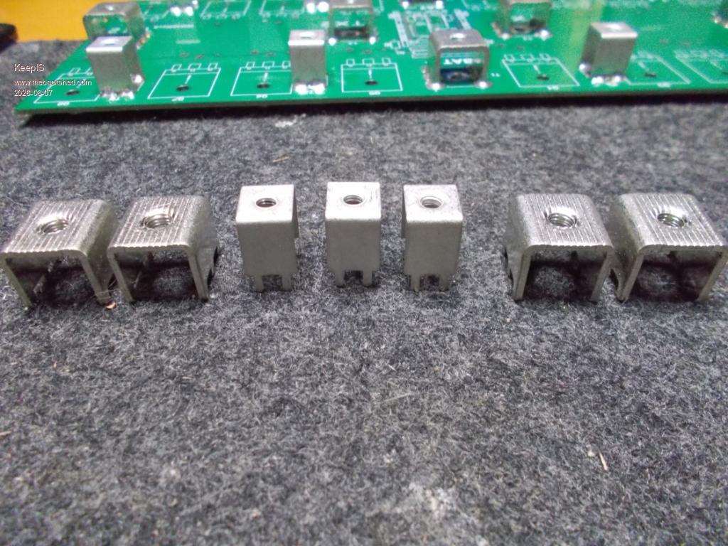

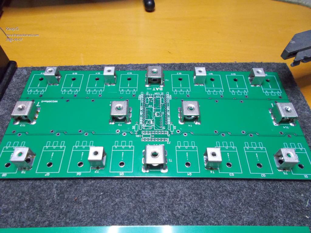

The purpose of the following posts is to give new, and non tec builders, a feel for the construction process, making it as simple as possible with no fancy jigs and equipment, something to contemplate while you await you PCB's and parts.
Far more detail will be available in the future if you are unsure of anything pleas ask, If I can't answer it, I'll say so, and I'm sure someone on the forum can and will.

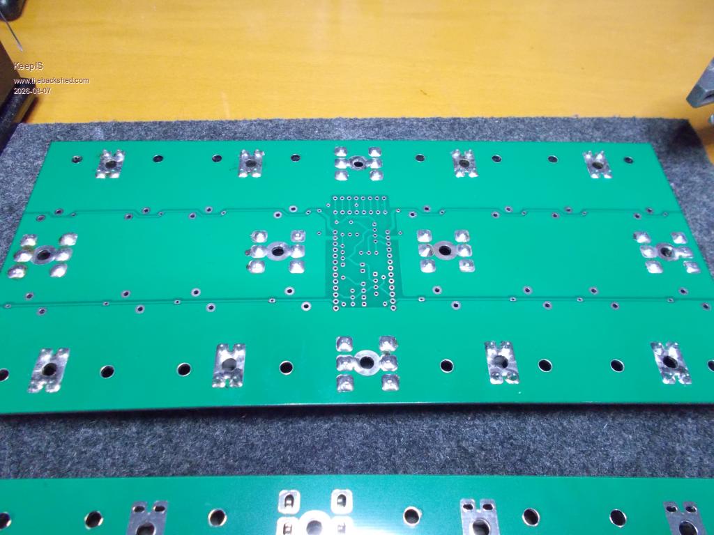

For now, IMHO, the place to start the build is with the Power Board, and that starts with the terminals. The Power T1, T2 and Choke TX1 TX2 terminals are lower in height compared to the cap boards terminals, and must be fitted first. The pix below shows the power terminals (outside) and choke terminals in the centre.
These terminals need to mount flat against the PCB, this is especially critical with the Capacitor board terminals, if these are not level the holes in the cap boards will be out of aliment, more importantly, the cap boards will not sit flat against the terminal faces, the boards will flex as the screws are tightened and the CAP PCB to Terminal mating surface can be compromised.
Before I get told a hundred better ways to do this, remember, this is aimed at someone that does not have a workshop full of gear, this is SIMPLE and it works.

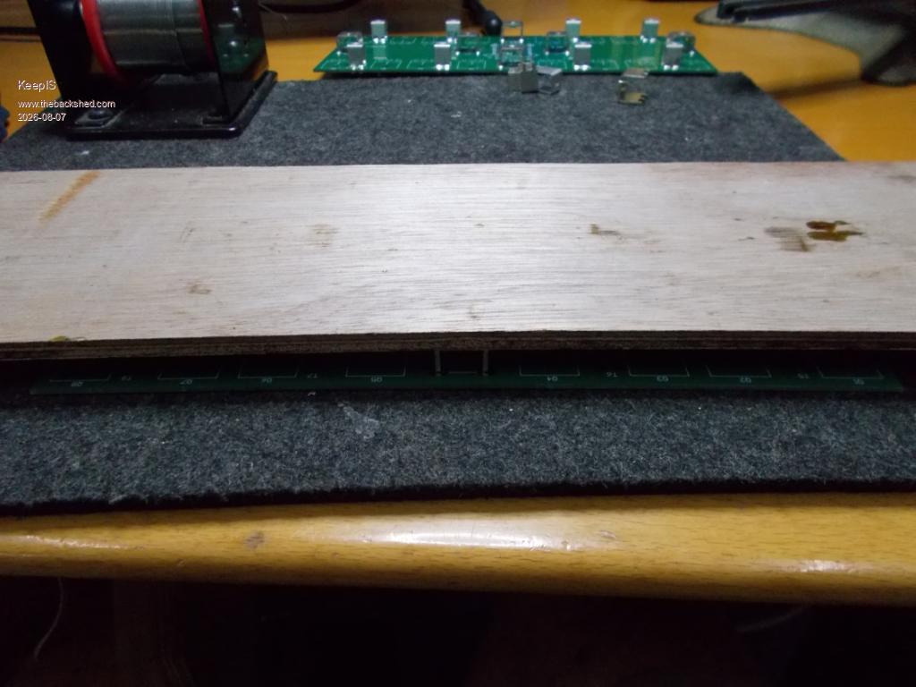

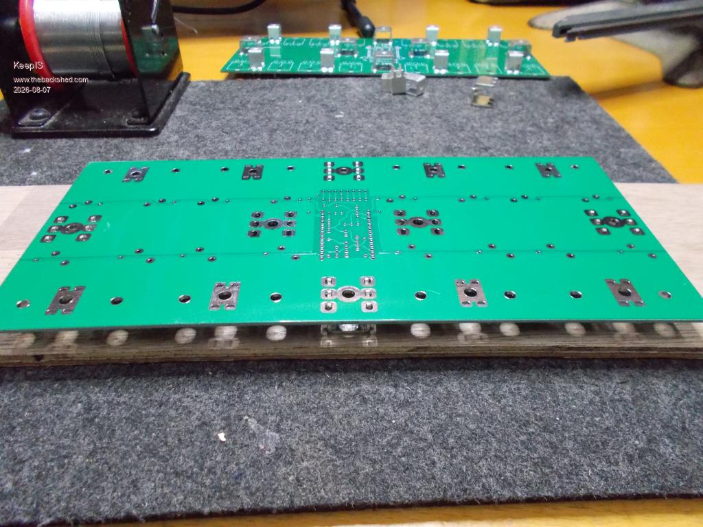

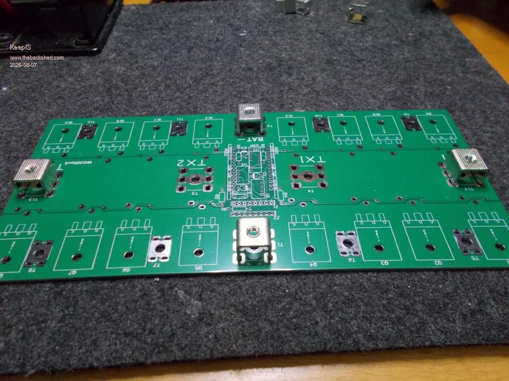

Get a piece of timber 6mm or 7mm ply is good, and slightly larger than the power board, place the power board on a smooth surface and insert the four large terminal, or 6 terminals if you are not sure which choke terminals inner(T3, T4) or outer (T13, T14) that you intend to use.
Place the ply board over the top of the terminals, hold the board and ply together and turn the board over. When soldering the terminals, once the PCB and terminal has heated to where you are flowing solder into one of the the terminal pins, use a small square of timber (the board is hot) to press down on the PCB next to the terminal you are soldering, and before you lift the iron from the PCB/Terminal.
The PCB can also flex and pull slightly away from the terminal, this stops that happening, you repeat this for the next pin on the terminal. This way, the terminals always mount perfectly flat and parallel to the PCB.
Normally I would solder one terminal and then lift the board, the other terminals fall out, and you finish solder the other side of the terminal pins while the PCB and terminal is hot in that location, then repeat the sequence for each terminal.
The reason we fit 4 or 6 terminals each time is obviously to ensure the PCB sits flat against all the terminals as each one is fitted. Especially the CAP board terminals!!!

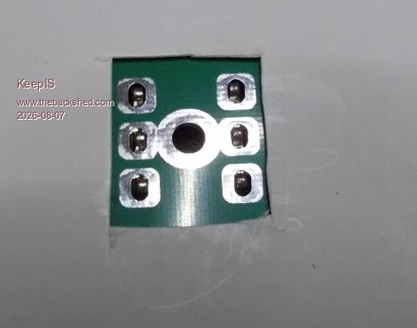

Don't be fooled by the optical illusion, the rear terminal is FLAT.
I'm using a 70 Watt soldering iron set around 470°c with the appropriate tip, soldering, solder flux, tip tinner and other soldering aids will be discussed in later post.
Please don't post your pictures of an old copper block iron heated with a blow torch or furnace. New builders don't have that and this is not a car body repair intro.

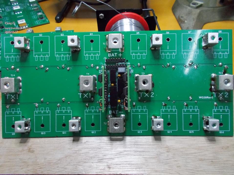

Forgot to add the solder splatter mask, a bit of thin cardboard with a hole slightly bigger than the terminal solder base, as high heat is used, it's hard to stop resin splatter etc from sticking to the surrounding PCB surface, this shield makes cleaning so much easier, and in some cases, with a bit of care, results in no cleanup at all.
Don't really need a pix but what the hell.

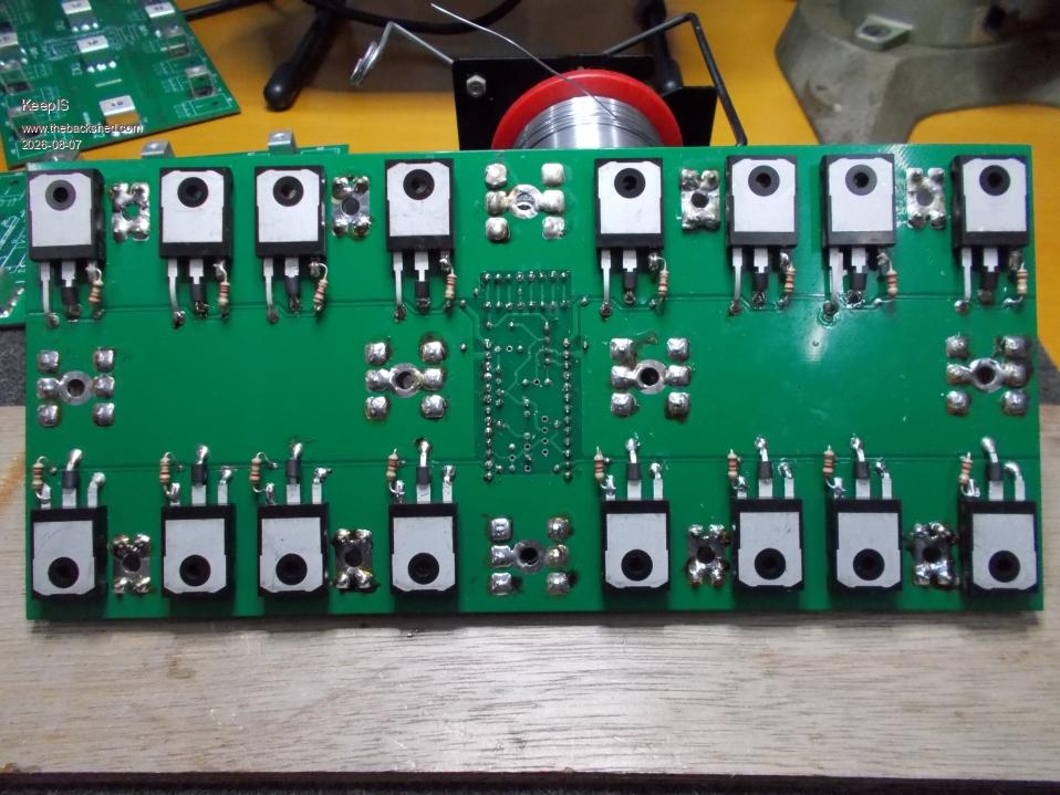

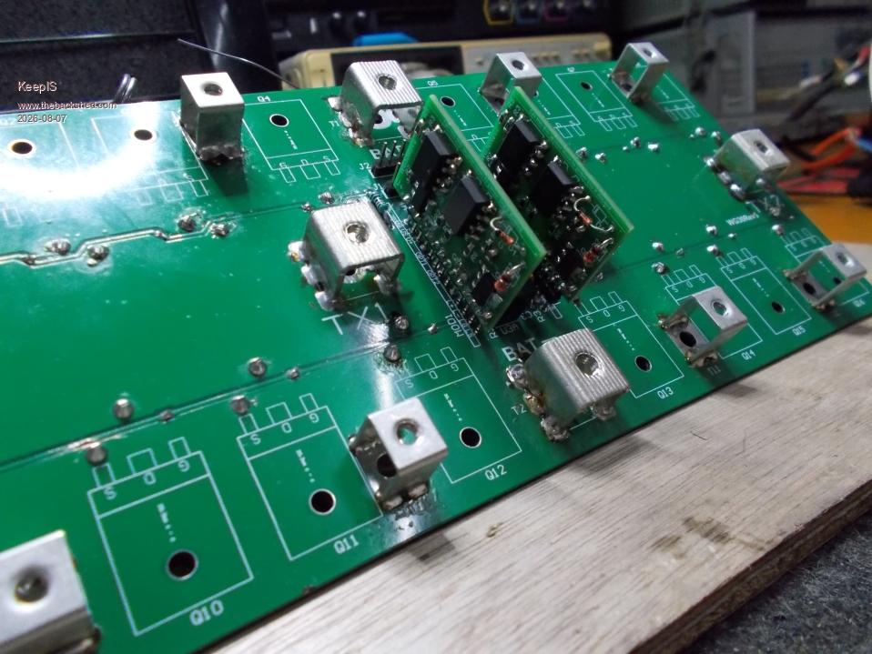

This is the first Power board I built the other day, wanted to test everything before building the next two in Ernest, the test unit is a bit rough, but it gives an idea of what a finished power board looks like, and best of all, it works.
The FETS are installed 4 at a time, using a bolt head and nut with a normal locating insulating washer under the bolt and nut, then snug the FET to the board, this ensures perfect alignment of the mounting hole in the FET and Power board.
To follow, close up pix of the Gate Drive board, obviously two are used in each power board, going to call it a day for now though.
I also have thoughts for a simple jig with a socket to plug each Gate drive PCB into, that way you can test each Gate Drive board BEFORE soldering them into the Power board.

70 watt temp controlled 480°, around 10 seconds to flow, you always solder the underside first, minimising heat transfer through the FET leads by heating the PCB first, before sliding the tip against the FET lead and allowing the solder to flow through, flip the board and heat the PCB next to the lead, solder melts quickly, minimising heat flow through the FET lead, have done this for every inverter board I have built.
Footnote added 2026-08-08 16:20 by KeepIS
"you always solder the underside first" is WRONG
SHOULD read always solder the TOP side (component and Terminal side) of the PCB first. when soldering the FETS.

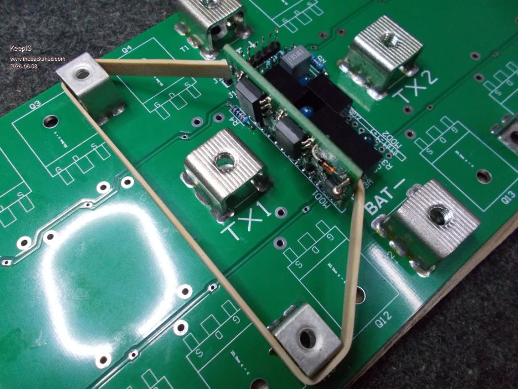

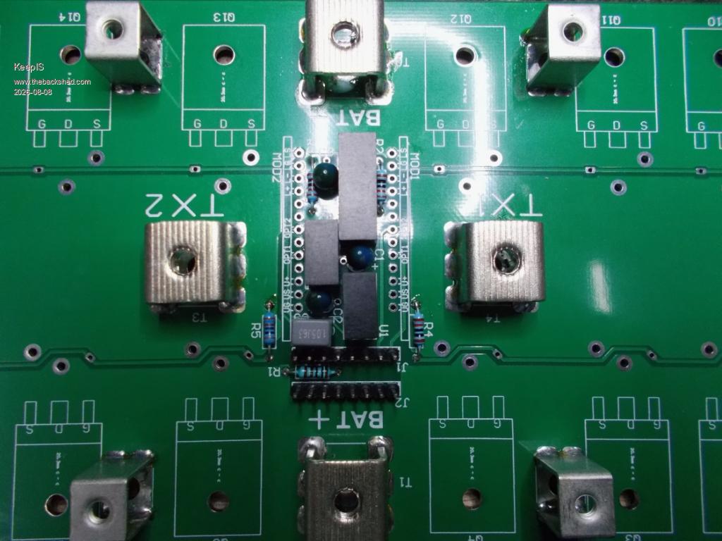

When building the power board, after fitting the terminals, fit the three DC-DC modules, the four 10k gate resistors, three Tantalum caps, the 1uf and 1k resistor, and J1 socket to plug it into the Controller, in other words all the power board components apart from the FETS, power board itself is so easy now.
I simply put one Gate Drive PCB into the empty holes where they will later solder into, make sure to orientate the board the correct way, and gently lean it back in the holes, you could use a rubber band to hold it back so the pins make contact, while you test it.
Power the Controller with LCD connected with 13V, which is enough to get the Ctrl 12V regulator to regulate.
You can now measure the DC-DC supply outputs, the neg bias voltage, and put a DSO on the output of two OPTOs, on the one I just tried, the waveforms and voltages look perfect.

Thanks for you test method, similar to what I used to do, and along the same lines that phil also suggested, builders can make a choice as to which they go.
I can say though, that the cap boards on the 3 power boards I just built, line up close to perfectly, and the screws drop straight into the threads, and they are absolutely level.
I'll post the simple Drive PCB test method I mentioned earlier, as it works perfectly, however as mentioned, it would be nice to have a little test board made up so Drive boards can be built independently of the power board.
It only needs one half of the power board interface components to test both boards independently, but if your going to the trouble it might work out better having both boards plug into the fixture at the same time? I'll leave that one up to you if you plan on making a Gerber.
Yes, even with a pump driven solder sucker it might be a little difficult.
I mount the Drive boards with only the tip of the pins projecting through the Power board, that allows me to EASILY cut all the pins and later remove them one by one from the Power board, IMHO it's not worth trying to save the drive board if it's found to be faulty or damaged, easier to fit a new one.
KeepIS
Joined: 13/10/2014
Posts: 2284
Posted: 04:17am 08 Aug 2026
This works faultlessly, you really can't hurt the board as the supply is isolated, and fed from the Controller via the ribbon cable as it normally would be.
I just tested the second drive board and it is also perfect.

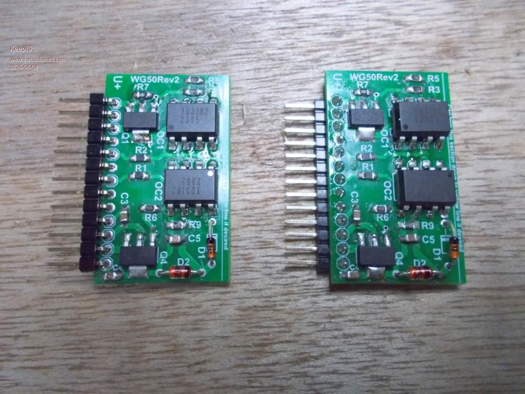

Below: Power board interface components for the Gate Drive boards fitted.
Below: One of the boards  ready for testing.
Below: The two identical Gate Drive boards.
The only difference is in the side that the right angle connector is fitted to.
Both boards have the U+ writing closest to the BAT+ terminal.
If you look about 7 posts back you will see the two mounted on the first Test Power board. You might also notice that the pins of the right angle connectors are exposed, they can be be easily snipped and the Drive board removed, allowing you to remove the cut pins from the power board, one at a time, to save the power board from damage should you ever need to replace a Gate Drive PCB.
