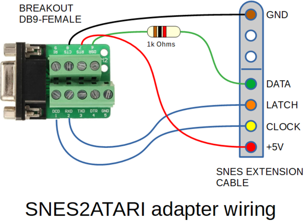

I found this Site SNES2Atari
Connection looks like on the Game Board so I will test it

Hi Martin,
I've not had my coffee this morning and thus may have my eyes in the wrong way round, but that diagram looks like complete twaddle.
I suggest looking at the schematic for the PicoGAME VGA since that is what you are connecting to:
   https://github.com/thwill1000/pico-game-vga/blob/main/hardware/v2.0/Circuit.pdf
On the DB9:
   Pin 2 = Data
   Pin 3 = Latch
   Pin 4 = Clock
   Pin 6 = +3v3
   Pin 8 = GND
EDIT: From your link:
The SNES2Atari is an adapter that allows you to connect an SNES controller to the Atari 7800 console, Atari 2600 console, the Atari 8-bit computer line, and likely many other platforms that have a DB9 joystick port and can use Atari joysticks. Games must be specifically coded to use the SNES controller.
I think that the underlined sentence means that they just "made sh*t up" whereas the port on the PicoGAME VGA  conforms to that used by "standard clone" controllers.
EDIT 2: Some correct third-party documentation:
   https://www.nesdev.org/wiki/Controller_port_pinout
Edited 2023-11-29 20:18 by thwill

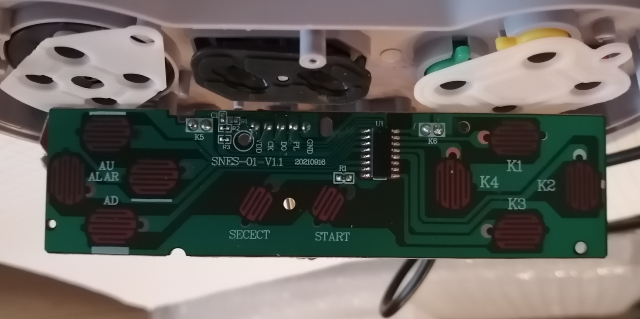

And if you would pop it open and post a photo that would be great, I'm curious if it is one of those with a micro controller in it (in which case 3v3 probably insufficient), or a "proper" shift-register based one (in which case I am hopeful for 3v3).

  thwill said
  Volhout said  @Martin,
Try running the SNES from 3.3V also. Maybe that works and avoids the level shifting.
As you can see, there are no keys in parallel here, so I assume a full assignment
However, that was the last time I unscrewed it just to take pictures of it. That is all too fragile and if I can't get it back together, then I'll have to wait another 2 weeks   for a replacement. Even it was from Amazone this time
Edited 2023-11-29 21:00 by Martin H.
'no comment
Posted: 11:01am 29 Nov 2023
  Martin H. said  However, that was the last time I unscrewed it just to take pictures of it. That is all too fragile and if I can't get it back together, then I'll wait 2 weeks again for a replacement
If you've broken it beyond repair on my request then let me know and I'll PayPal you the funds.
That looks like one of the ones I have, based on an unlabeled micro-controller; that 16 pin IC doesn't have enough pins to be the minimum 12-bit shift-register required for a "proper" SNES gamepad.
Edited 2023-11-29 21:47 by thwill
