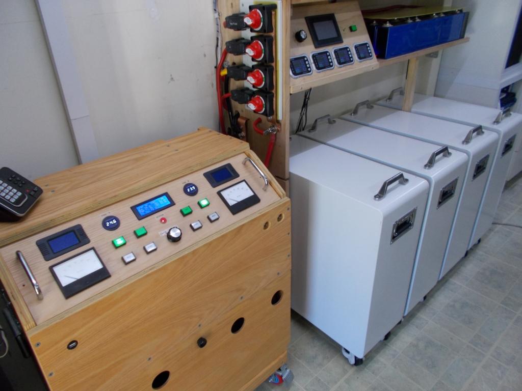

  KeepIS said  These boxes weigh 23kG empty, the weight is 120kg with the 16 cells.
That sounds like pretty beefy boxes.  Can you share some pictures?

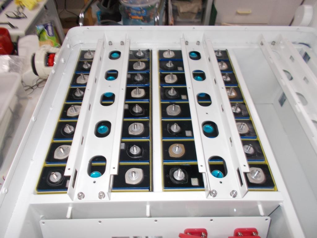

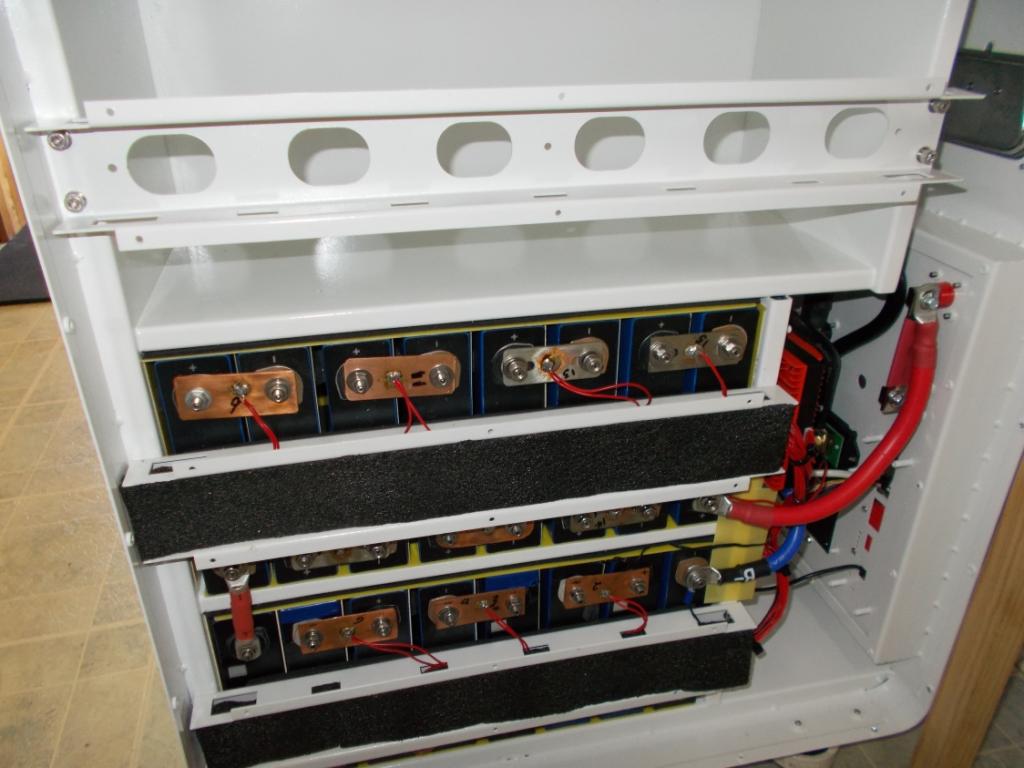

KeepIS
Joined: 13/10/2014
Posts: 2284
Posted: 02:20am 01 Jun 2026
These boxes take 280AH to 380AH cells, mine are 180AH. They are designed to fit 5 cells in shelf 1 and shelf 2, and 6 cells in shelf 3.
My cells are same width and height but not as thick, so 8 cells fitted perfectly in each of the bottom two shelves with all fibreglass separators and supplied dense foam strips installed. This allows me to upgrade to higher capacity cells if necessary.

  KeepIS said  These boxes take 280AH to 380AH cells, mine are 180AH. They are designed to fit 5 cells in shelf 1 and shelf 2, and 6 cells in shelf 3.
The boxes look nice and sturdy.  I wonder how air tight they are.  The empty shelf looks like a good place for small igniters using spark plugs to mitigate explosion risks?  They would probably need to be powered by a small external 12V AGM? battery in open air.
I am also curious what your plan is in the case you see fire starting. I imagine you would disconnect the battery banks via switches.  But would they be wheeled outside?

My discharge and charge currents are very - very - conservative, there is no way for a cell to overcharge with enough current to cause a vent leak. That is "usually" the way these large LiFePO4 cells will leak potentially flammable gas.
The cabinets are ventilated, not sealed. The cells run stone cold in this system.
There is separate full monitoring of each 52.3V bank for charge and discharge currents.
The charge and discharge currents are compared across the 4 battery banks, any delta variation is flagged and alarmed. You can not a have a cell in a bank start to fail without it changing the charge / discharge currents.
And yes they are all independently switched, fused, and can be moved outside in seconds for any reason if needed. There is constant cross ventilation at ground level in this area of the shed, including stand alone solar ventilators above.
I should make it clear that each bank obviously has a BMS, with a separate switched main large touch screen display to select any BMS for quick status info of the 16 cells in each bank, there is also a separate Cell Balancer in each Bank, these are also selected from the main LCD and are used to confirm the cell status, and any cell unbalance in any Bank is indicated via a prominent flashing LED.

Those Battery boxes look really good, and quite practical too. `
