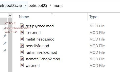

petsciisfx.mod is there, I even included the non-sfx version of get_psyched.mod.

The metal_heads.mod is the same from pet24 and pet23 series.
In the "larger file size" mod files ZIP there was a different metal_heads.
This one:
metal_heads-sfx.zip
Maybe that is the one you need? But it has not been used before. We can add it..
P.S. tried the above mod, and it works.

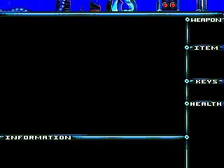

Just tested Pet25 on the Gamemite
Error : Not enough memory
> [1664] Play modfile "music/sfcmetallicbop2.mod"   'sfx combined with music
> memory
Program:
 55K (41%) Program (2100 lines)
  1K ( 0%) 1 Embedded Fonts
 76K (59%) Free
Saved Variables:
 16K (100%) Free
RAM:
 26K (15%) 97 Variables
 90K (56%) General
 44K (29%) Free
> option list
PicoMite MMBasic Version 5.07.08RC19
OPTION SYSTEM SPI GP6,GP3,GP4
OPTION AUTORUN  1
OPTION CPUSPEED  252000 'KHz
OPTION DISPLAY 28, 80
OPTION LCDPANEL ILI9341, RLANDSCAPE,GP2,GP1,GP0
OPTION TOUCH GP5,GP7
GUI CALIBRATE 0, 368, 294, 882, 666
OPTION SDCARD GP22
OPTION AUDIO GP20,GP21', ON PWM CHANNEL 2
OPTION MODBUFF ENABLE
maybe the additional sprit for the banner is to much
Edited 2023-11-25 00:34 by Martin H.

  Martin H. said  Just tested Pet25 on the Gamemite
[/Code]
yes .. on Game Mite "Rem" out those two lines
first at the start of the Program:
'write frame around playfield
 FRAMEBUFFER Write sc$
 Load image "images/layerb.bmp"  'the actual frame
'----THIS LINE:
 'sprite write #1,0,0 'top of screen showing robot eyes
 If Game_Mite Then FRAMEBUFFER Merge 9
and at the end of the Start menu:
   Pause 50: 'Contr_input$() is to fast to see what position you are in
 Play stop
 'save image "images\strip.bmp",0,85,320,16
'----THIS LINE:
' sprite read #1,0,85,320,16
if you still want the Banner above, use this bmp
layer_b.zip
Edited 2023-11-25 01:11 by Martin H.

Posts: 6199
Posted: 03:12pm 24 Nov 2023
Hi Martin,
Thanks for debugging...
The charm was that the banner changed automatically with difficulty level. There are other ways to fix this if we want, I know. The banner is 320x16=5k pixels = 5kbyte at 1 char per pixel, or 2.5kbyte at 4bpp.
This means that RAM is (very) critical at the Game*Mite. Note that there where only 97 variables when Game Mite ran out of memory. In VGA when running there are 141 variables.
Edited 2023-11-25 01:14 by Volhout

Posted: 03:30pm 24 Nov 2023
  Volhout said  Hi Martin,
maybe the lowervariables are couse it happend right at the start of the game ..
I am not sure, if the Sprites at the LCD Version uses 4 or 24Bit per Pixel , than the Banner uses 320x16x24 Bytes.
Peter can definitely answer the question
If you want to change the banner during Levels, you can still use the previous method of simply reloading them.
Edited 2023-11-25 01:32 by Martin H.
