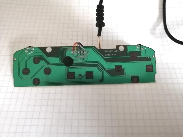

  thwill said
Oh dear .
Yes, I wrote code that will read a "proper" SNES controller,
Most likely the one pictured has NES internals and the extra buttons either duplicate A&B or use an oscillator to provide "autofire" A&B.
Hi Tom, you are right, it is just NES, but was immediately recognized as an NES controller.
even those two "Shoulder Buttons are copy of A and B..
You wanted to see what's inside:
but the controller felt good in the hand, and if I manage to get it back together, I'll use it anyway
SNES Clone with SNES Connector ist ordered
Edited 2023-11-20 22:48 by Martin H.

Posted: 12:43pm 20 Nov 2023
Thanks, how are the shoulder buttons mounted, on right-angle tac-switches or with little bits of PCB ?
  MartinH said  SNES Clone with SNES Connector ist ordered
As I said earlier there is no guarantee there either. I have some of those and they have a 5V micro-controller inside them instead of the expected shift-register(s). You'd need a level-shifter for them to work.
