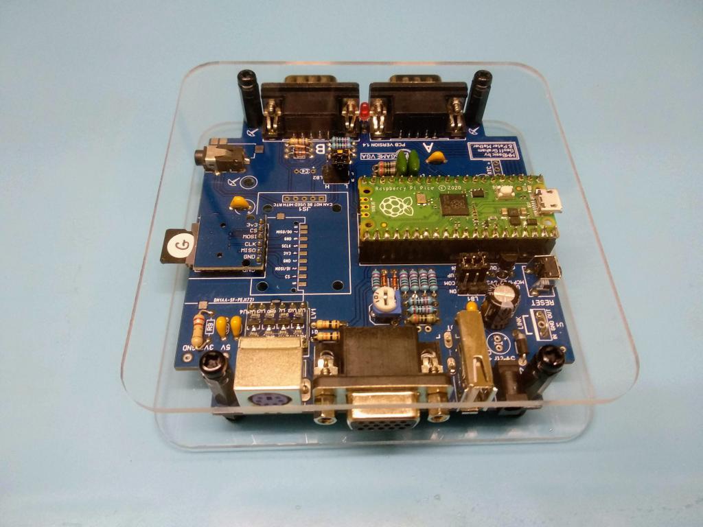

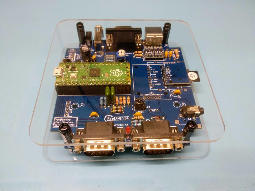

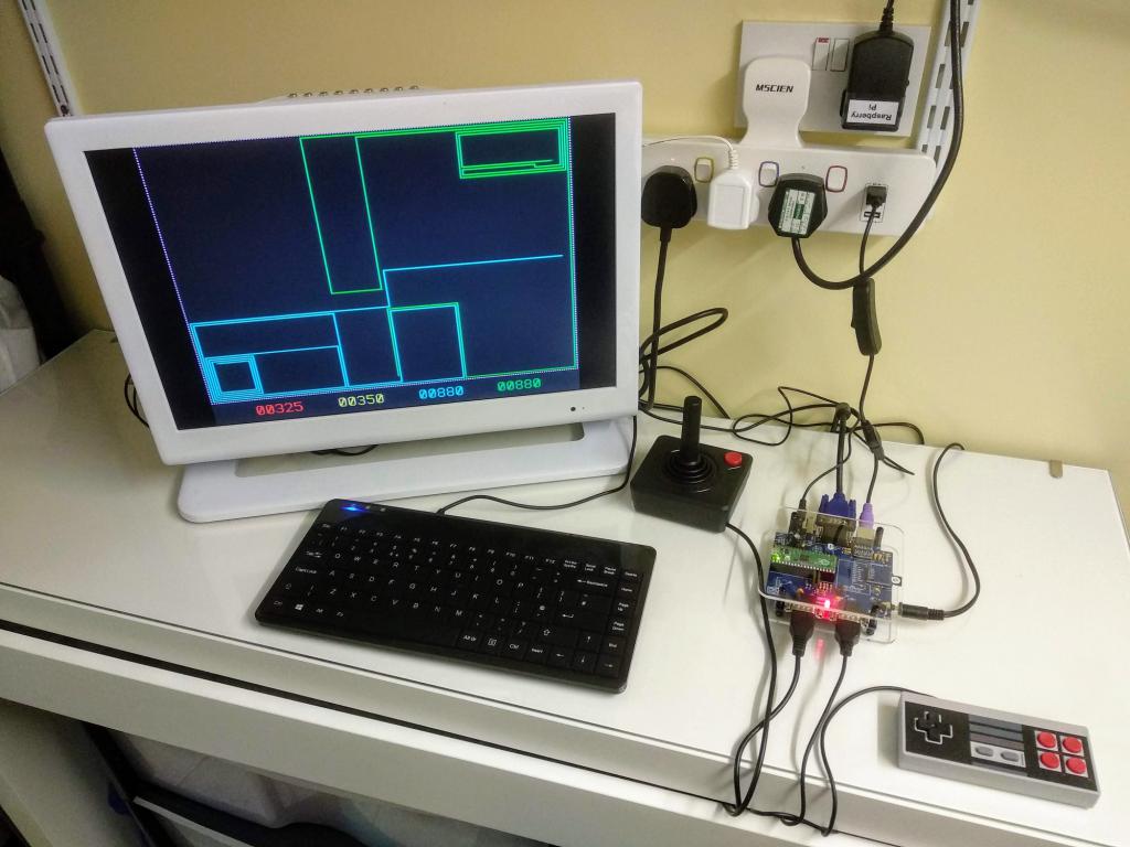

PicoGAME VGA 1.4 (by @Mixtel90) in acrylic enclosure (by @bigmik):
My thanks to both Mick's, I am very pleased.

I haven't looked into this PCB. What is the USB connection between the VGA connector and the power jack?

5V out, specifically to provide power to a VGA => HDMI adapter ... or charge your mobile phone.
I believe on the 1.4 board it can be hacked to provide an alternate power in too (by convention the adjacent power jack is used), but I don't think that is so easy/possible on the 2.0 board (still unconstructed).

That's very smart, Tom. :) Upgradable to suit the latest versions too!
@Lizby
It's 5VDC power out. It comes from the primary regulator (if fitted) so you could, for example, power the board from 12V and get 5V for a VGA to HDMI converter. Alternatively, if you have a suitably rated supply going in you *may* be able to charge a phone from it. There's a slight voltage drop from 5V input caused by the diode though.

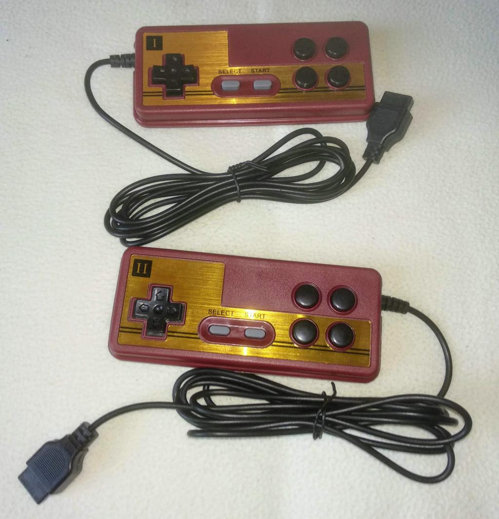

Due to other responsibilities I'm largely on a break from the Shed at the moment but I did have a chance to test another pair of "NES/Famiclone" gamepads that dropped through the door:
These seem usable if you can put up with the gold and maroon colour-scheme. They still exhibit the "Right = 129 if you don't send an extra clock-pulse" issue that seems common to all (?) the modern clones (which is easily worked around in software, just send the extra pulse) but most importantly they do not have wonky D-pads.
Internally they are the usual epoxy blob and nothing else, though for variety they have a white blob, at least the one I opened did.
The listing I ordered from was:
   https://www.aliexpress.com/item/32803427153.html
But caveat emptor.

Love that 70's retro colour scheme.... :)
