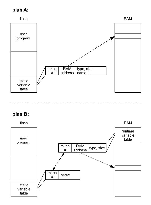

<snip> translate variable names into 'dynamic tokens'
and I wouldn't be afraid to use long names
major re-write I am guessing ... but ... if it happens, maybe consider 16 bit string lengths too? Possibly these are beyond scope for the smaller uMsEdited by CaptainBoing 2017-07-06

  robert.rozee said  ... translate variable names into 'dynamic tokens'...
That is a brilliant idea and would result in a huge speed improvement. I will investigate.
Posted: 02:50am 05 Jul 2017
would be something for geoff to comment upon, but in principal converting to 16-bit tokens might not be as hard as it first seems. it would require that the tokenizer identify and turn all variable names into tokens when saving from the editor, and maintain a table in flash to enable converting from tokens back to names when editing a program. this would require extra code.
but then the interpreter would no longer need to be able to handle variable names, which would reduce the required code, perhaps by about the same amount as the tokenizer grew.
there would also be a bit of complexity about where to stash the name/token table. the obvious place would be at the top of free flash, where the library currently resides.
there may also be the opportunity to make all variables 'static' in RAM, as in the memory address for each variable being defined before the basic program even starts running. this would remove the need for any heap manager. and one could add a LIST VAR command that would list all the variables used in a program (and possibly their address in RAM), allowing easy identification of mis-spelled variable names - a long standing bugbear of basic.
note: this is a very pie-in-the-sky idea. there may be very good reasons why it would not work at all!

The main issue will be in accurately recognising variable names while the tokeniser is doing its job - a lot of things could confuse it. If that can be done the rest would be easy.
The other issue is that whenever I make a change it creates bugs - so expect plenty of bugs.

I have just thought of one issue... what happens when you CLEAR or ERASE variables - damn!

  Geoffg said   I have just thought of one issue... what happens when you CLEAR or ERASE variables - damn!
because variables would be pre-allocated, CLEAR would need to just set all floats and integers to zero, and all strings to "" (their initial states). ERASE would do the same to a subset of variables.
the only complexity would arise with something like this:
10 DIM A(10)
20 ERASE A
30 DIM A(20)
it would be necessary to somehow raise an error for line 30 when saving the program, doing so at runtime would make little sense. the error message might be something like "Duplicate variable name at line...".
local variables could be handled by recording their name as subname.varname, however enforcing local variables being inaccessible from outside the subroutine in which they were declared may be difficult.
thinking more on the matter, i could see this being - for the moment - an experimental branch in the language. a bit like python 2 and 3. if the changes proved worthwhile and the incompatibilities overcome, then later on the branch could be moved back into the main line.
rob :-)

further thought has produced a solution that would seem to keep everyone happy and allow 100% compatibility with CLEAR and ERASE. see the below diagram:
"plan A" is what i had originally envisioned, where the entire variable table is contained in flash and constructed upon exiting the editor (or completing 'autosave'). the (static) variable table would contain entries of variable length, but because the length of each entry would be known it could still be searched relatively quickly for a given token. since all variables would be 'static' there would be no need for complex heap management.
the downside is that mmbasic would handle variables in a substantially different fashion, amongst other things no longer allowing re-dimensioning of arrays.
"plan B" involves splitting the variable table into TWO tables, one static (in flash) the other created at runtime in RAM just as the existing variable table currently is.
the static variable table (SVT) would just contain 16-bit token numbers (in sequence starting at, say, 64000) and variable-length variable names. it would exist solely for the purposes of 1. reconstructing the original source code when detokenizing before invoking the editor, and 2. converting tokens back into names for printing out error messages.
one key piece of information derived from the SVT would be used at runtime: the total number of tokens.
upon starting a BASIC program, a runtime variable table (RVT) would be created. the RVT would differ from a conventional BASIC variable table in a couple of key ways: each entry would be of a fixed length, and, the number of entries would be known beforehand (so the RVT would not need to be able to grow/shrink).
there would be no need to search the RVT, instead the base token number (64000) + fixed entry size could be used to index into it - strictly speaking the RVT would not even need to hold the actual token numbers. prior to being first accessed or declared, the RAM address associated with a given token/variable would be nil, and after being CLEARed or ERASEd would be set back to nil.
while the RVT would be of fixed size, heap management would still be required to allocate and recover the RAM used to hold each variable's content.
geoff, peter: does this sound more workable?
rob :-)Edited by robert.rozee 2017-07-08

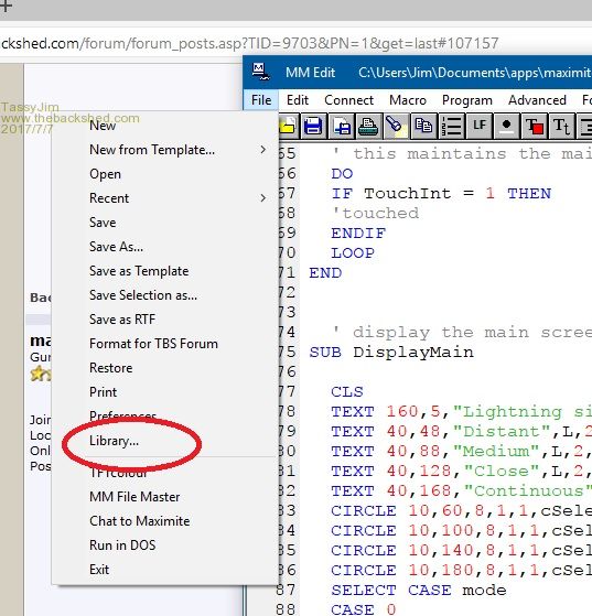

If this could be incorporated into something like MMEdit this could be hugely powerful - imagine a drop down list of library routines that you select from and that automatically then get loaded using the Micromite LIBARY command and where the calling sequence is documented and available in a panel on the IDE.
The step up in real user productivity would be enormous, far greater than a modest speed improvement achieved by internal tinkering which in any event can always be solved by the next faster chip.

  matherp said
If this could be incorporated into something like MMEdit this could be hugely powerful - imagine a drop down list of library routines that you select from and that automatically then get loaded....
It comes close...
Just needs people add routines and keep them updated.
