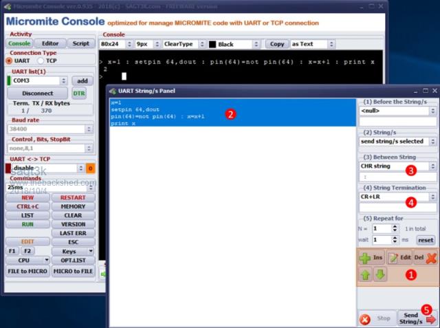

Hi to Everybody
I announce a new version 0.935 of MicromiteConsole:
- resolution of some bugs
- better strings management
Here a example:
In this example, You can insert strings(1), select one or more strings(2), choose what to send between strings(3),what to send to the end of the list(4),and finally send(5)
Here the link for download v.09.35
Every comment and / or suggestion is appreciated
Antonio

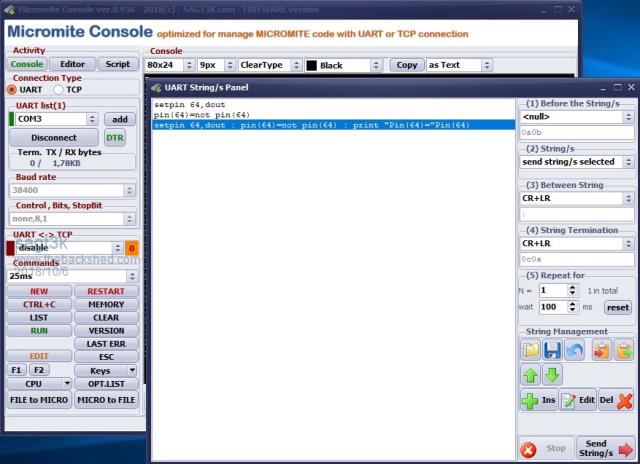

Hi to Everybody
I announce a new version 0.936 of MicromiteConsole:
strings management:
+ added buttons for load and save to file
+ added buttons for import and save to clipboard
+ added undo button
+ possibility to delete multi selected strings
Here the link for download v.0.936
Antonio Edited by sagt3k 2018-10-07

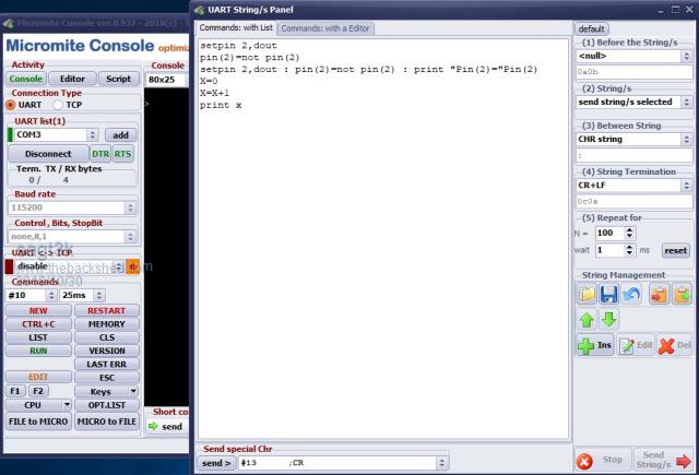

Hi to Everybody
I announce a new version 0.937 of MicromiteConsole:
strings commands management:
+ added "Send special car" in "UART String/s Panel"
+ added button "Default setting" in "UART String/s Panel"
+ now, in "UART String/s Panel" you can manage the commands
list with a mini memo editor
Here the link for download v.0.937
Antonio

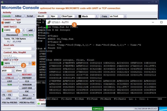

Hi to Everybody
In "Editor" sheet, added in Find/Replace button :
- now it's possibile to find or replace string/s
In "Editor" sheet, added in Tools button :
- Insert/Delete comments on selected rows
- Add/Delete indentetion on selected rows
- Change color Editor (for the moment w/b or b/w)
Add action from keyboard:
- "F3" for find string
- "CTRL+Z" for "UNDO" action
Here the link for download v.0.938
I remind you, that it's possible to bring the open COMx port into TCP/PORT and then use other VT100 sw, like PUTTY, to manage in TCP the micro/mmbasic
AntonioEdited by sagt3k 2018-11-02

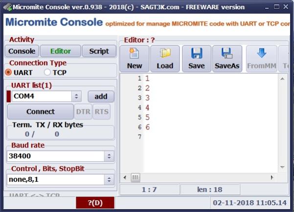

Hi Antonio,
Thanks for the new additions to your program.
There is a problem with Ins/Del Comment in that both when highlighting then Ins Comment, the trailing CR (or LF) is deleted.
The same goes for Del Comment.
To demonstrate, create a file like this
1
2
3
4
5
6

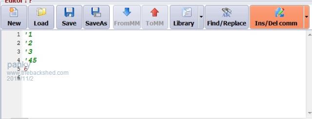

If you now highlight 1 through 4 and click on Ins Comment, you end up with the following
'1
'2
'3
'45
6
If you now highlight from start through to the 6 and click on Del Comment,
1
2
3
456
panky

Hi panky
I can not reproduce the problem. However, I use to isolate the lines by finding the sequence CR+LF.
I tried both on Win7/10, I think the problem can happen if you load the non-windows file, then imported from Linux.
Now I check this possibility.
Antonio

Hi Antonio,
  Quote  There is a problem with Ins/Del Comment in that both when highlighting then Ins Comment, the trailing CR (or LF) is deleted.
It depends on how you do the selection. If you select down to the start of the next line after the text you want to select, for example
.. here I have entered six lines of text
.. if I now highlight lines 1 through 4, you will see that when I click on insert comment below,
.. the trailing CR/LF after the number 4 is also deleted.
Although it is functionally correct as in the example above, I have in fact highlighted the inviseble CR/LF after the number 4 (at the end of this line), this is not usually what happens in other text editors.
For example, if I do the same here in the Backshed edit window
1
2
3
4
5
6
then highlight 2 through 4, leaving the cursor at the start of the line with 5 and press Delete, then the result is
1
5
6
It is easy to work around by ensuring that when you highlight a section of code, you leave the cursor at the end of the last character in the line before the (hidden) CR/LF. It is just that this is different to all other editor I am familiar with.
Thank,
panky.
sagt3k
Joined: 01/02/2015
Location: Italy
Posts: 313
Posted: 07:03am 02 Nov 2018
Hi panky
Thanks , I solved this issue.
I'm doing other checks and will publish the new version soon.
Antonio
