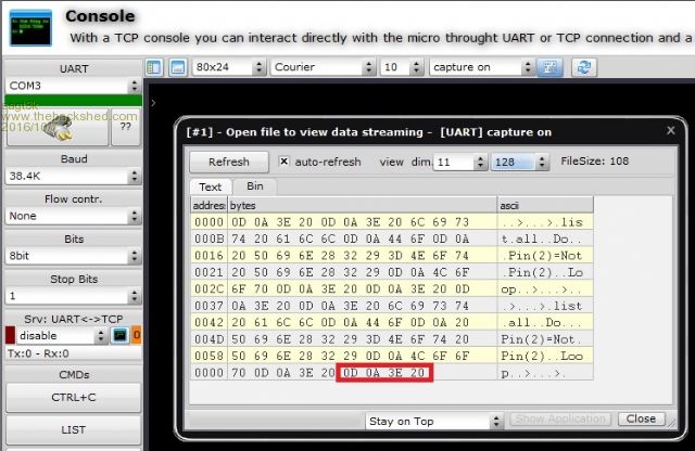

Matherp... anyway, In form console there is a combobox "capture/log off". If you choose "capture on" and after goto in BIN sheet and check "auto-refresh" we can see what happen.
Posted: 12:11am 07 Oct 2016
  Quote   check "auto-refresh" we can see what happen
I can't find an auto-refresh checkbox - which page is it on?

Hi Matherp
I confirm that to send/receive the code, first send 0x03 and later 0x0D 0x0A, and wait after 0x0D 0x0A 0x3E 0x20 as in image ...

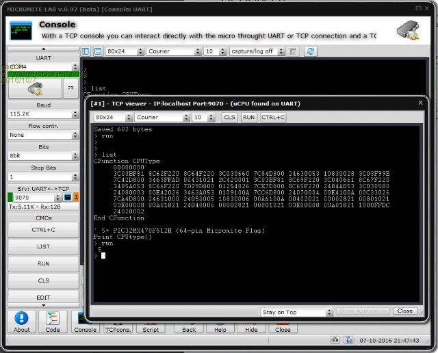

Posted: 08:52am 07 Oct 2016
Everything works in the console window: memory, list etc.
The problem is that nothing works in the code window - I just get the "not connected" error

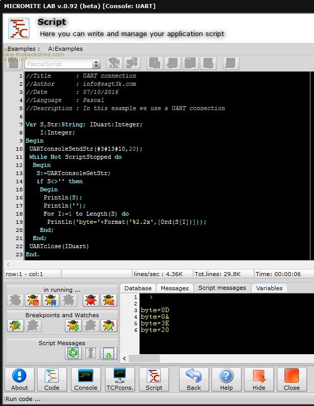

... or we can do this test. Just get connected CONSOLE (with green light) and try this script...
...Go on SCRIPT to create a new one
, choose PascalScript and
...write the code ...and start the code
after goto to the SHEET script messages ...
Here the code .. and the image of SCRIPT module ...
Var S,Str:String; IDuart:Integer;
I:Integer;
Begin
UARTconsoleSendStr(#3#13#10,20);
While Not ScriptStopped do
Begin
S:=UARTconsoleGetStr;
if S<>'' then
Begin
Println(S);
Println('');
For I:=1 to Length(S) do
Println('byte='+Format('%2.2x',[Ord(S)]));
End;
End;
UARTclose(IDuart)
End.

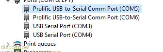

I have narrowed it down to my Prolific USB to serial adapter.
These don't work with W10 unless you go back to and older Win7 driver. I have been using them OK with everything else but MicroMiteLab wont load code with them.
The FTDI USB adapter works OK with MicroMiteLab.

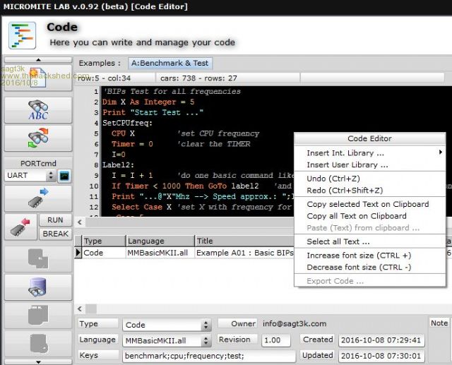

Then there would be a problem to import or export code. I have planned for the application an internal database. In fact if you go to see there is a ".usr" file that keeps everything inside. The application is designed for portable use. The code could retrieve it from outside through copy / paste. But I planned to export with "export code" as external file or that as soon as I put on the Cloud Service.
The encrypted files maintains a paternity, It maintains, what kind of code is which platform is designed etc. Type the example I posted on the site. The Cloud and the services (will be free) and I am putting on a sort of "dweet.io", "mySQL free" and other services that will dialogue with the application. After the project will extend to other platforms including Mac, iOS and Android.

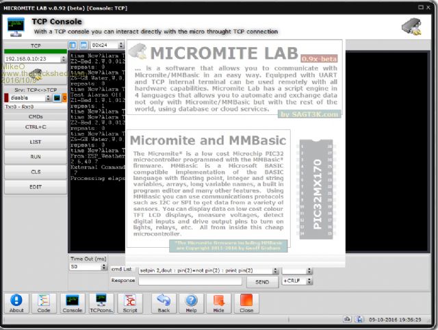

Posted: 10:51pm 08 Oct 2016
I had this "bad behavior" experience when starting up. This information page didn't close and remained as the top of the application, in fact on top of any application I opened even the browser and the backshed page I started to write this report. I could not close the Microlab application normally i had to use the task manager.
I am using Windows 10.

@Gerry and all Prolific users:
Did you tried this Family Software Driver?
This driver worked for my Win10 computer...
Frank

Posted: 12:59pm 09 Oct 2016
Hi Frank,
I have this downgraded driver installed, it works for other things, but MicroMiteLab wont load code using it, but console is good, same situation as reported by Peter but not sure if he has ProLific drivers or not.
Thanks for the link, it is a bit simpler than the path I initially took to get the downloaded driver to stick.
